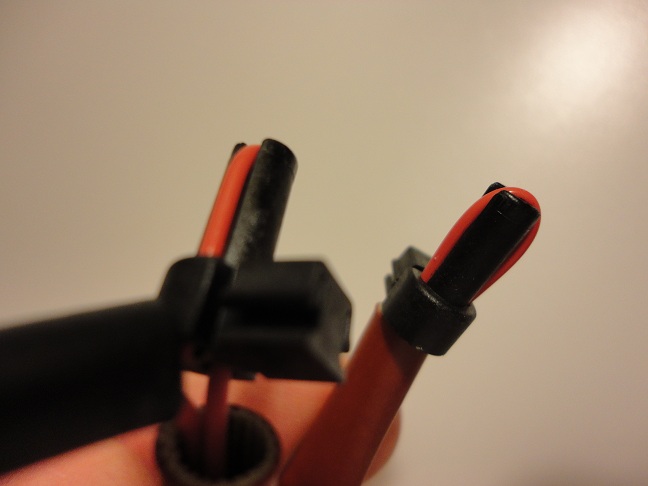

I agree with everything else you are saying but all the sensors I have used on my three Boxsters are destroyed when it goes off. It is an 'active' system and when the sensor is worn it breaks the circuit.
Here is one that monitors both pads on one caliper:

gnat has a brilliant futuregnat has a brilliant futuregnat has a brilliant futuregnat has a brilliant futuregnat has a brilliant futuregnat has a brilliant futuregnat has a brilliant futuregnat has a brilliant futuregnat has a brilliant futuregnat has a brilliant futuregnat has a brilliant future
Ahh. Thanks for the updated info. The 996 and BMW sensors (haven't needed brakes on the P!g yet) I'm used apparently work a bit different as they appear to use a range finder of some sort.
Still, they are cheap and not worth "saving"
