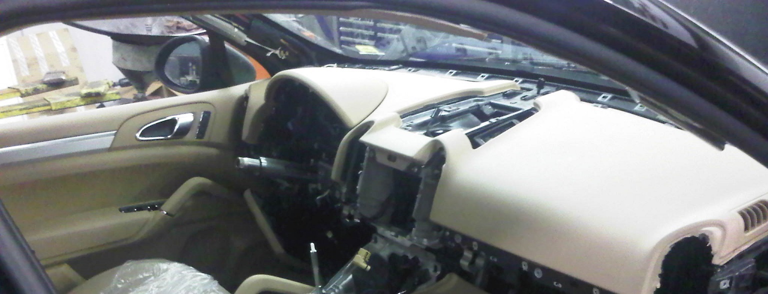

I apologize if your Airbag logo got damaged. That's how I remember them coming out, but it may be an Audi Q7 quirk that I'm remembering. The last 958 that I took pillars out of was a few years ago. The pillars had to come out before the dash could be removed.

There has to be a story for that pic!

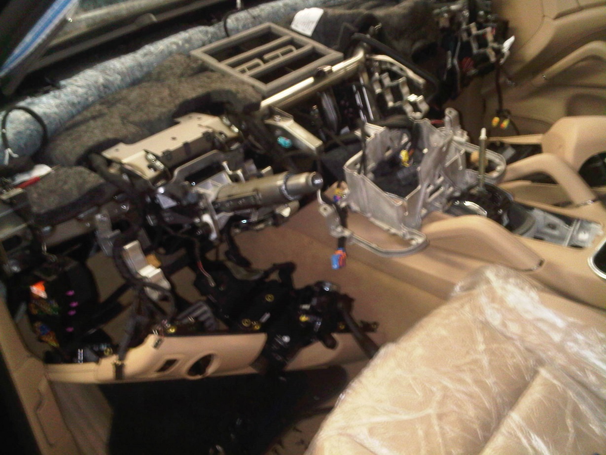

Oh it gets worse. There was a noise in the defroster vents and after tearing everything apart we found out it was just bad programming causing the defrost vent flaps to open at an angle that made a whistle while driving. Porsche sent over a flash to correct it.

Wow. Hopefully it didn't add any rattles or squeaks that such disassembly often does. I thought mine having it's outside stripped off was bad, but that would have made me sick to look at

wow, like gnat said, I do hope there's no loose panels or broken clips associated with all that disassembly, and all that for a whistling noise

No squeaks or rattles. We did end up replacing a couple of pieces that got scratched in the process, but it was perfect when done.
