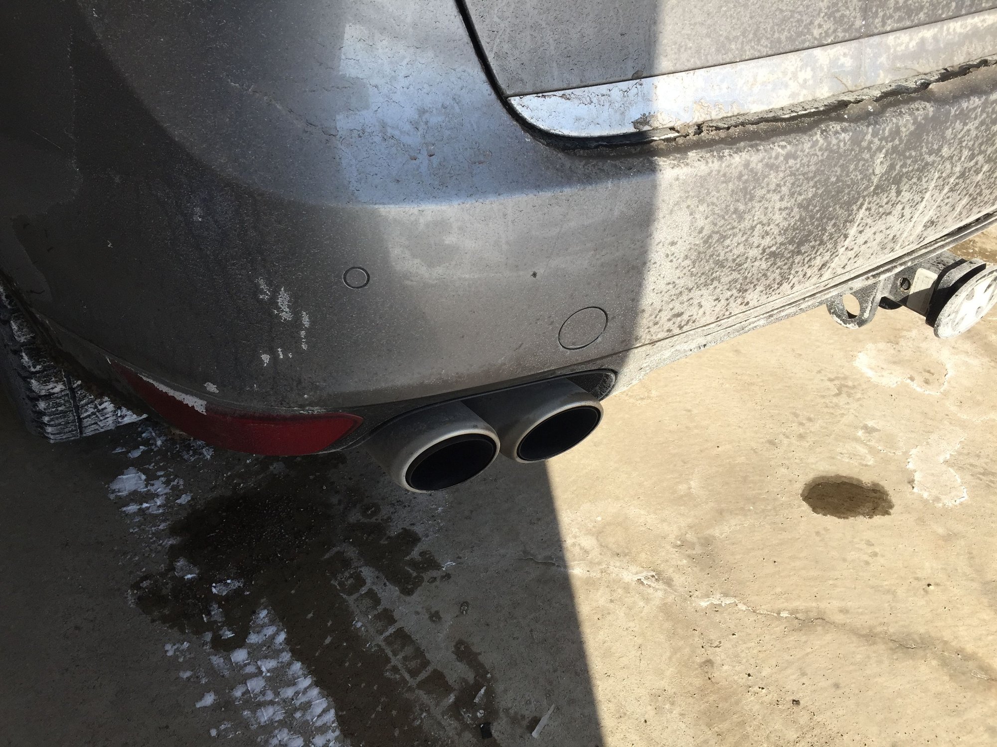

My stock CTT exhaust tips have significantly degraded over the years.
I attempted to polish... but they were too degraded.
Due to this, i had a few options....
1) Buy new replacement or aftermarket

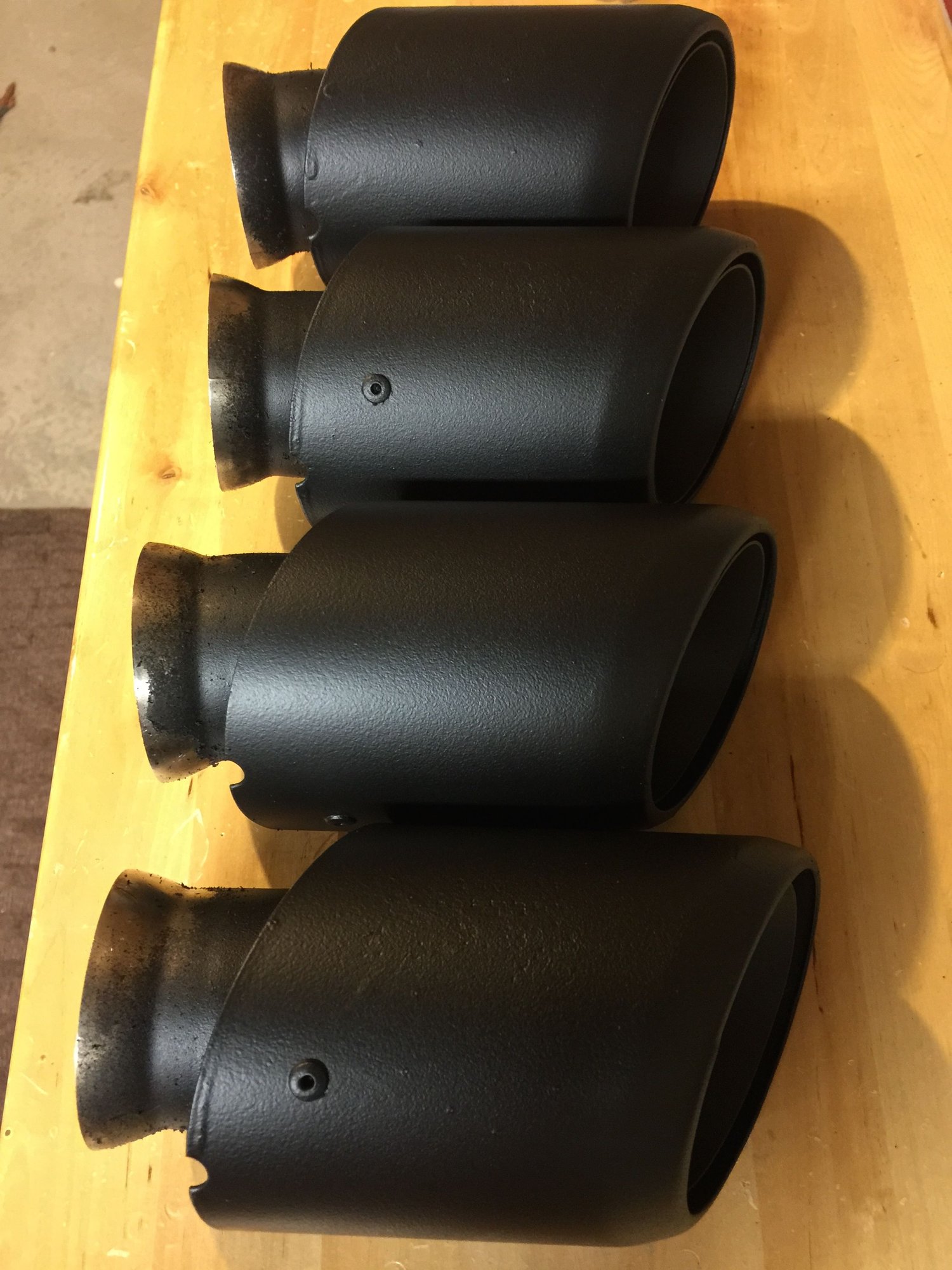

2) Refurb mine in black Plasti Dip (black rubber type spray paint) - recommended by 6speed member, Harlequin
Below will detail my DIY as it was simple, rewarding and cheap!
Pardon my dirty ride....winter sucks and i didn't have time to detail it first

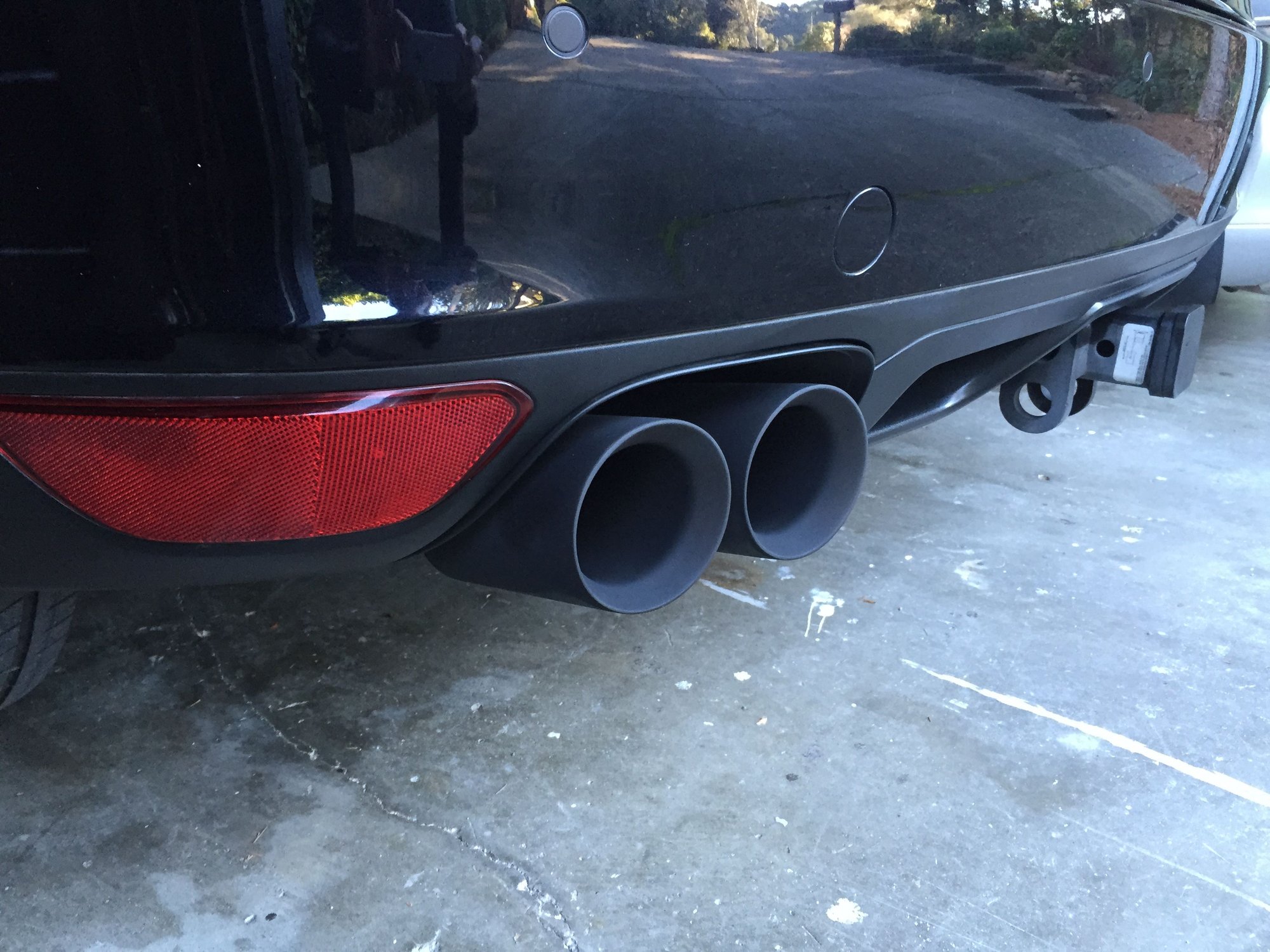

If you like black tips (such as the GTS), you can spend $1000 for the OEM, or you can go the black Plasti Dip route.
This is the easiest, cheapest mod you can do....trust me
The paint cost $6 at Home Depot.

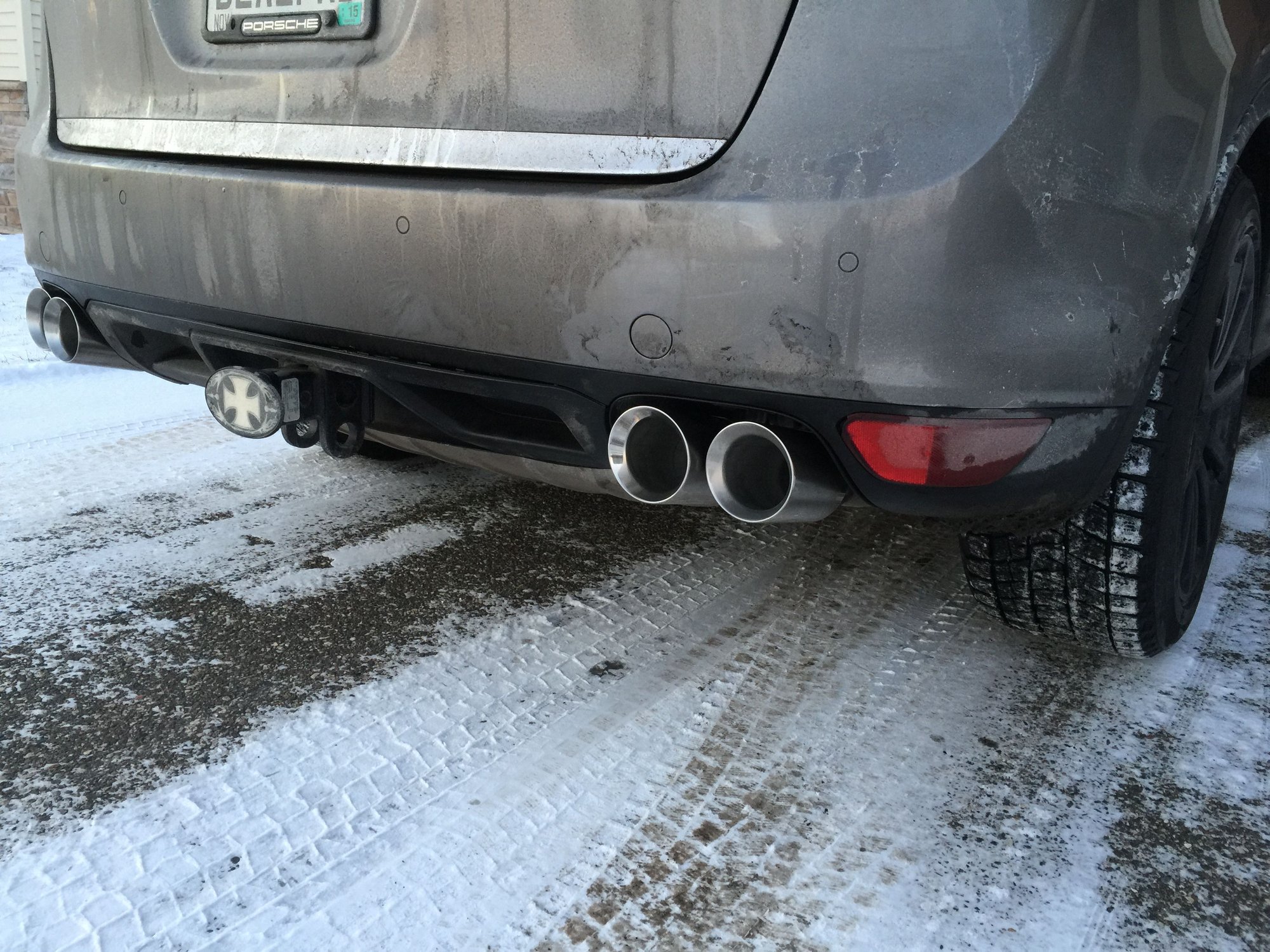

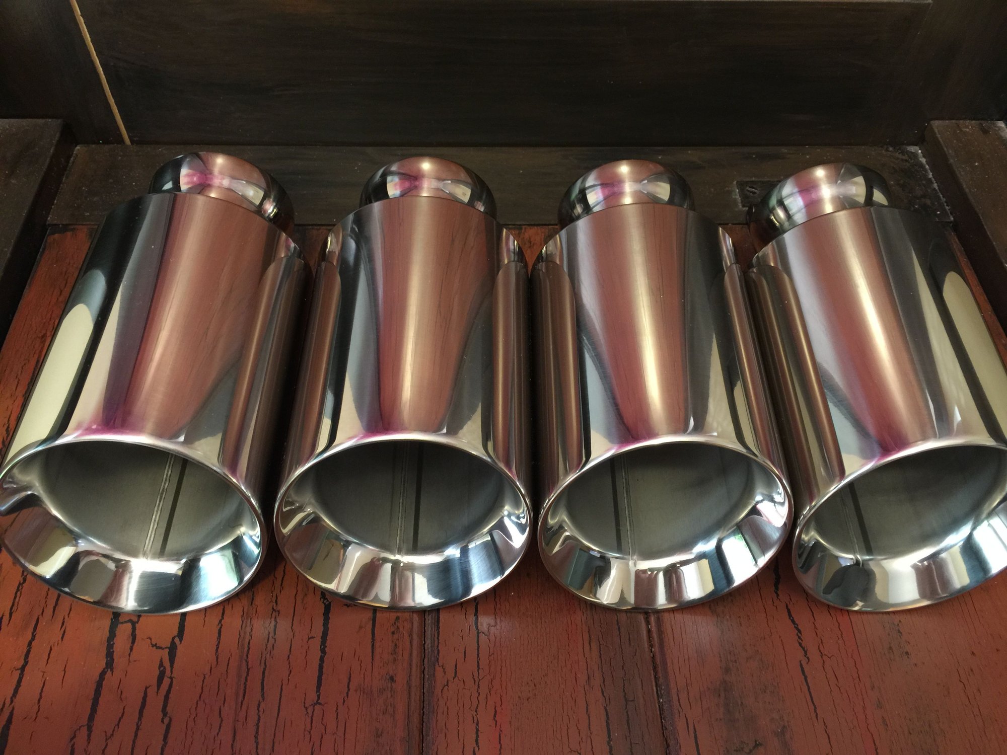

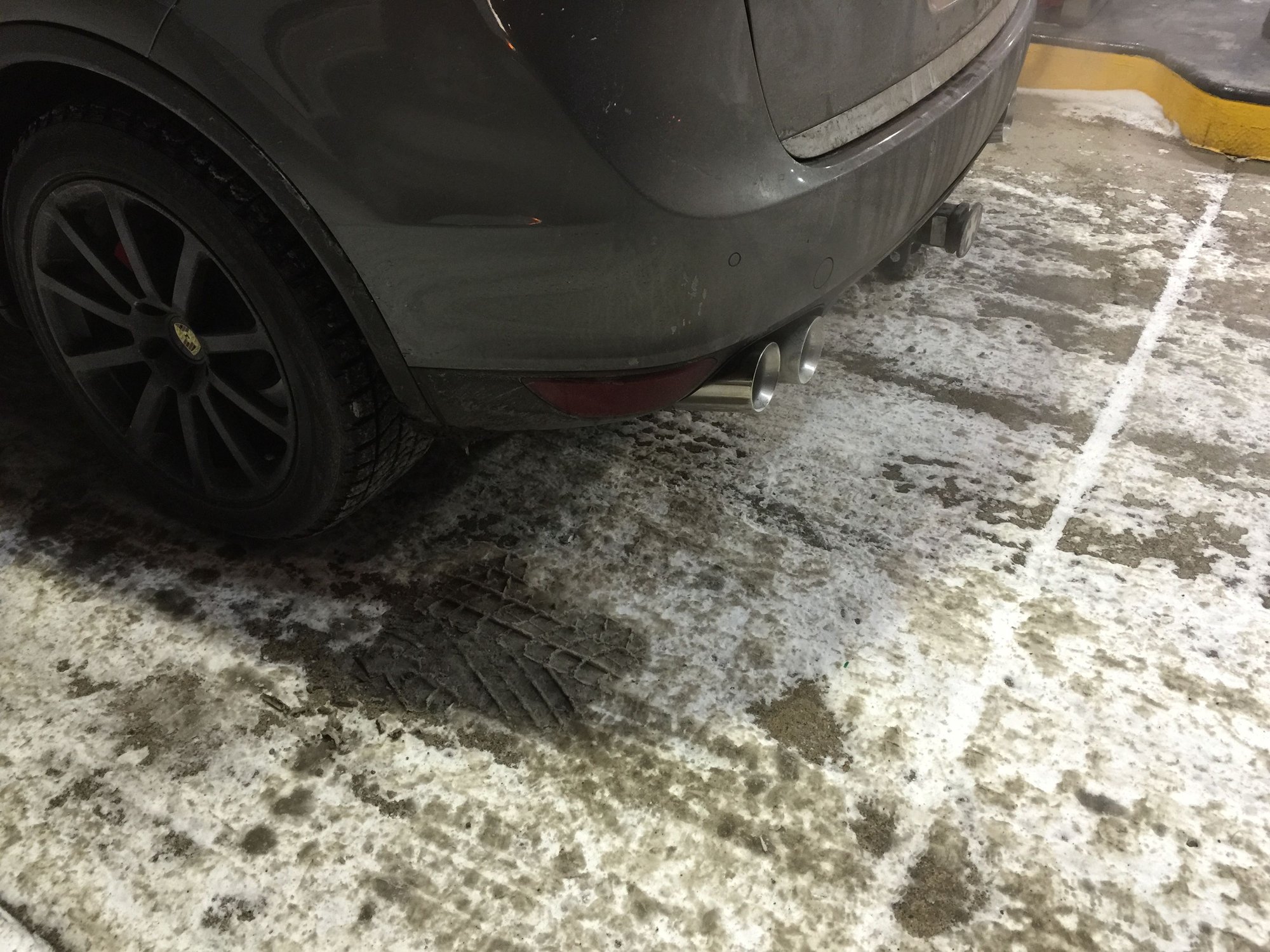

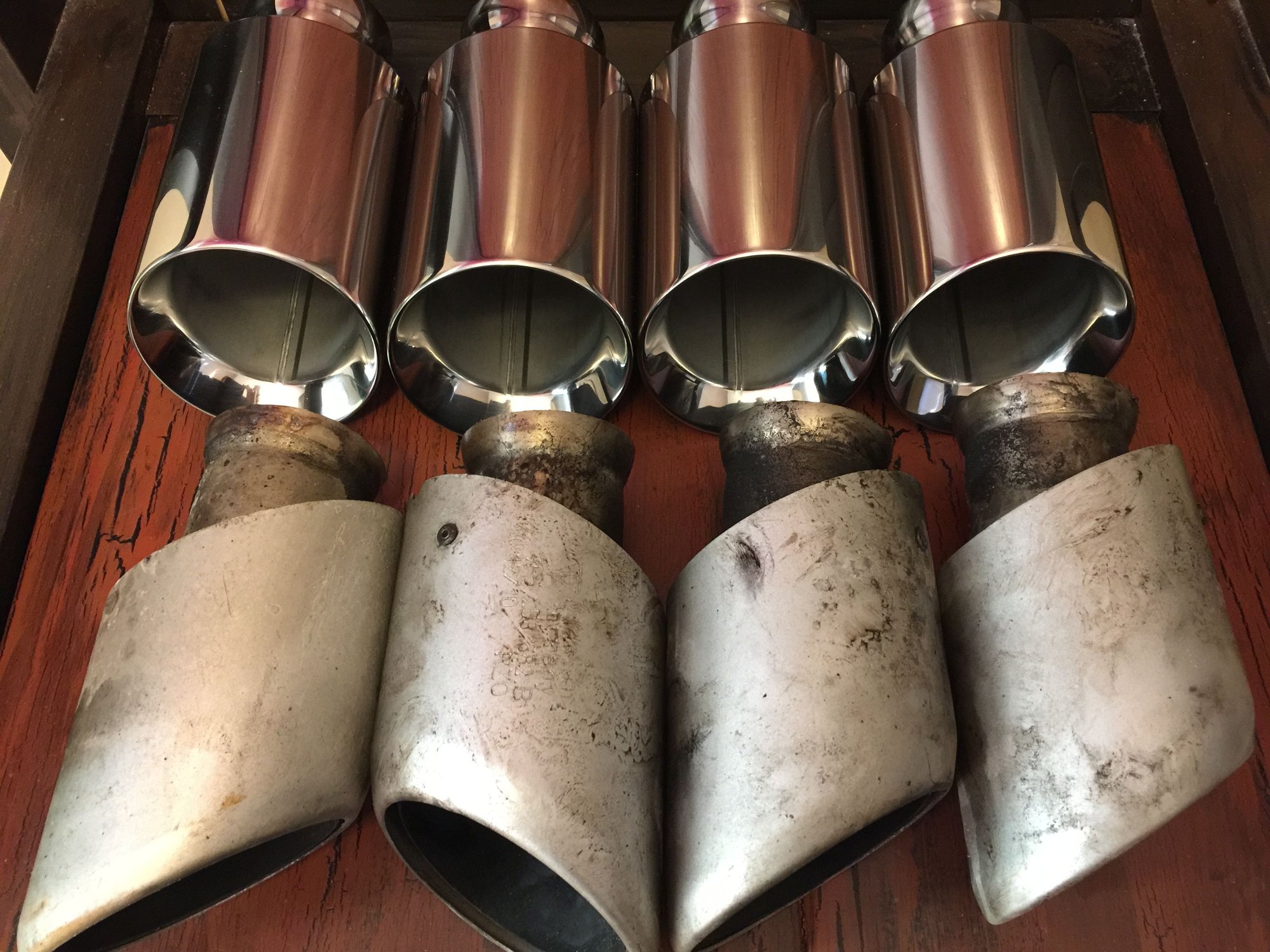

New Fabspeed exhaust tips in chrome
Old stock tips on passenger side....notice the faded color around the tip edges.
Drivers side stock exhaust tips
Misleading picture since the stock tips are dirty but man....the Fabspeed tips look amazing!!!
Exhaust tips removed awaiting new ones...
Again, it would have been a lot easier to do this in the summer

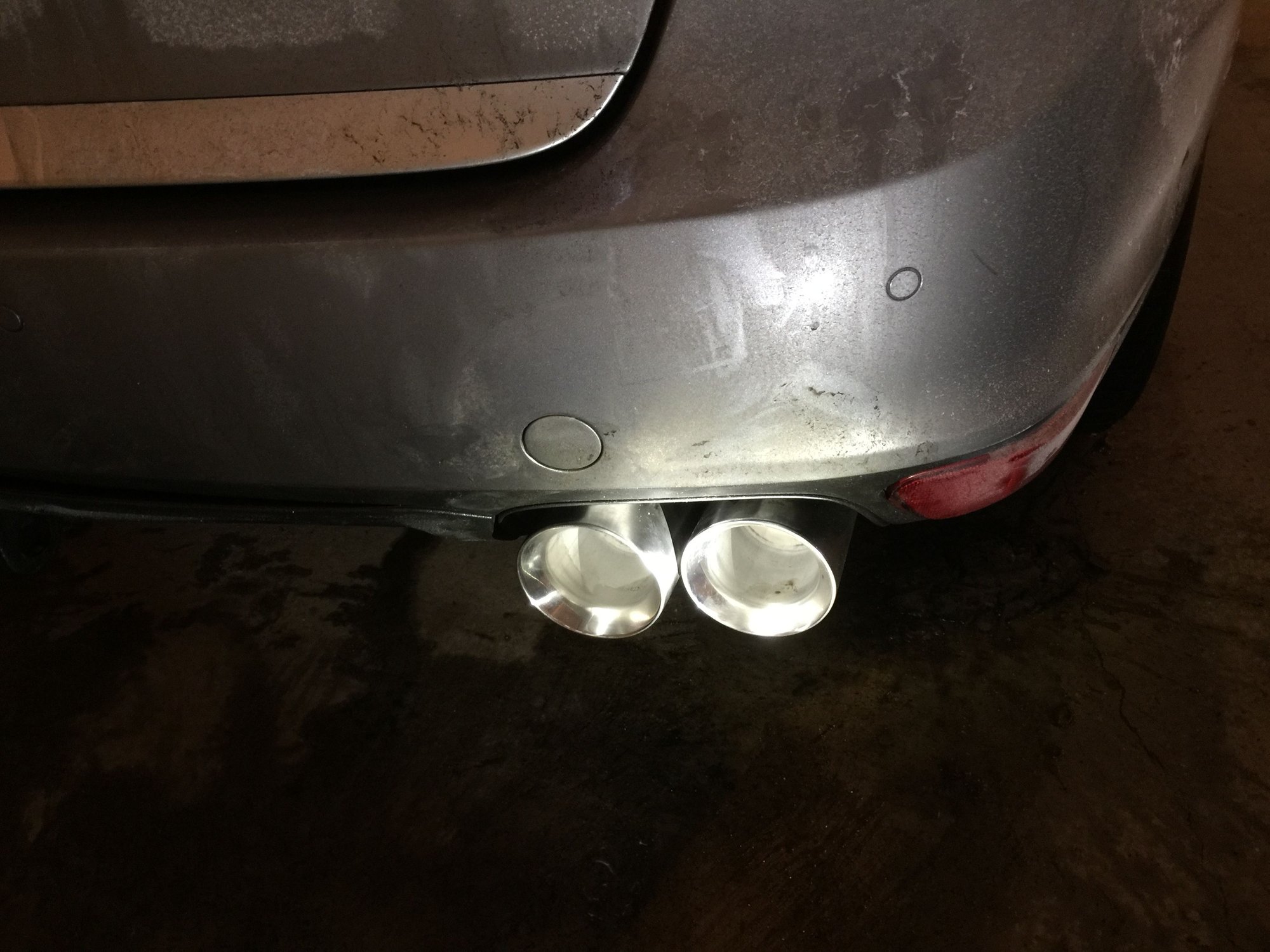

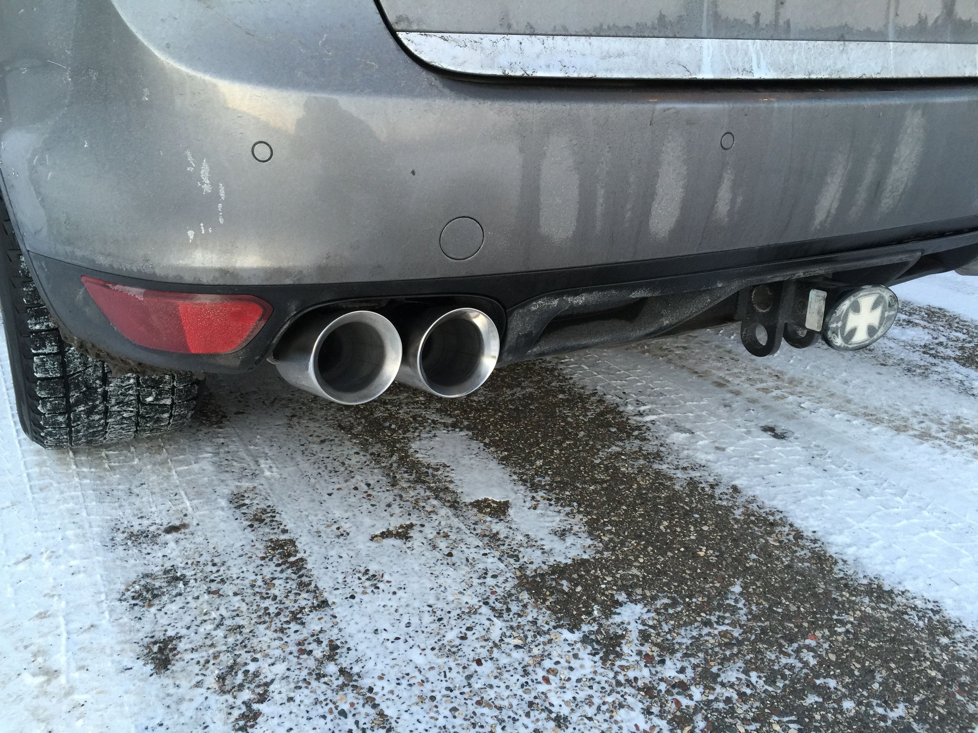

New tips installed
Driver's side Fabspeed tips freshly installed
Passenger's side Fabspeed tips freshly installed
Fabpseed tips installed...different view

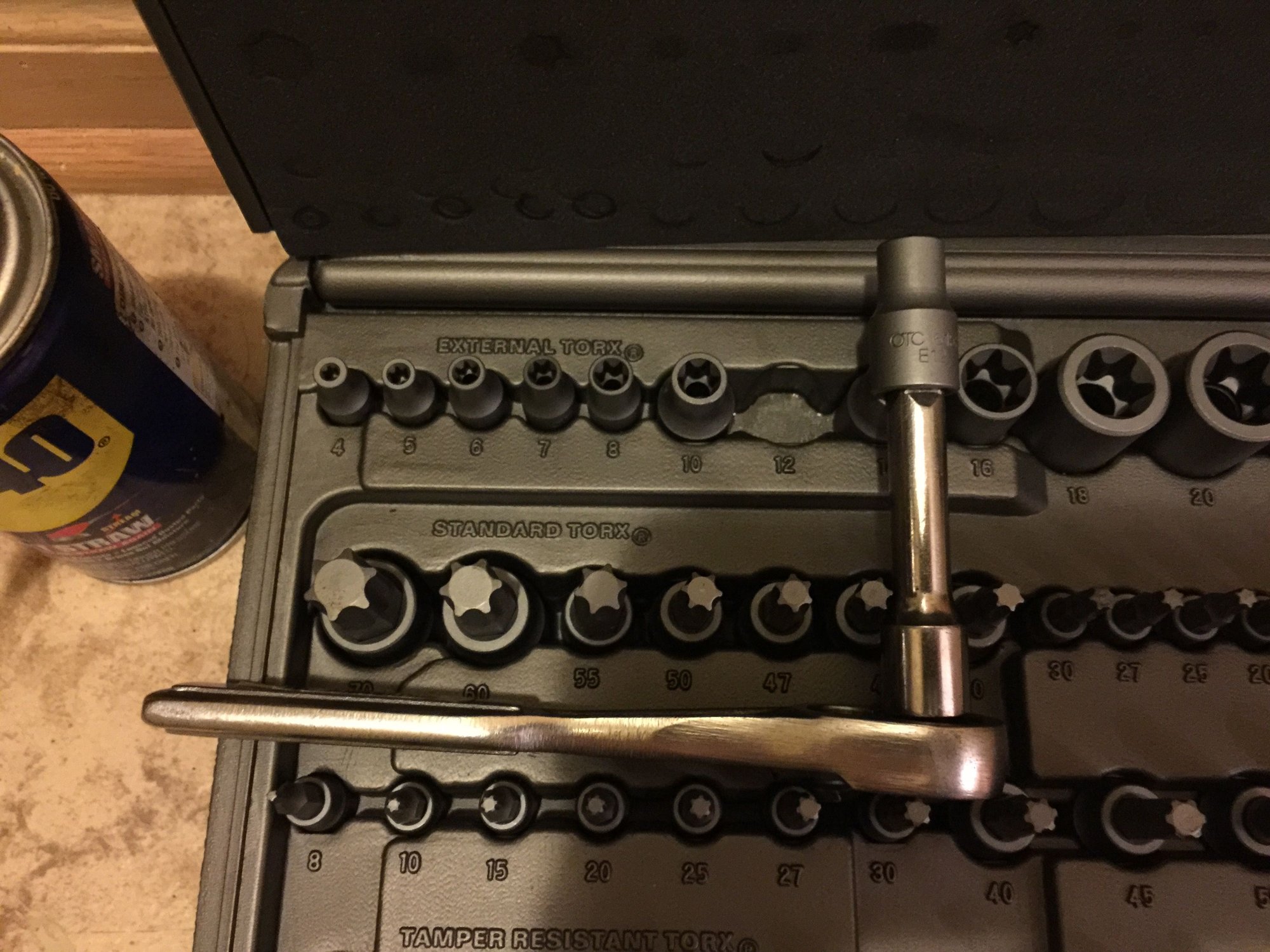

Tools needed to swap out exhaust tips. It would have been much easier in summer
External torx (#12) needed for the exhaust bolts

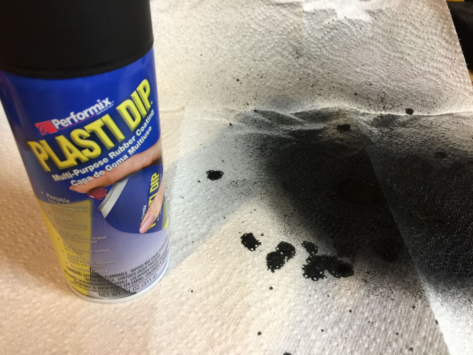

Recommend glove use as the Plasti Dip is a pain to get off your hands.
Advice is to go slow and use many coats. Don't try to over spray. That leads to runs as you can see above
Plasti Dip
Approximately one can worth which was about 7 coats. Done...

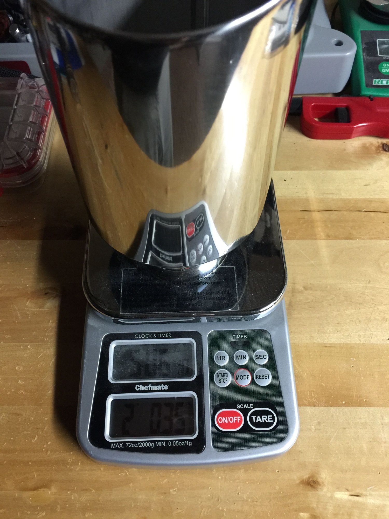

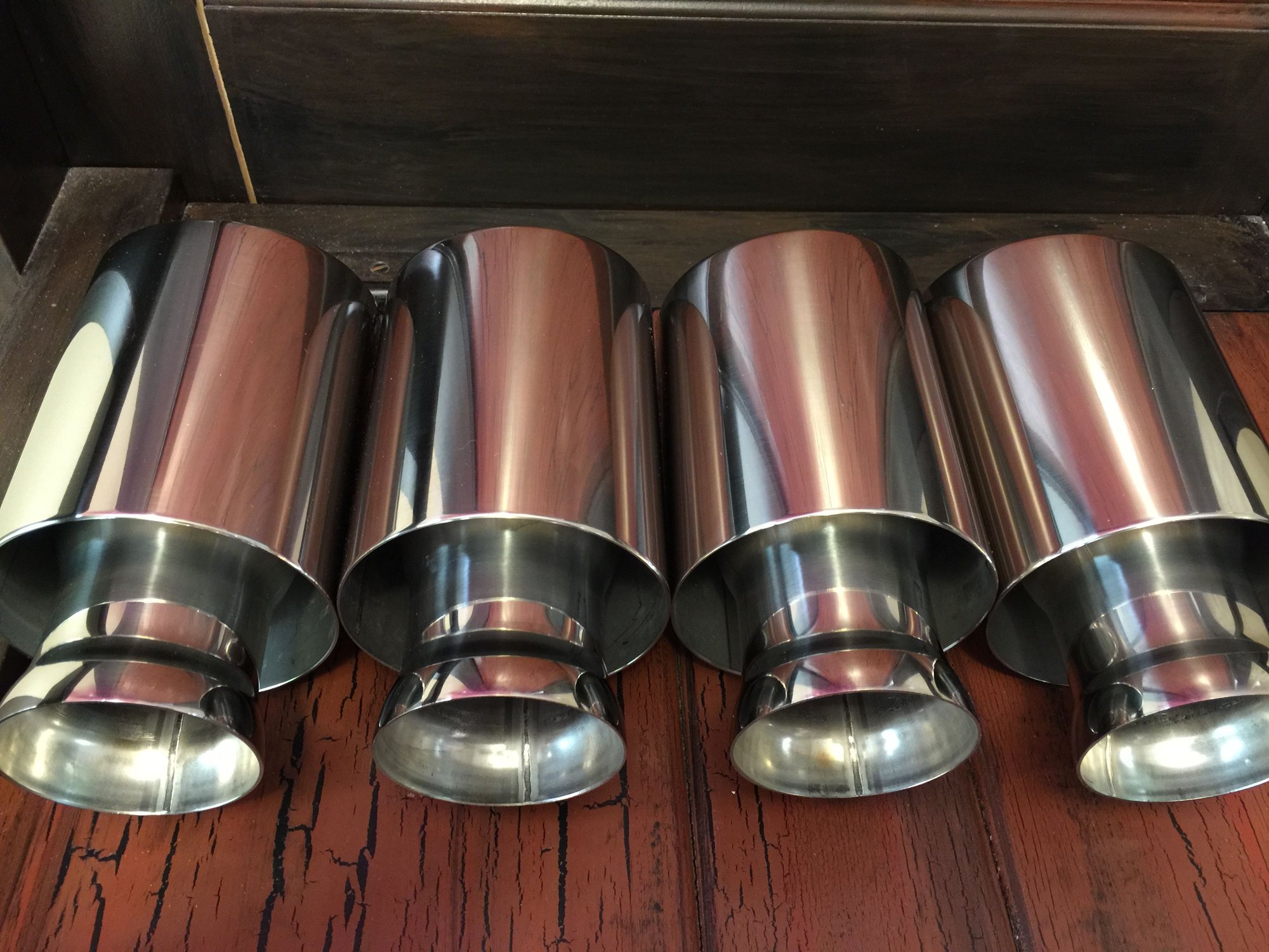

Fabspeed exhaust tip weighs just over 2lbs

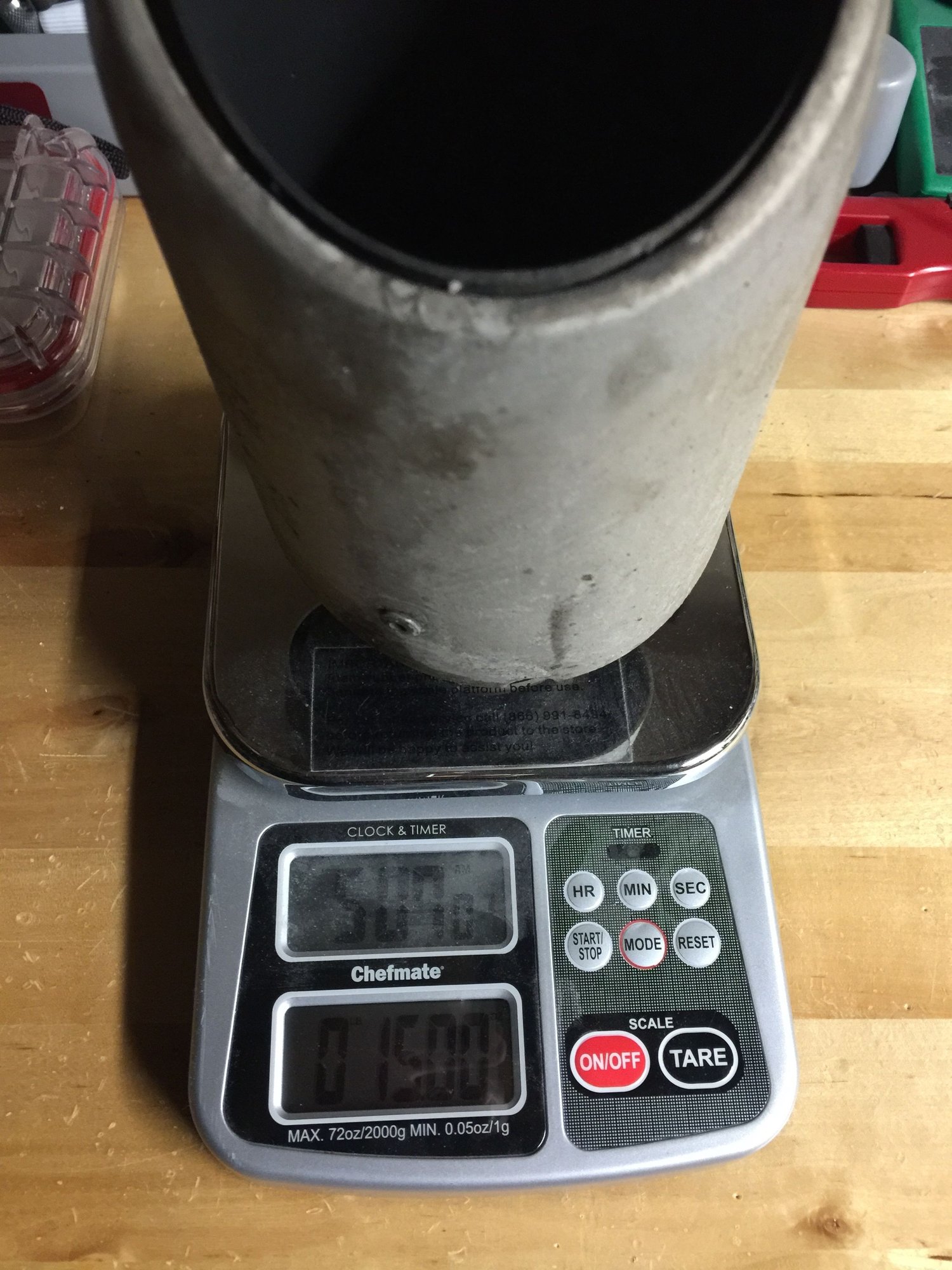

Stock exhaust tip weighs just shy of 1lb

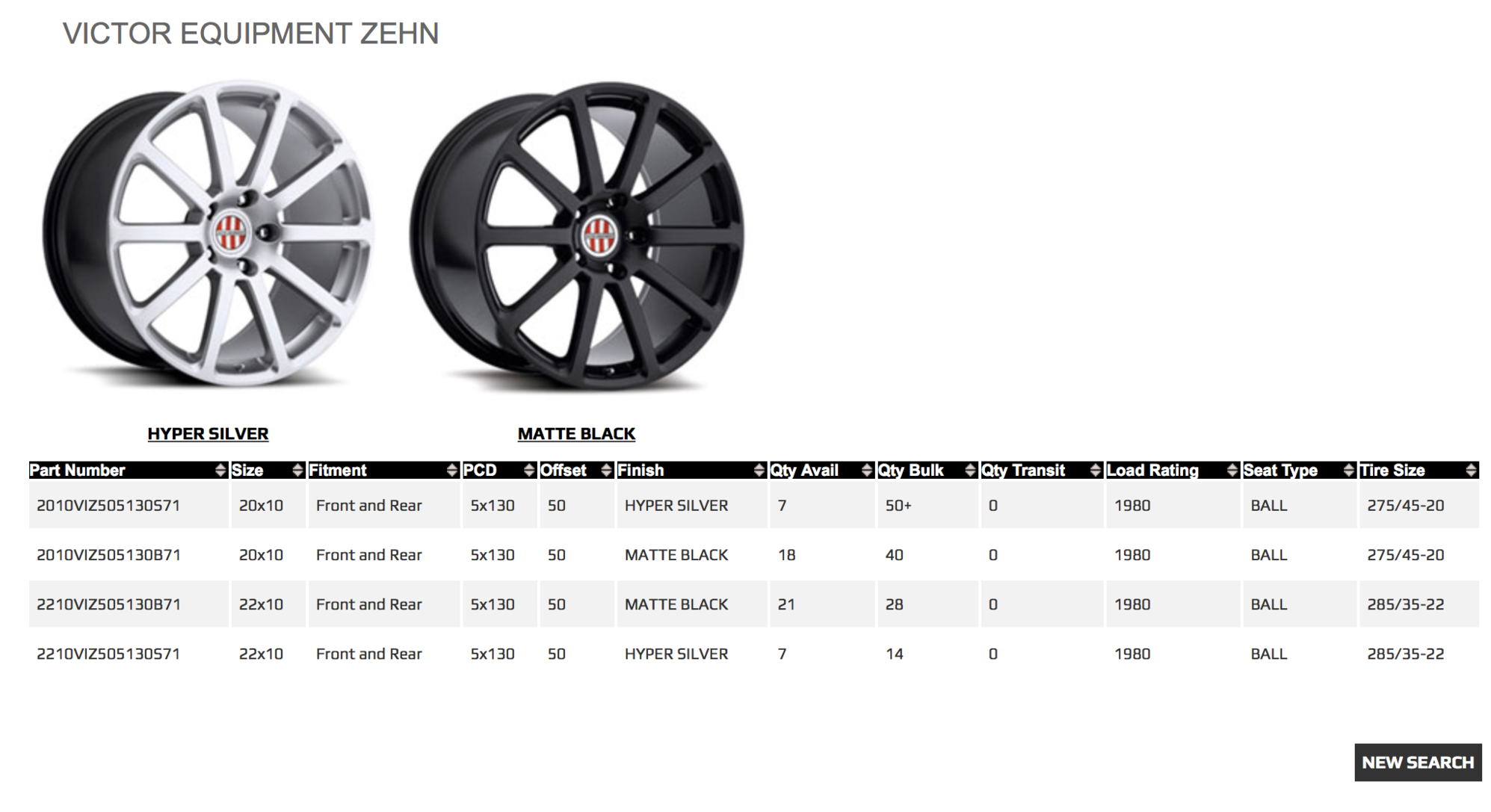

Do you know where they are manufactured and if they have suitable load ratings for a Cayenne?
Old Jan 12, 2015 | 09:26 AM
BlazinPond's Avatar
Joined: Nov 2013
Posts: 378
From: Atlanta/Minneapolis
Rep Power: 40
BlazinPond has much to be proud ofBlazinPond has much to be proud ofBlazinPond has much to be proud ofBlazinPond has much to be proud ofBlazinPond has much to be proud ofBlazinPond has much to be proud ofBlazinPond has much to be proud ofBlazinPond has much to be proud ofBlazinPond has much to be proud of
Not sure where production is located...
However, Victor Equipment manufactures wheels exclusively for Porsche aftermarket.
See specs below, including load rating below...
