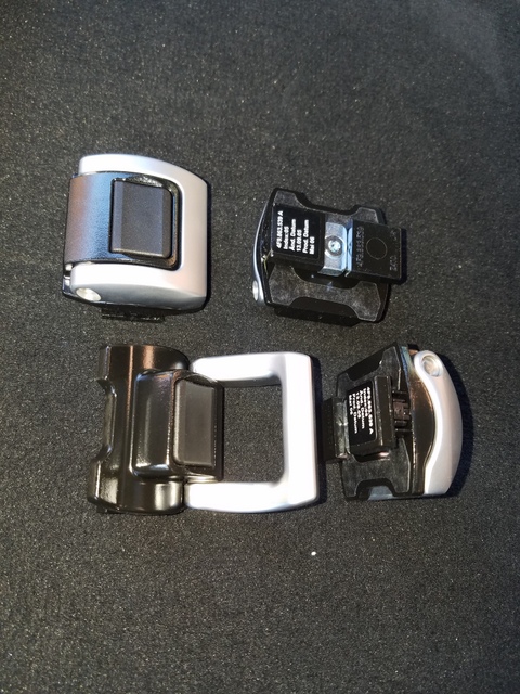

Here's the storage case that came with my GTS for the belt and hooks.
The spring could be a bit tighter on the roller. That and the belt and bar could be a little lower. There's enough gap to allow stuff to roll under. The hooks are quite nice, very hefty bits of machined metal.
I hadn't consider the front/back orientation of the belt, that's interesting.
