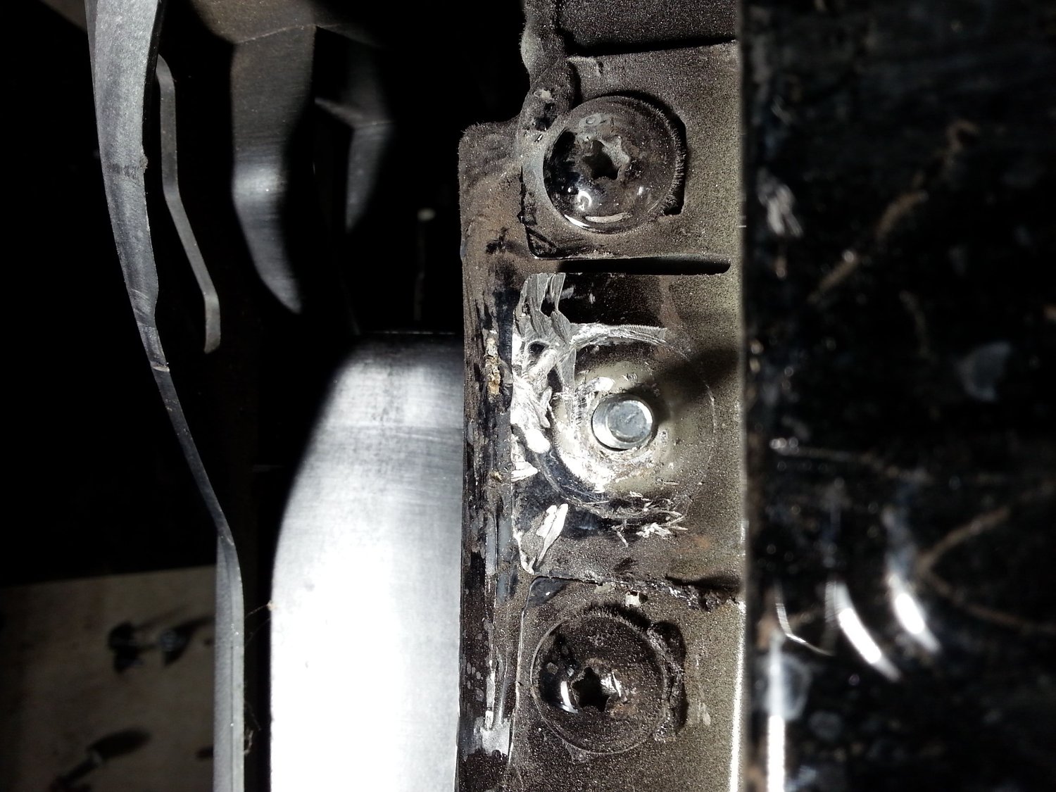

7)next, remove the hex nuts. 12mm. the first one in the front of the car is the only difficult thing in the whole install. the bolt spins freely so you can't remove the nut. i ended up cutting them off and replaced them with just some spare nuts and bolts( you have to bend the metal tab towards you to insert the bolt obviously). now you can remove the panel.
this is the devil nut/bolt.
this does not work. the bolt has a plastic coating like loctite to prevent it from coming loose. very hard to un-bolt.
this is what it looks like before.
new bolt insterted. sorry can't rotate the pic. right side is up.
