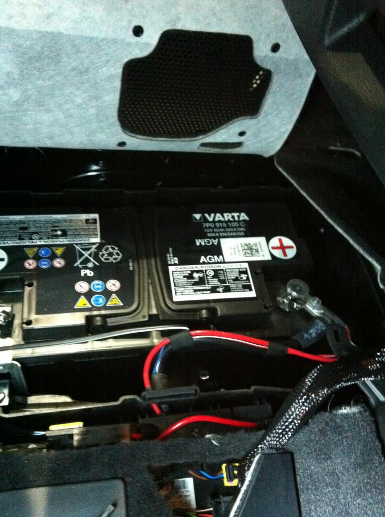

I am replacing battery on my car and I noticed this connector that is just hanging there... I don't remember disconnecting it when taking the old battery out... anyone know what this connector is for?

No idea at all - is it coming from inside the battery case, or as it looks, along side the case?
There is a battery monitoring connection on the positive battery terminal (measures the current and temperature of the battery so the charging system knows what charge level to use..) but this looks like it isn't in the case - the battery connection IS in the sealed case.
There are a number of connections that go to the bottom of the seat.. could this be one for the seat-belt latch?

It is running along the case side and it's a very short cable so I don't think it connects to the seat. Also the carpet seals the entire area and no cables go from battery compartment to seat. This particular connector is attached to another cable at the bottom as you can see in the picture. It looks like a sensor but workshop manual has no reference to it.

Actually - I can't really see in the picture. It's mostly black plastic showing with not a lot of depth.
To clarify - it is not originating inside the battery case - correct?

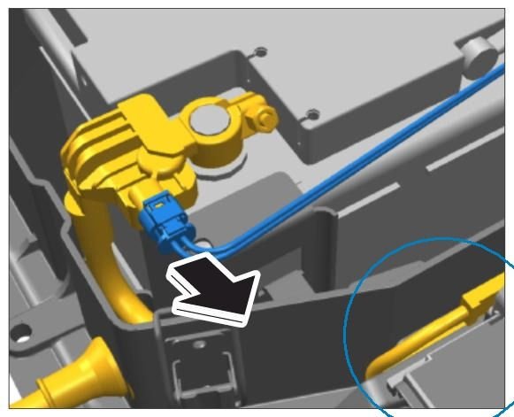

Went through the wiring diagrams - and couldn't find any cable/connector matching the wire colors that are in your picture (blue? And maybe black/yellow?)
But - did find some images that might give a clue:
First image - note the blue circle (I added) - and the connector/wiring shown there:
Second image - same thing - the connector inside the blue circle:
It appears the connector in the images plugs into the side of the main fuse area.. you might see if you can spot a place to plug it in there..
Thanks for sharing the pictures. I looked at these as well and tried finding a place where this connector might go. As you can see in the pictures the connector is really short and ends right there. I opened the plastic trims around there and I only see the negative cable connections there. I don't see anything on top of the distribution box either. I looked at the instructions in the workshop manual for battery replacement, distributor replacement and fuse panel replacement.... no references to this particular connector at all!!

And see this image... it doesn't look like it's connected somewhere... or does it?
https://www.6speedonline.com/forums/...ine=1386355090

I can see where it goes in your first picture..
Old May 11, 2016 | 11:58 AM
Nixer's Avatar
Joined: Apr 2016
Posts: 50
From: Dallas, TX
Rep Power: 13
Nixer is infamous around these parts
Yes, but there is nothing inside that hole this plug can be plugged into... Am I missing something there!!!?
