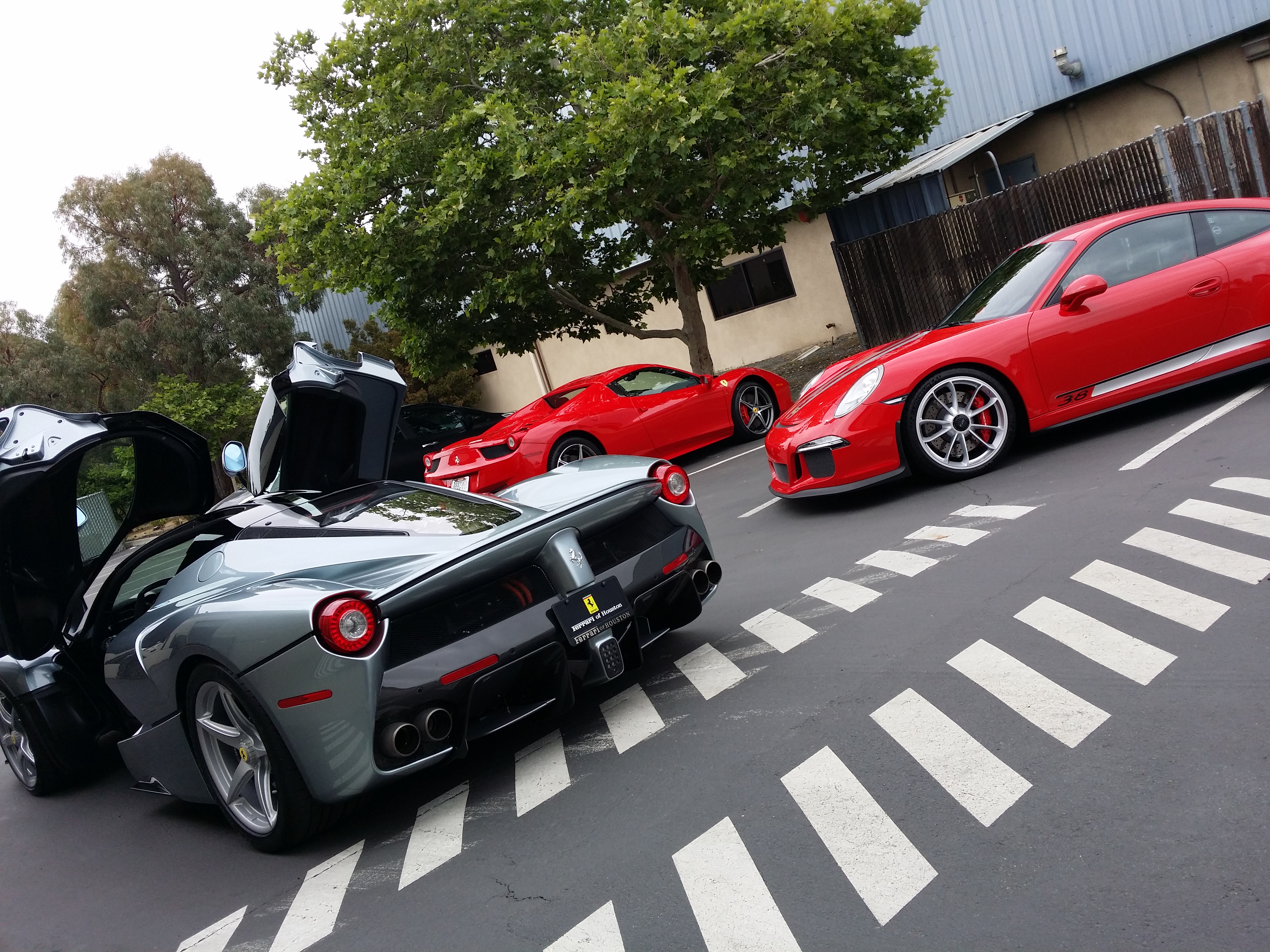

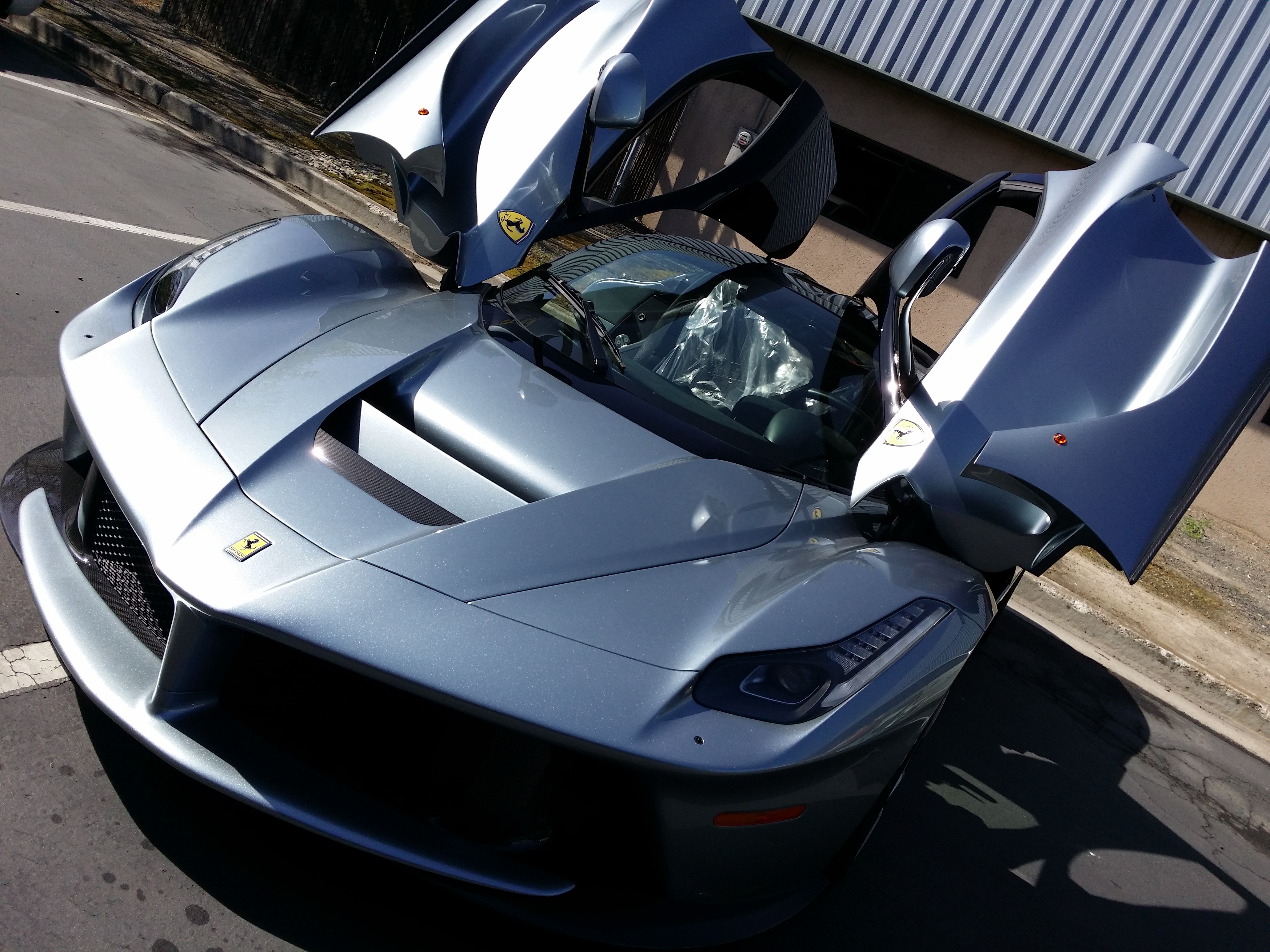

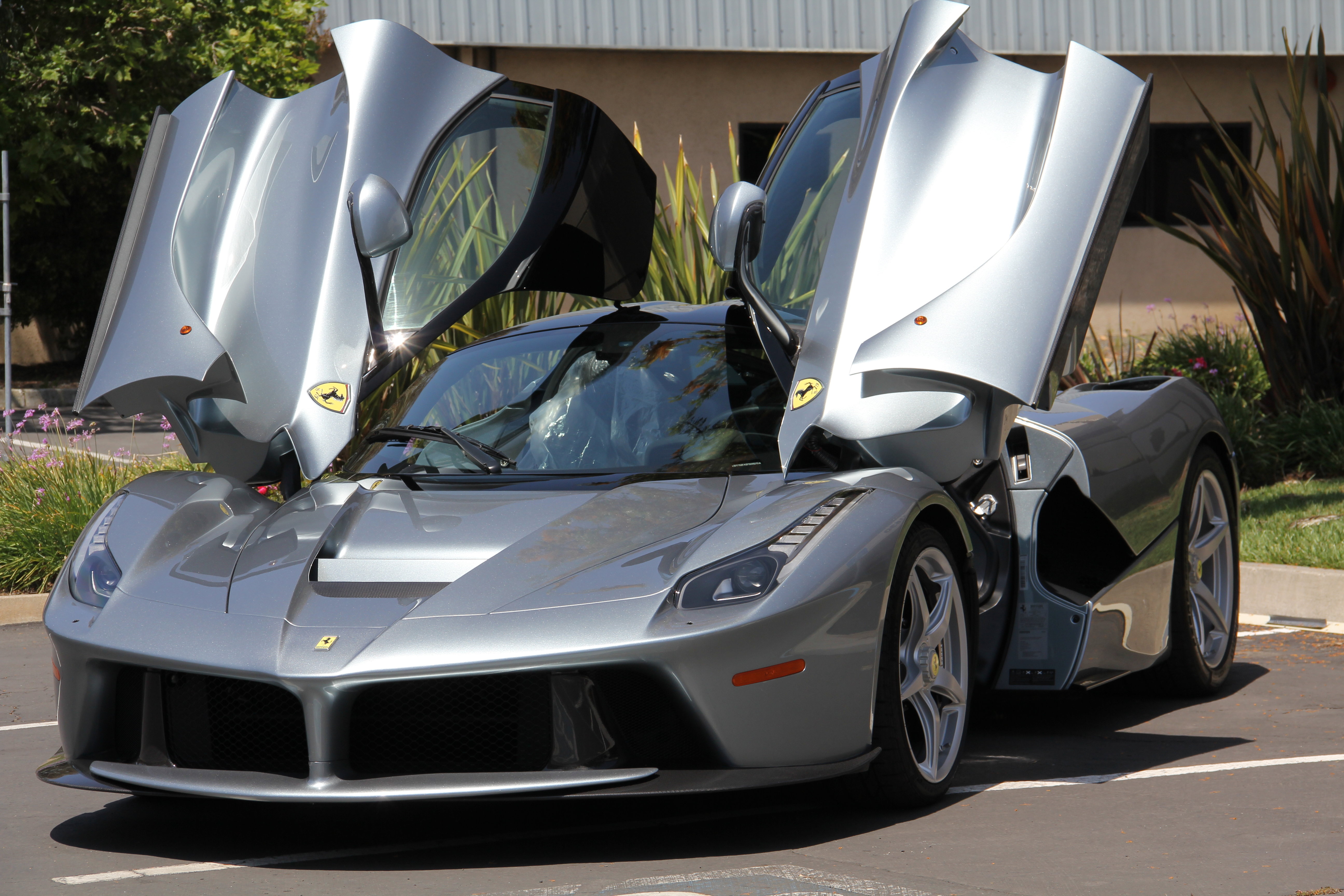

Here are some cars done with Spectra PhotoSync:
LaFerrari - Photosync 75% on windshield / 65% on the sides
Red 911 GT3 - Photosync 75% on windshield / 55% on the sides
