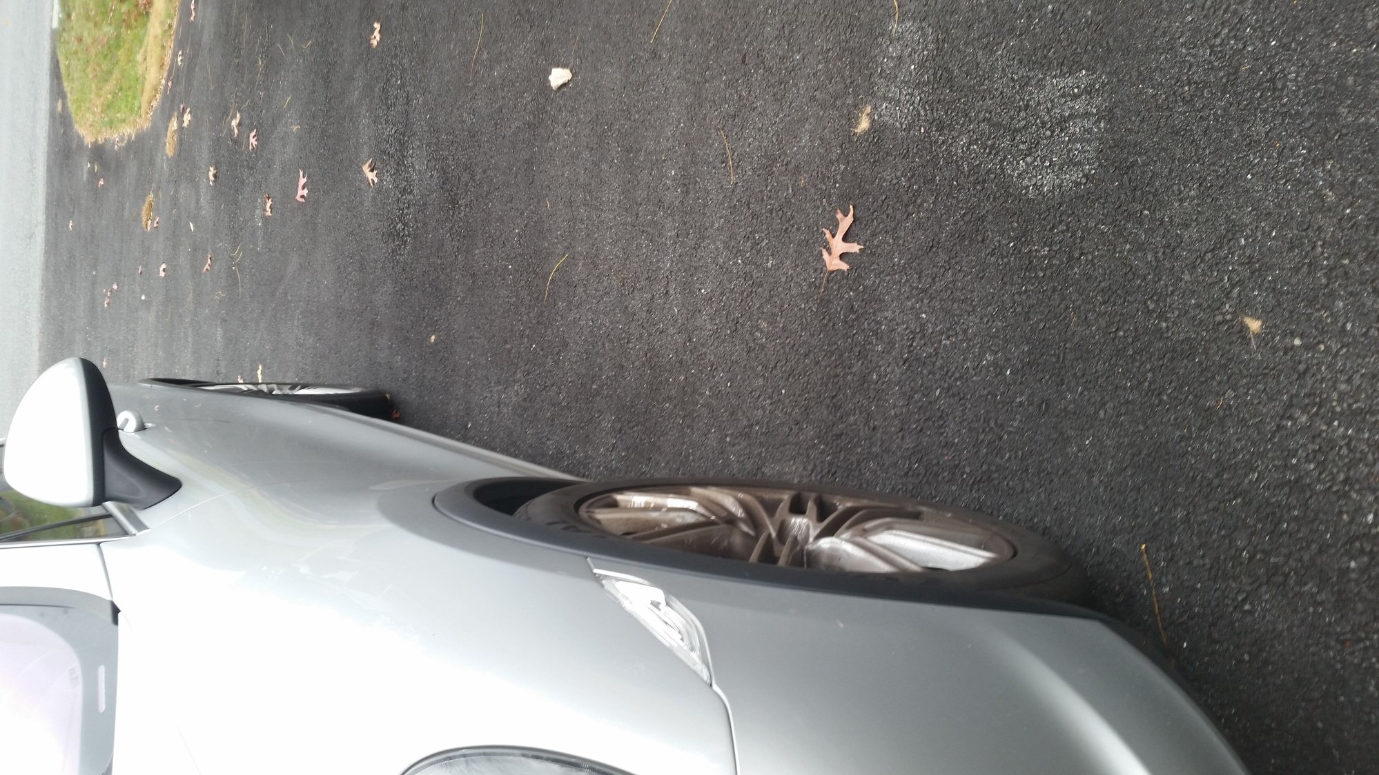

I appreciate the insight. Do you happen to have a picture of the 295/40/21 mounted on your Cayenne? I don't want you to go out of your way, but if you have a picture I was curious. I presume it is not a noticeable visual difference.

Sure, I will do you one better. Here are pictures of both the 2011 with the 305-35-22 and the 2012 with the 295-40-21, both vehicles in Low (Sport Suspension) mode. Please excuse the brake dust!

Thanks. It actually looks like the 305/35 has more room than the 295/40 or maybe it is the way the front wheel is turned on the 295/40 that it just looks that way. I expected the opposite based upon your post and the actual tire size.

Actually I was wrong, the 295/40 should extend slightly closer to the wheel well as the picture shows.

They tires are actually very close to being about the same diameter, (just over a tenth on an inch difference) and closeness to the the respective wheel wells. I will say that if you look at the 4th picture you can see that the 2012 vehicle with the 295's is equipped with the wider fender flares which may alter your visual assessment as well.

Also, the vehicle with the 305's the wheel is turned slightly outward to the left, with the 295's the wheel is turned slightly inward toward the right. I apologize for not straightening the wheels on both prior to taking photos first for a better visual analysis.
