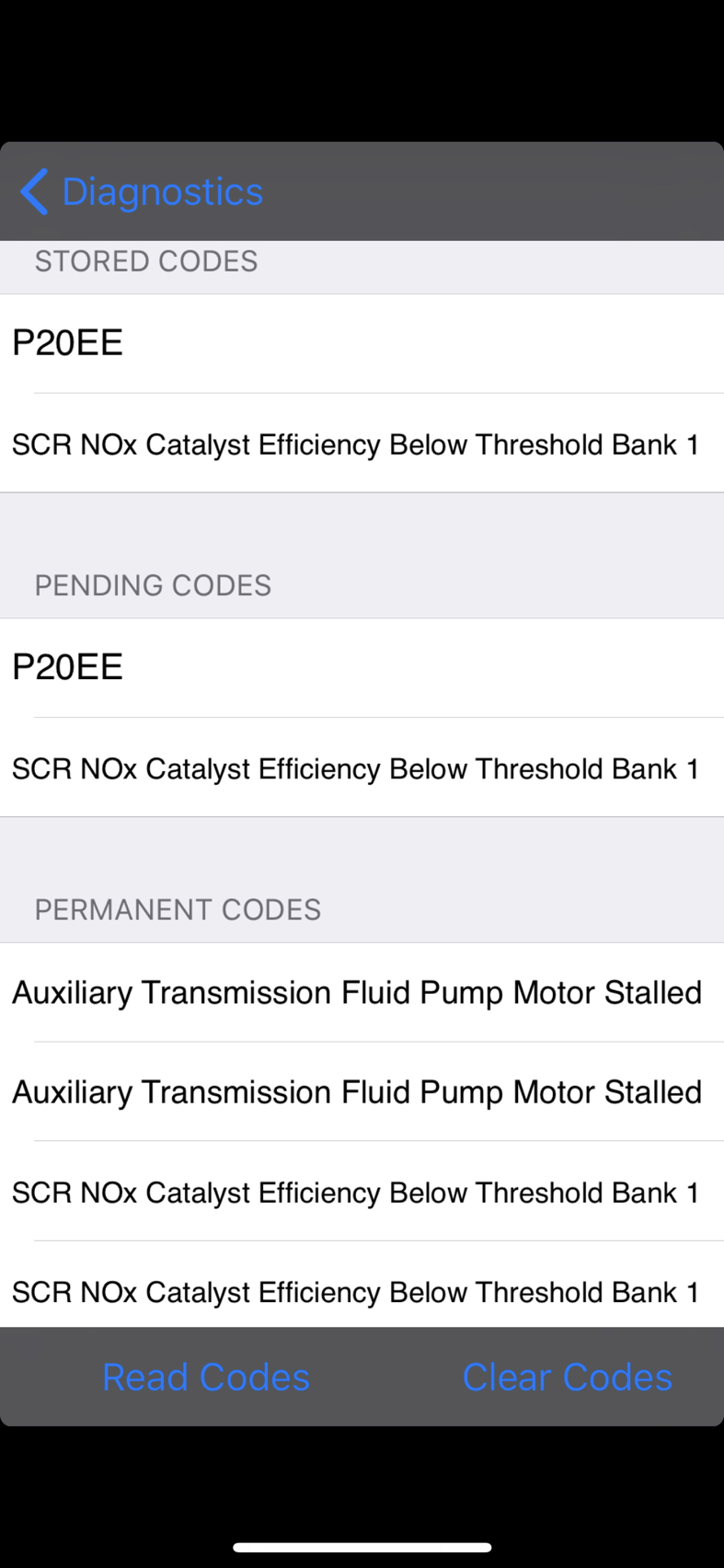

I don't have auto start/stop but have the code in my diesel. It is getting sorted under the diesel 10yr/120K miles diesegate drivetrain warranty.
mine has the same 2 code combo, what did the dealer say was the problem and what did they replace to solve it?
