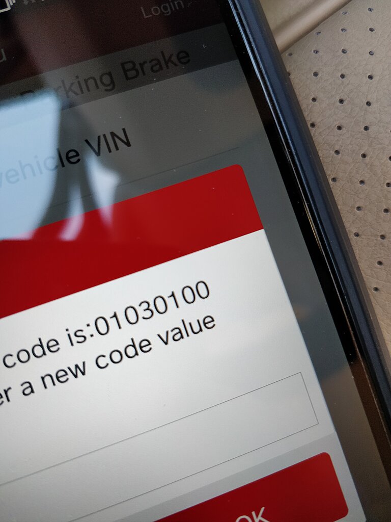

My iCarScan is running the outdated Porsche software so it's missing a critical menu selection. I grabbed my Launch x431 and fired it up and noticed there's a new menu selection called "Control Unit Replacement" under "Special Function".
In this menu, there's a selection calle "Write Random Code". This is for coding the parking brake. The default code on our Porsche Cayenne Base and probably all Cayennes that don't have the PCCB brake is 01030100. I had to get this number off of another Cayenne. Mine was defaulted to 00000000 after I hit "Restore Default Setting".
I hope this information is helpful to someone out there. The iCarScan is a powerful tool so just be careful.
