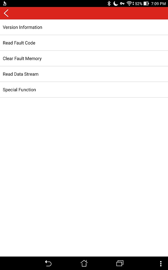

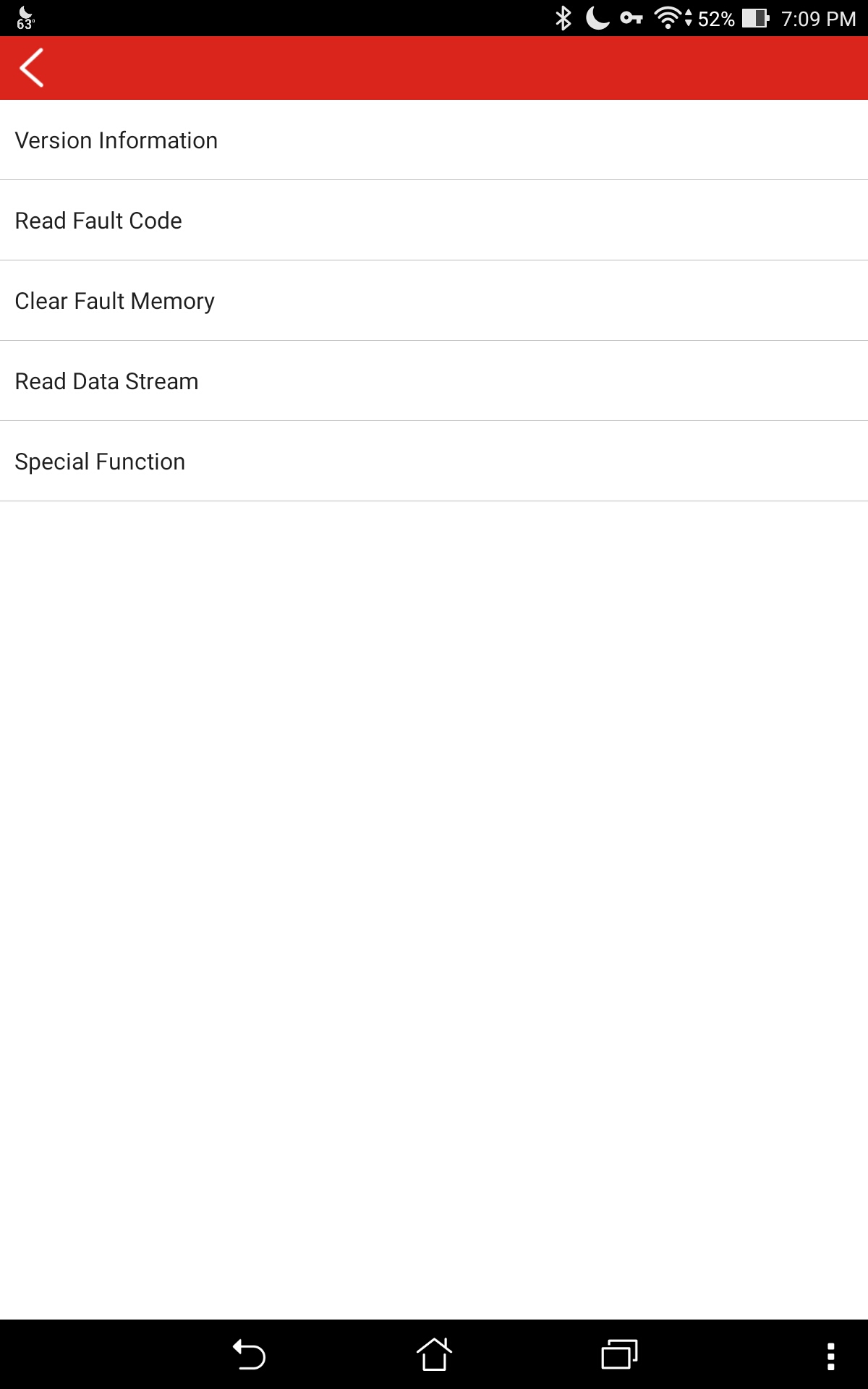

Main Menu. It's listed under Gateway:
To change, select the Special Function:

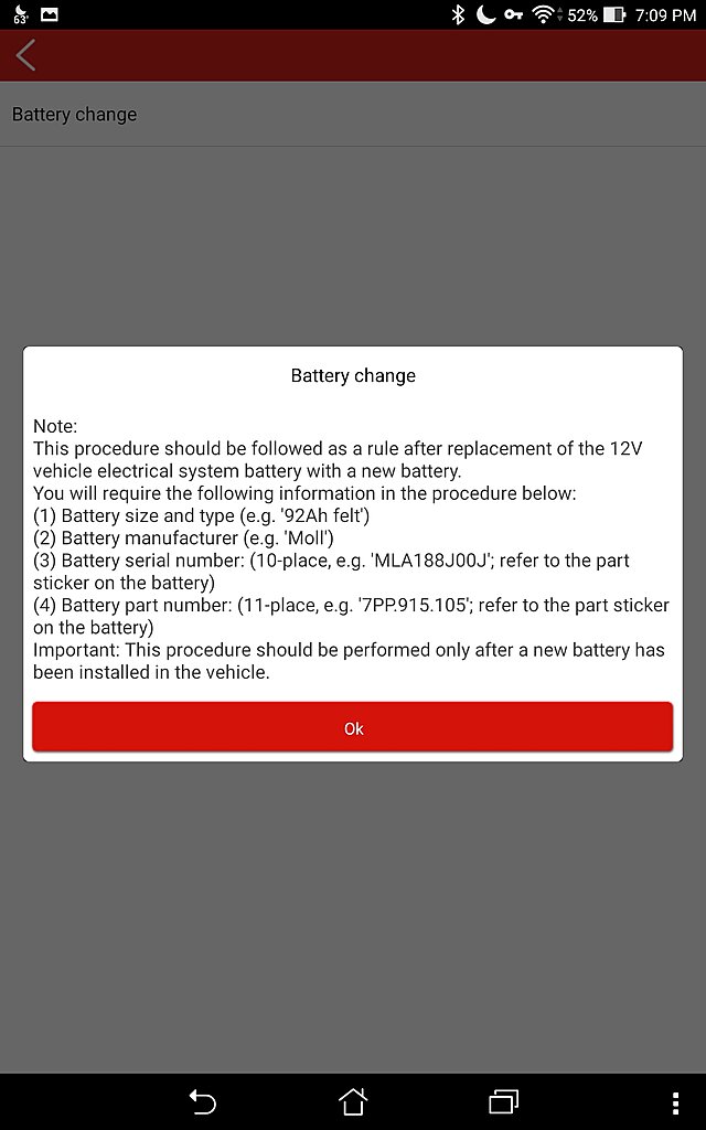

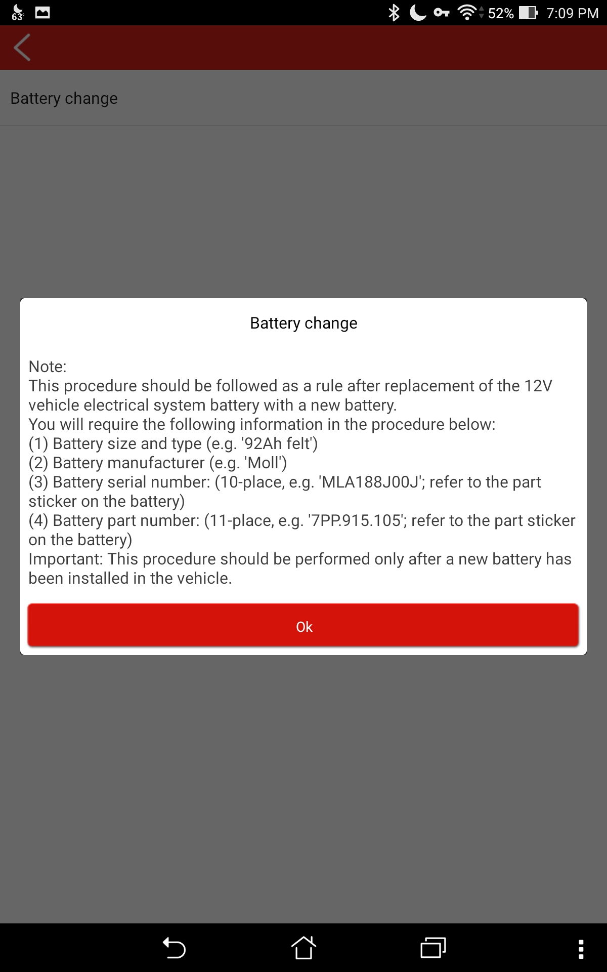

Instruction will pop up after tapping "Battery Change":

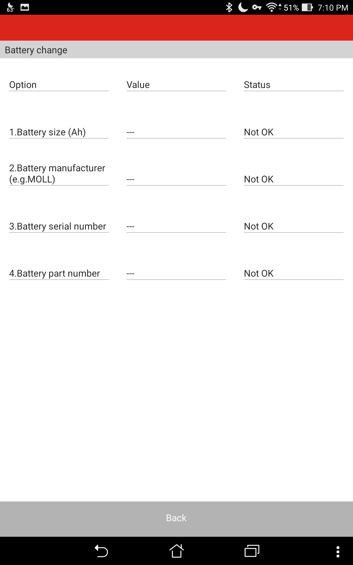

You will need to populate all the valves:

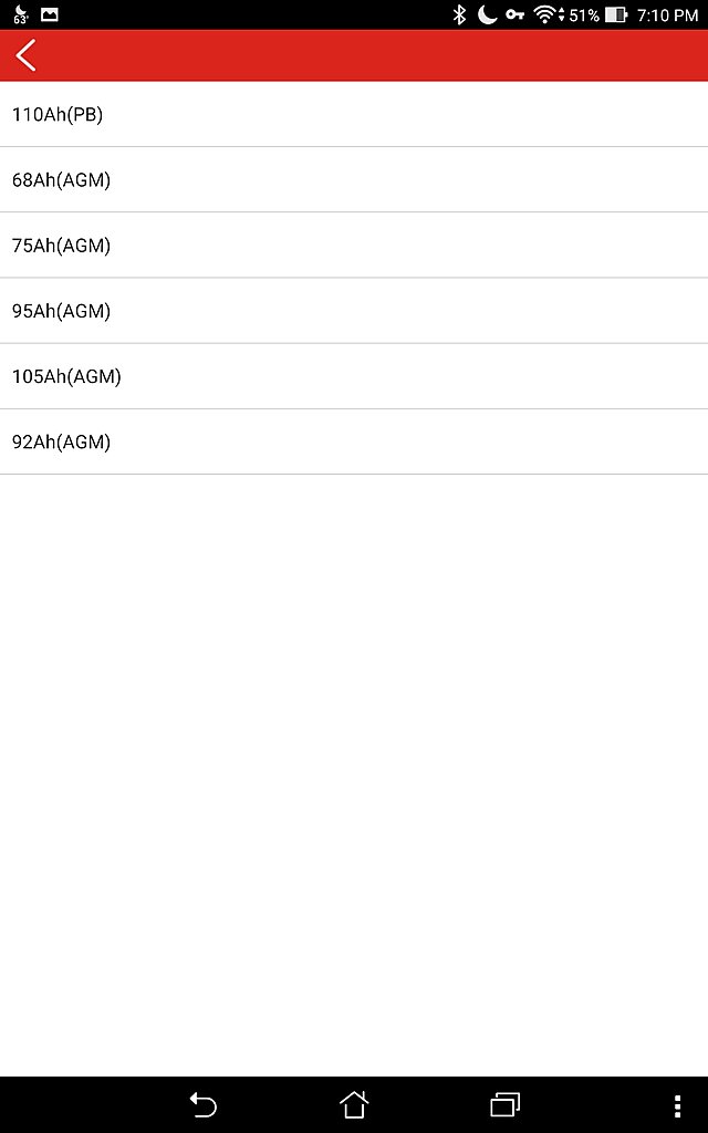

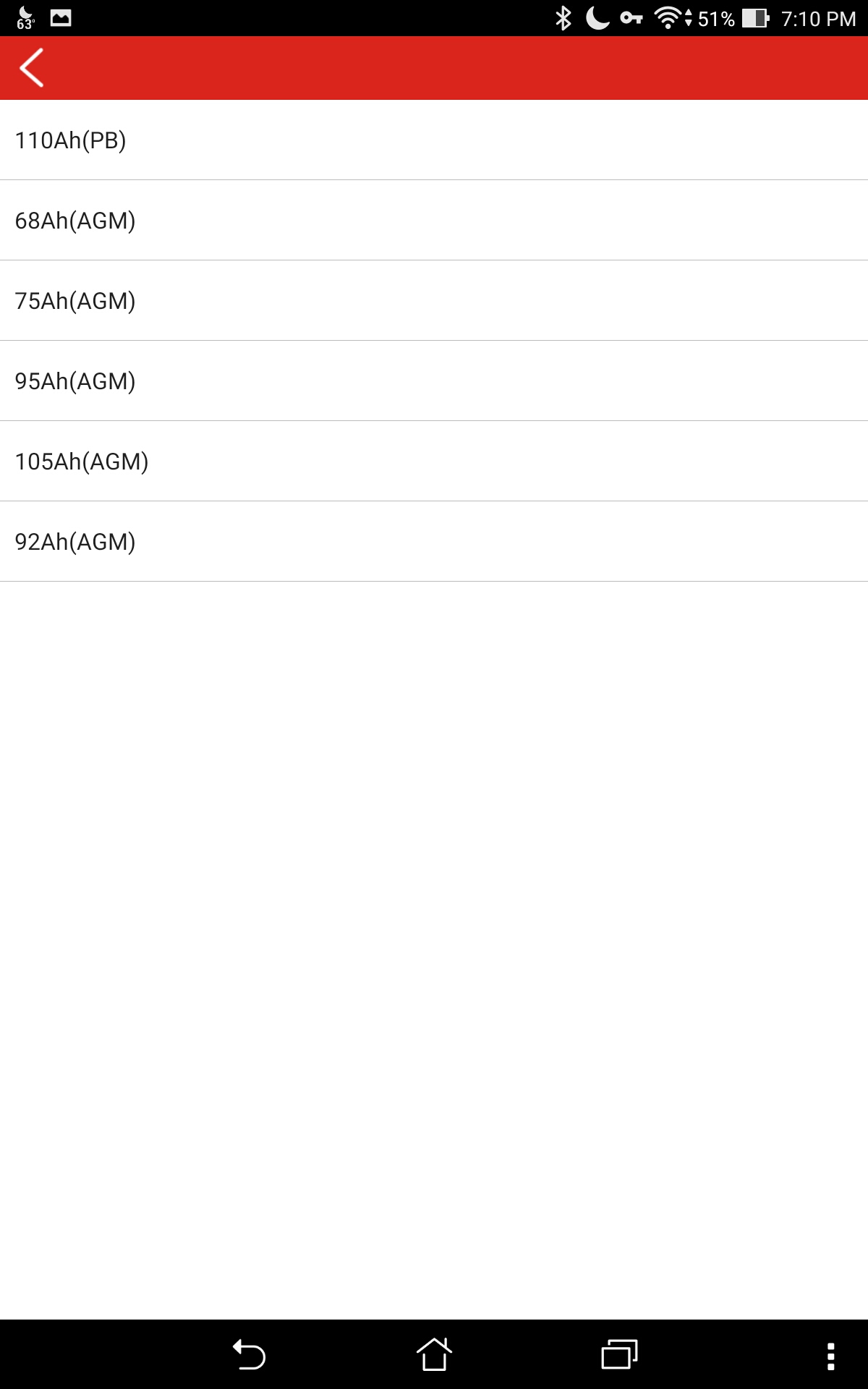

Listed under battery size:

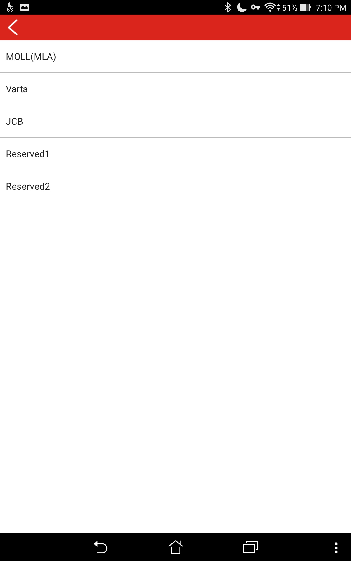

Listed under the battery manufacturer:

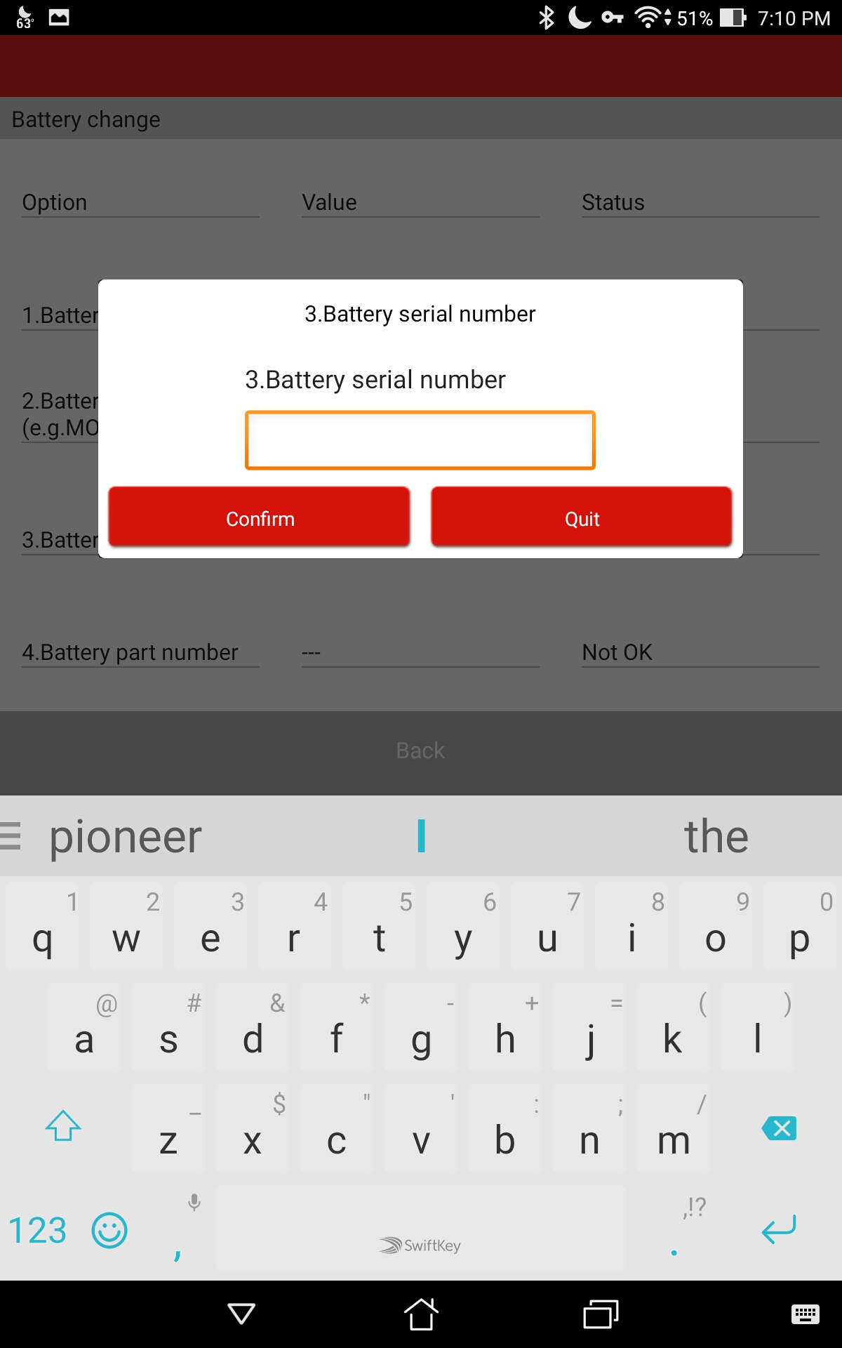

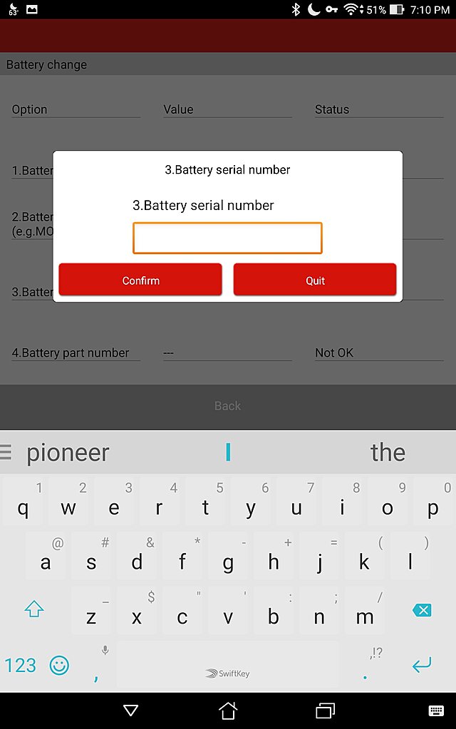

Type in the battery serial number:

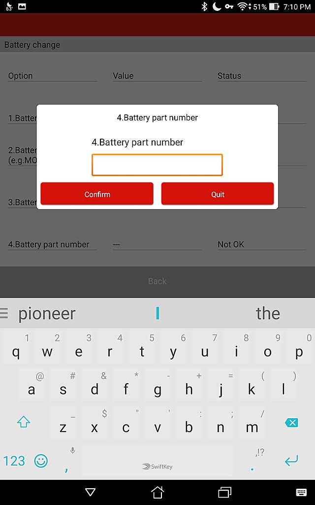

Type in the battery part number:
Status should turn OK if everything checks out.
