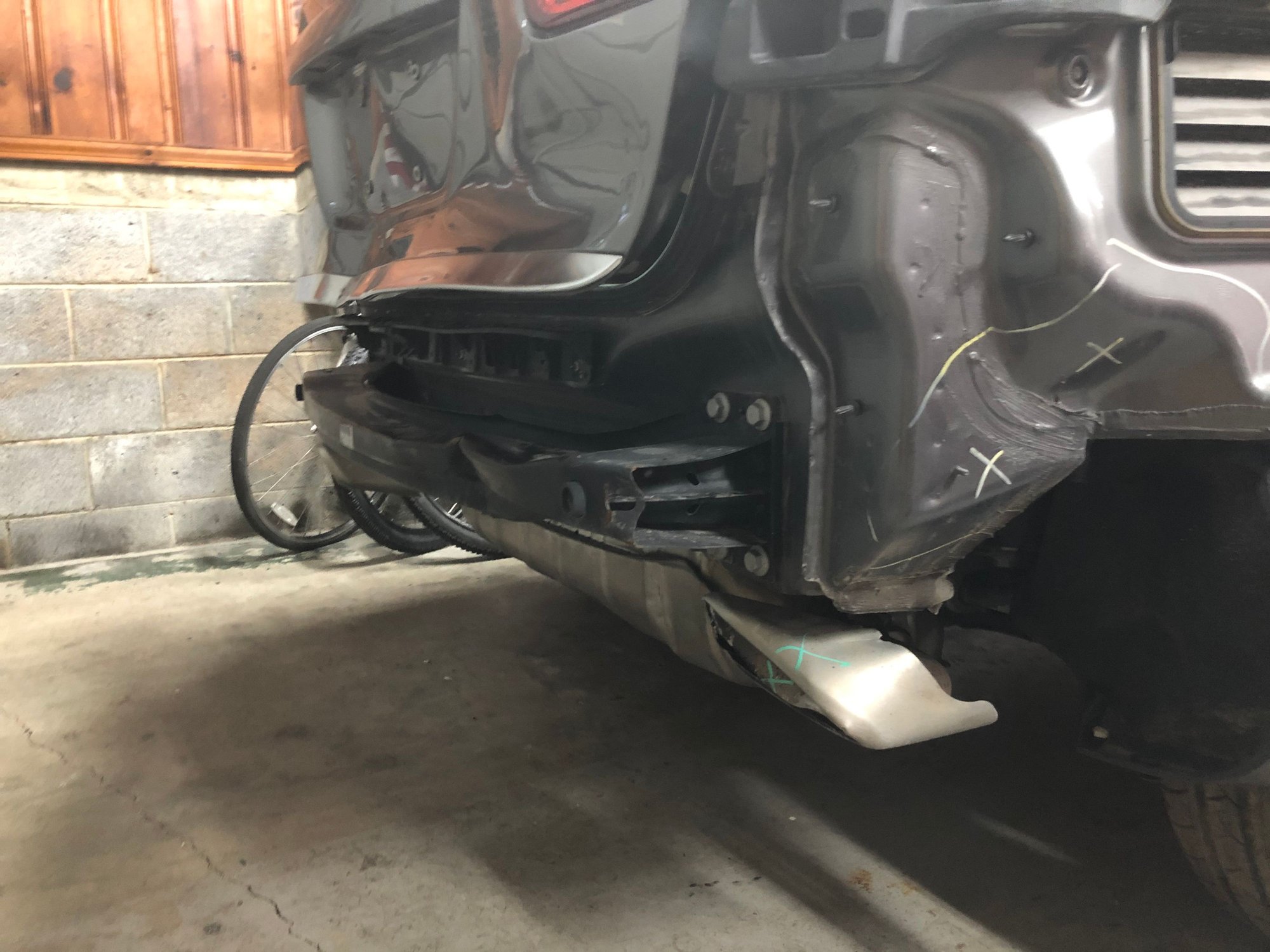

I knew the car needed some work on the rear end to replace the bumper, impact bar, lift gate and exhaust tips as a minimum but also the car had no electrical power at all (Odometer could not be read) so i knew there was an electrical element to this challenge as well.

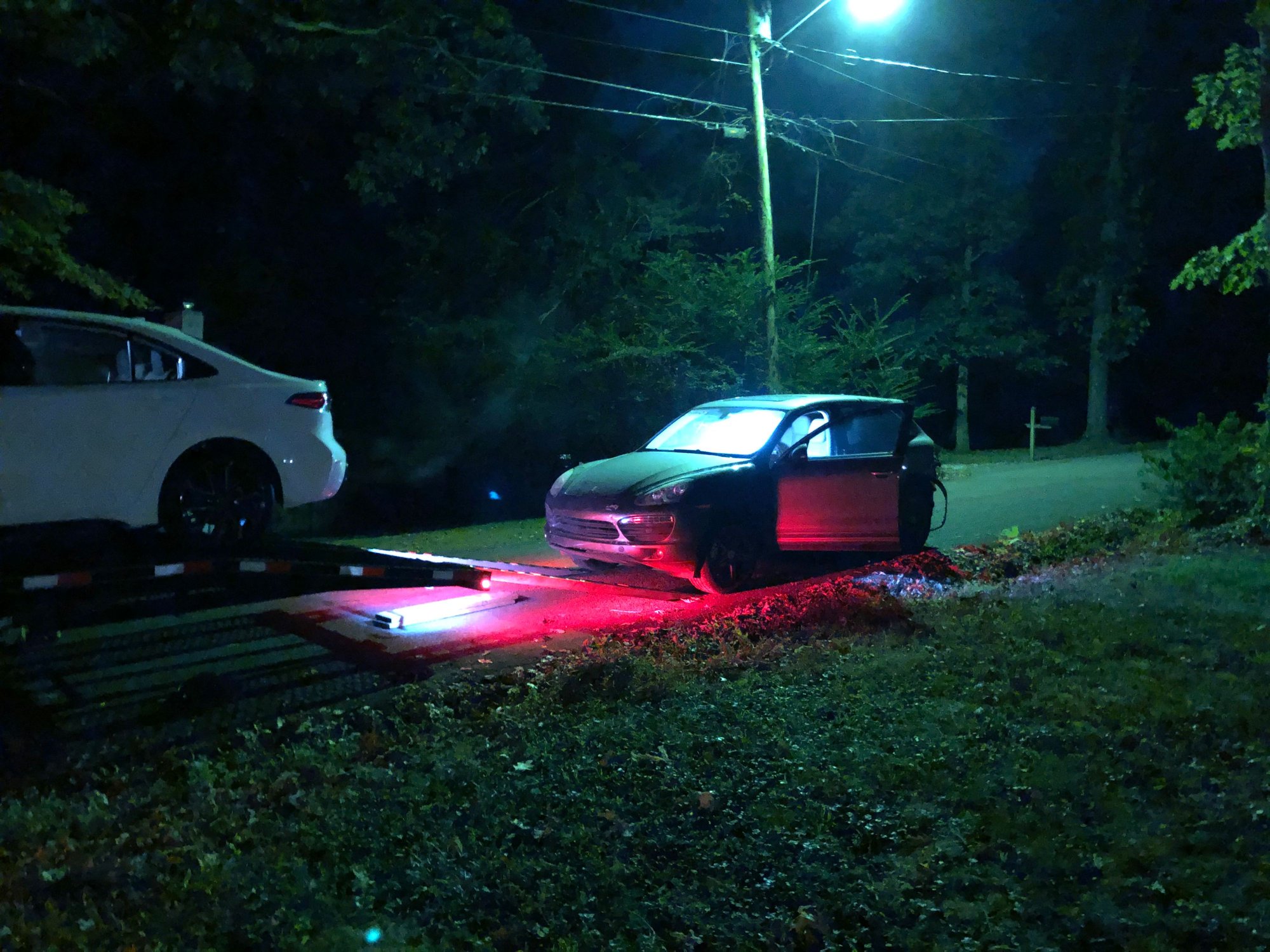

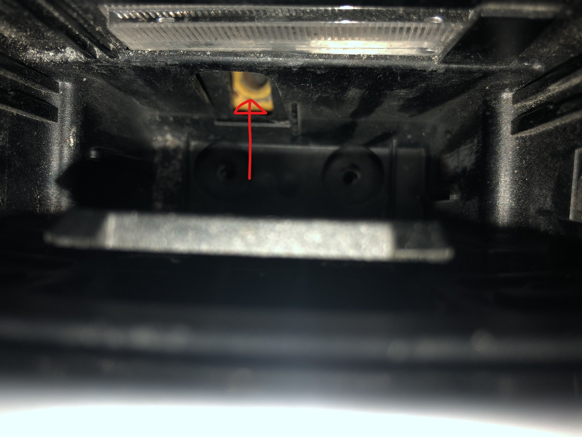

Delivery & Emergency Gear Release
I took delivery of the car a week ago as it was flat-bedded to my house - The first challenge was getting the car off the flat bed.
There is plenty of info on this for the Cayenne 955 / 957 but the Porsche manual was not the best for the 958. The direction you need to push "Against" the spring force is not defined and i found this to mean you literally have to "push" the screwdriver down into the yellow hole opening for the release to work:
http://www.porscheownersmanuals.com/...rgency-Release.
Once this was done i was able to shift the car into neutral and roll the car off the flatbed and into my garage.

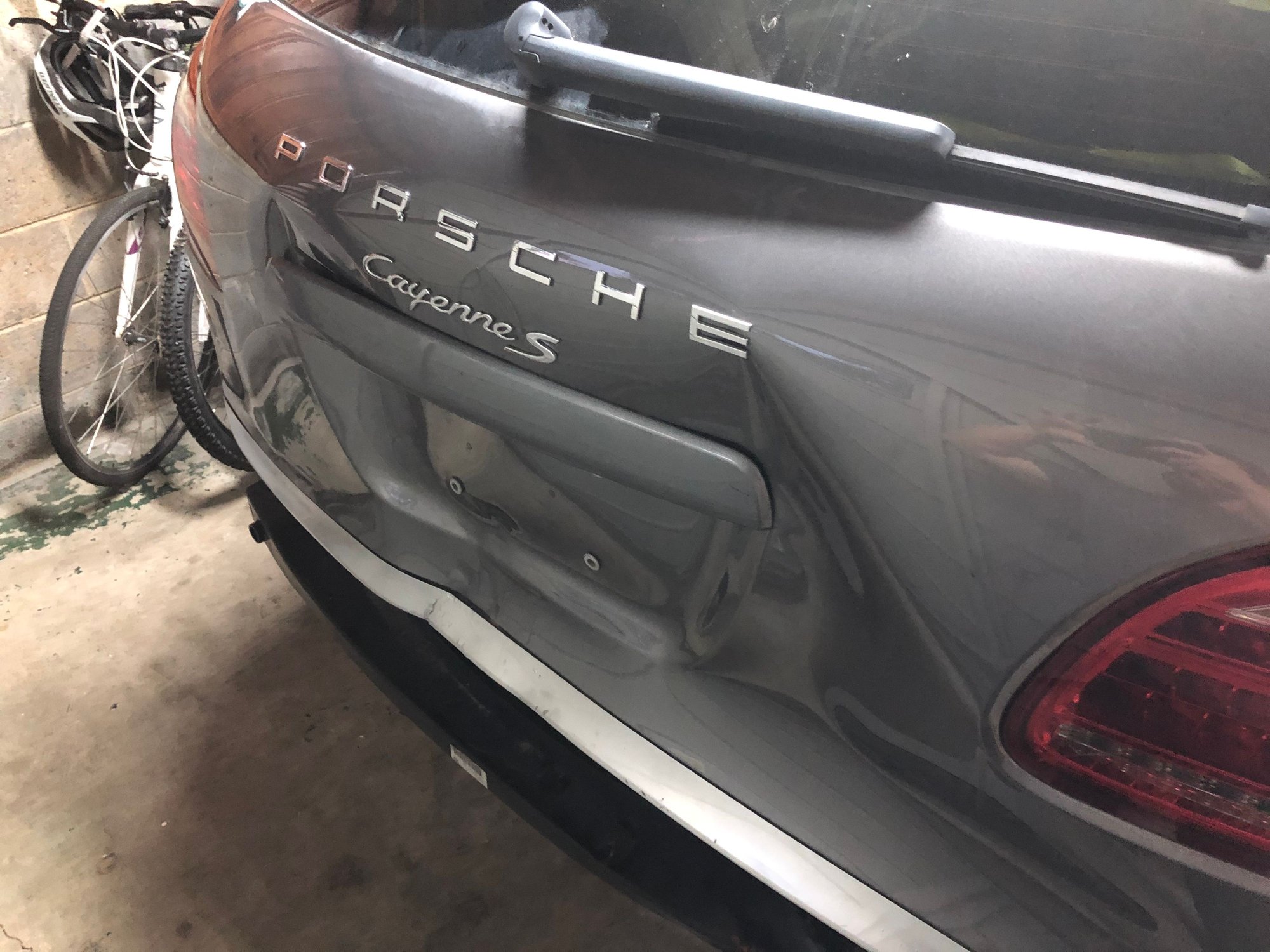

Initial Inspection:
The Impact damage was no worse than anticipated - The frame etc all look to be in great shape and the damage had not reached anything critical. Only the plastic bumper, crash bar, lift gate and the right exhaust tip were damaged. everything else, from initial inspection looks promising.

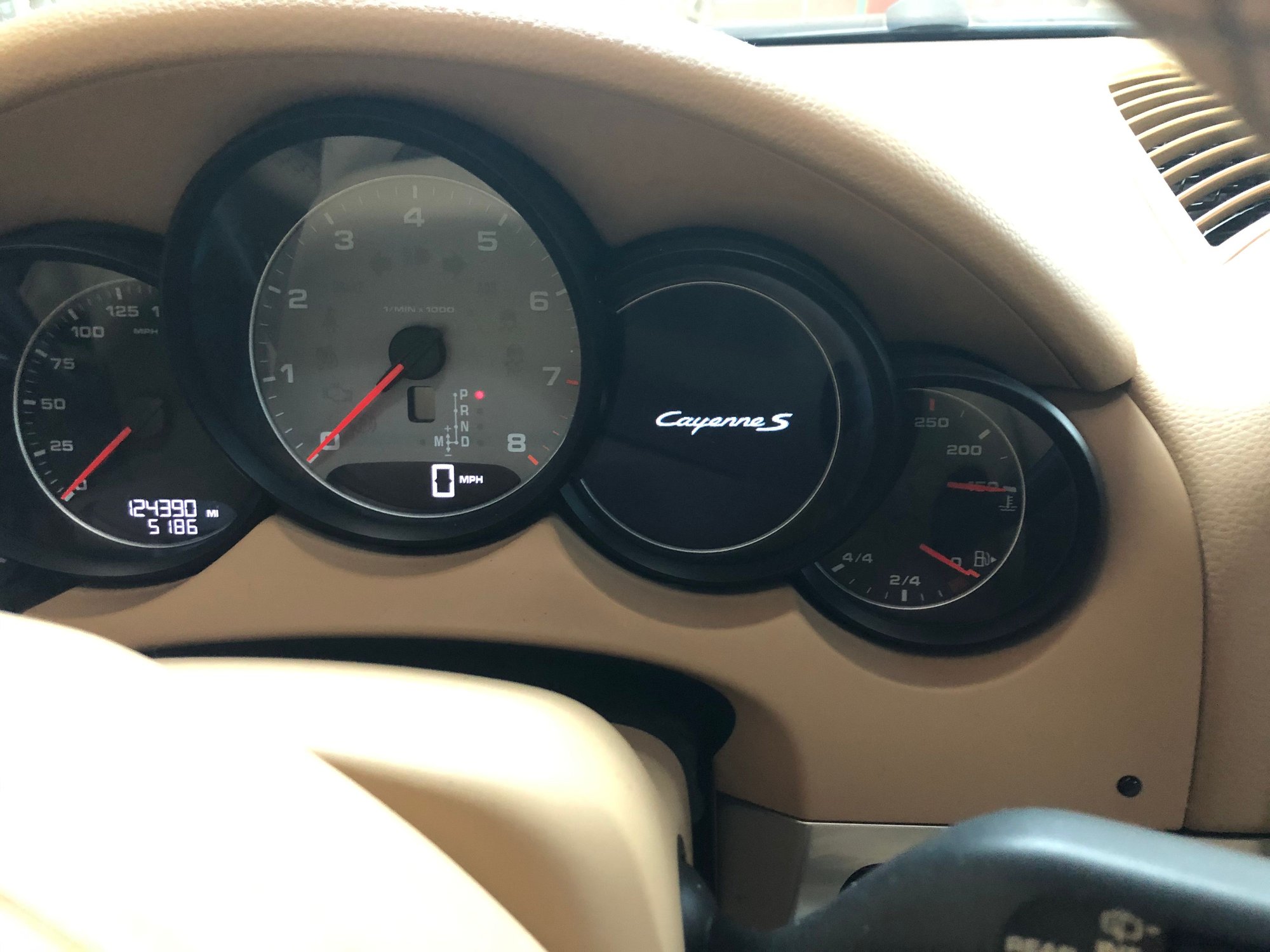

And that brings us to yesterday evening where the car fired back into life for the first time with a V8 Roar! �� (And a few hundred error warnings) - However, the shifter is stuck in park with the error message "Emergency Gearbox Operation" on the dash as well as a CEL- The only way to get the car into gear is to use the Emergency override to physically bypass the shifter interlock.

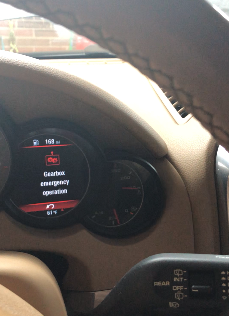

Error Messages & "Emergency Gearbox Operation":
After 20 minutes or so with the ICarsoft PORII (purchased thanks to the recommendations of this forum) i managed to clear all but a few error codes (Most of which were residual codes left over due to low voltage and / or missing lights on the lift gate).
As of right now the car starts up perfectly and the engine runs smooth but the car is stuck in park.
THe ICarsoft PORII reads the following codes:
  • P070900 - Transmission range sensor, open circuit
  • C12082 - Check Transmiss. control unit fault memory content
  • 000125 - PSM Activation by PTM
  • U0414 - Check Transmiss. control unit fault memory content
  • U0402- Check Transmiss. control unit fault memory content
Im wondering if when i was trying to engage the emergency shifter override, if i managed to tweak a sensor of some kind which now means the car doesn't know the position of the shifter?

And this is where i will start looking for help - Have any of you come across this fault in the past or is there any recommendations for what to check? Im currently tearing into the shifter assembly to see if there are any sensors or switches that need adjusting, but wanted to ask if you had any advice on what to check?
To add to the symptoms, when the drivers side door is open I get the error “Put Gear to P” (even though it is) and that the gear select light (Little red one below the speedo) only shows up when the car is off – otherwise it disappears entirely (Even with the override).

Car delivered and finally off the tow truck
Emergency Gear release - You need to push inside the yellow hole.
Assessing the damage
Accessing the battery - Note how the rails are still on the car as i did not have access to the rearward tri-square bolts.

New battery installed & Signs of life!
Gearbox Emergency Operation error

Quick Update - Gearbox related codes have been fixed. There was sections of wiring damaged leading to the TCM underneath the passenger seat.
Wiring repaired and codes cleared.

the gearbox error turned out to be due to some damaged wiring under the passenger side seat. Once that was fixed the errors went away!

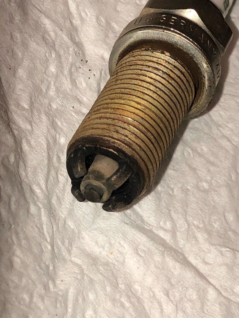

All 8 coils were split (Possibly originals?) so need to get these on order - Any recommendations?
Also all 8 spark plugs looked like they had a similar level of fouling on the tips.
I'm not sure how many miles were on the car since the last plug change (If ever?) but wanted to ask the forum how these look (No oil or wetness on any of them).

Thanks, that really helped. Oh, while you are in there make sure you clean out those drains. one on each side of the front wheels and one under the dash inside the car. I didn't and now I have to buy a new passenger side carpet for over 1k (they cost retail 1325.00).

Those plugs look bad. Probably originals. Easy fix. Good there is no fluid on them though. I thought they had fixed the coil pack issue ? I had that issue in my old 2004 Cayenne.
