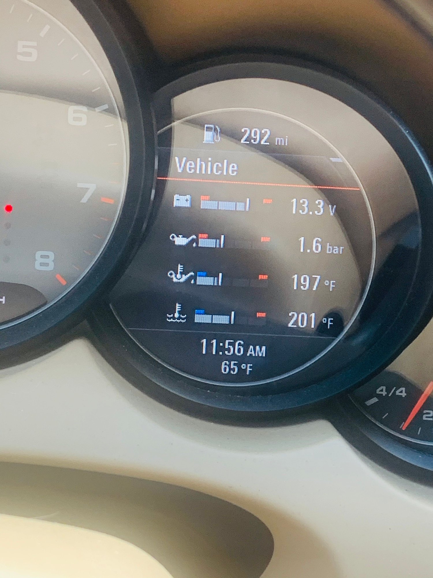

New battery installed Saturday I wanted to see if you all thought this looked ok.
Should I purchase the Suncoast Porsche special at the moment
https://www.suncoastparts.com/product/PK958TTCOILS.html
$384 for the 8 pack and get to work with YouTube and my iPad replacing the coils? Thanks all for your valuable input.

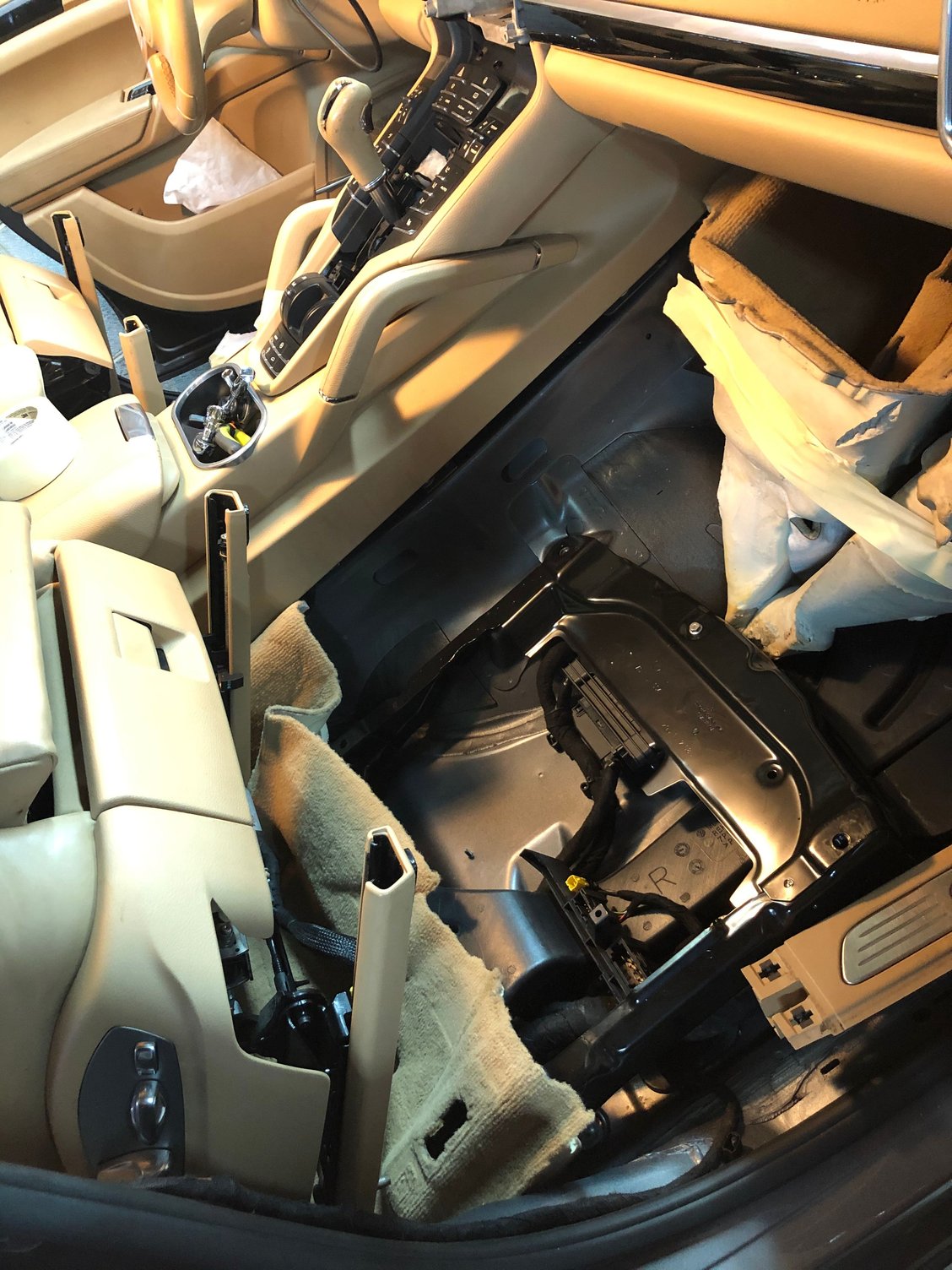

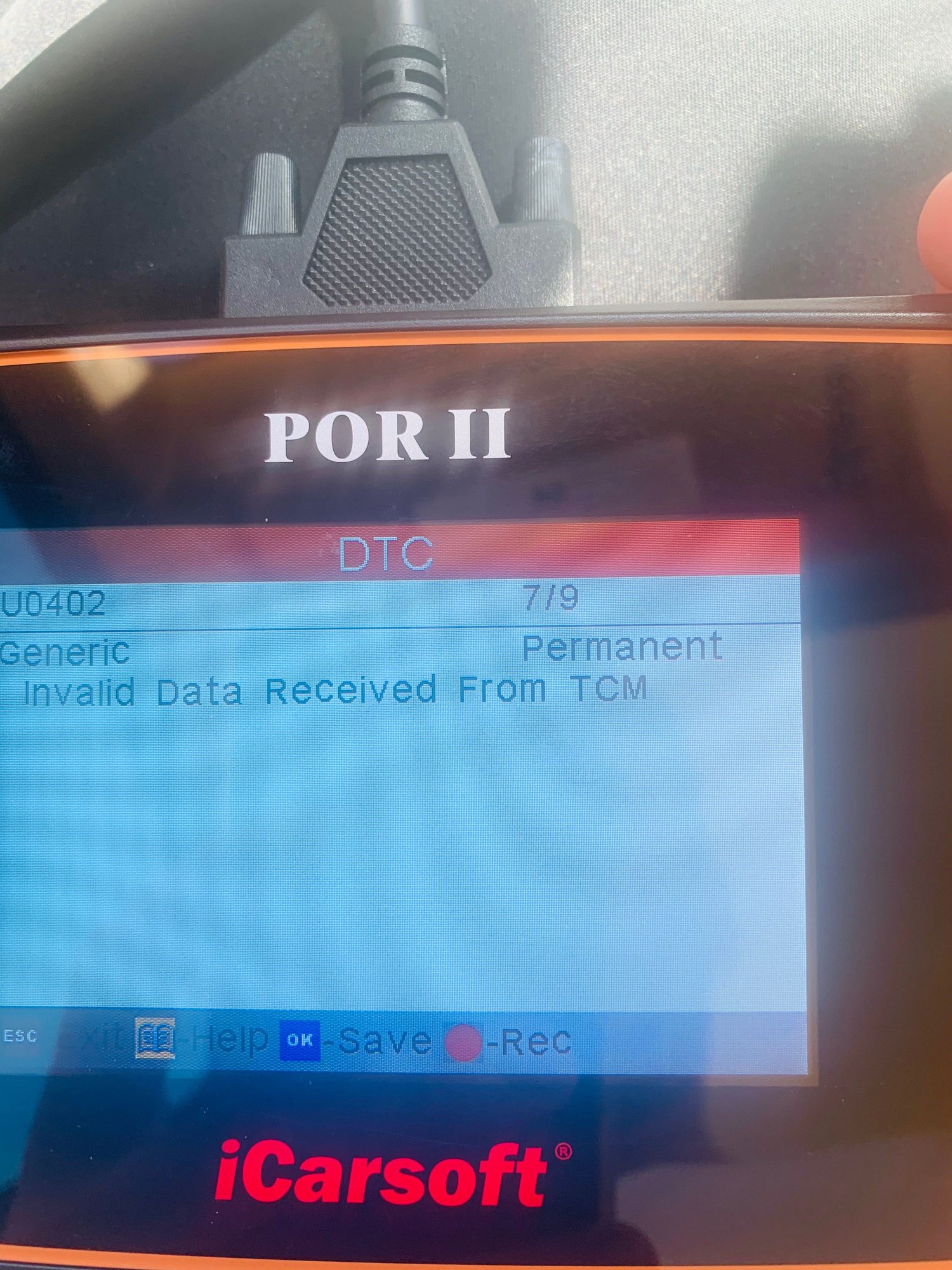

The invalid signal from TCM is interesting. the TCM is located underneath the passenger seat so have a look for any wetness or damp areas in the footwell. It seems strange to me that you would lose 2 coils without warning...

Hey TJ.
No the sensor In the tube I think is just for the cabin air temperature. The TCM (transmission control module) is underneath the passenger carpet.
heres a picture when I had to check the wiring on mine:

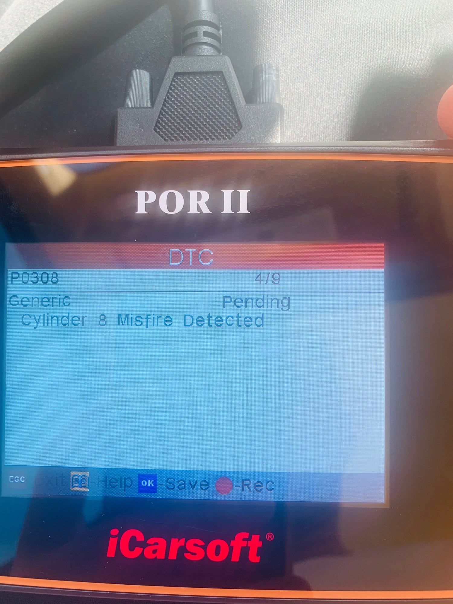

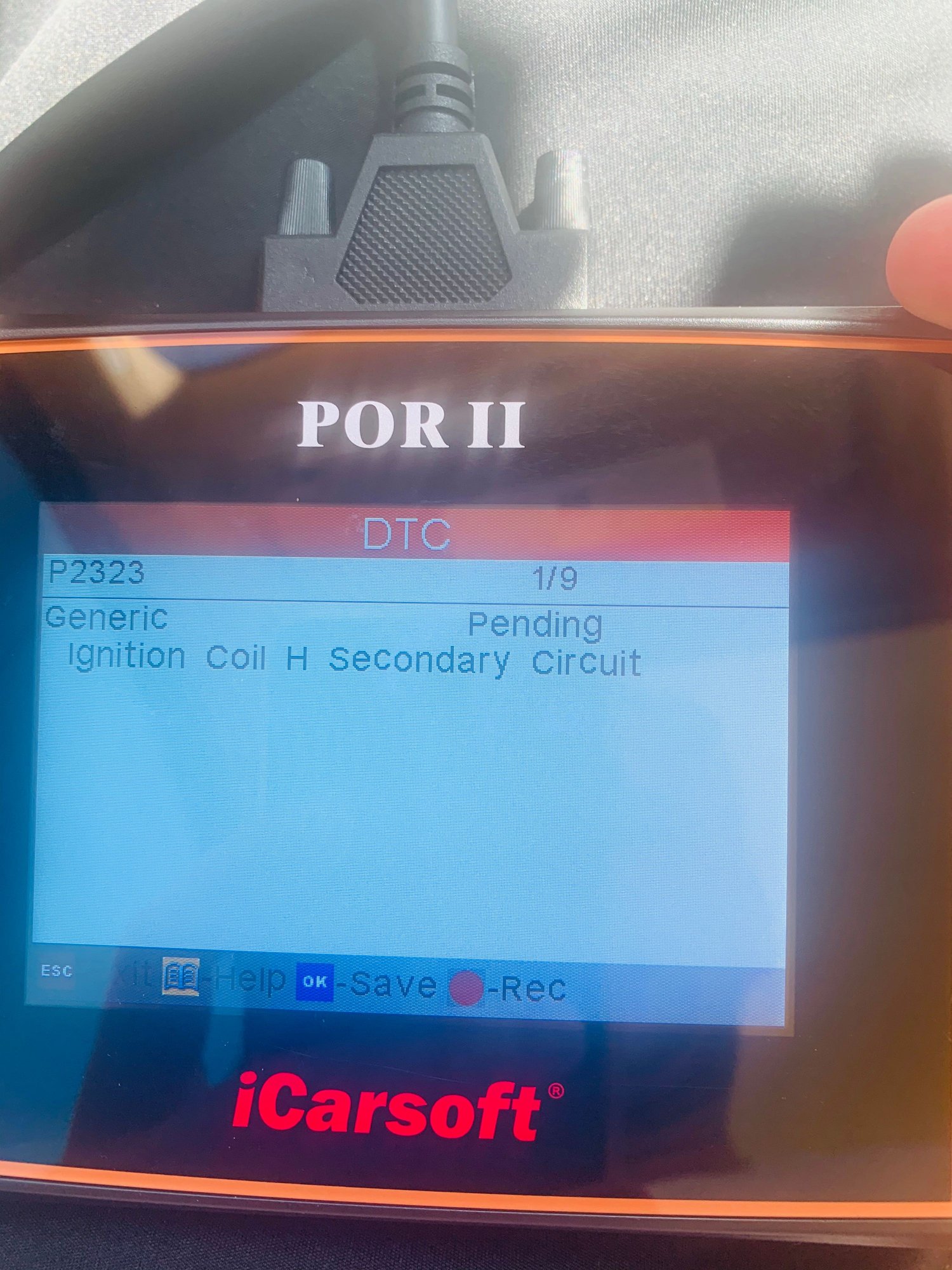

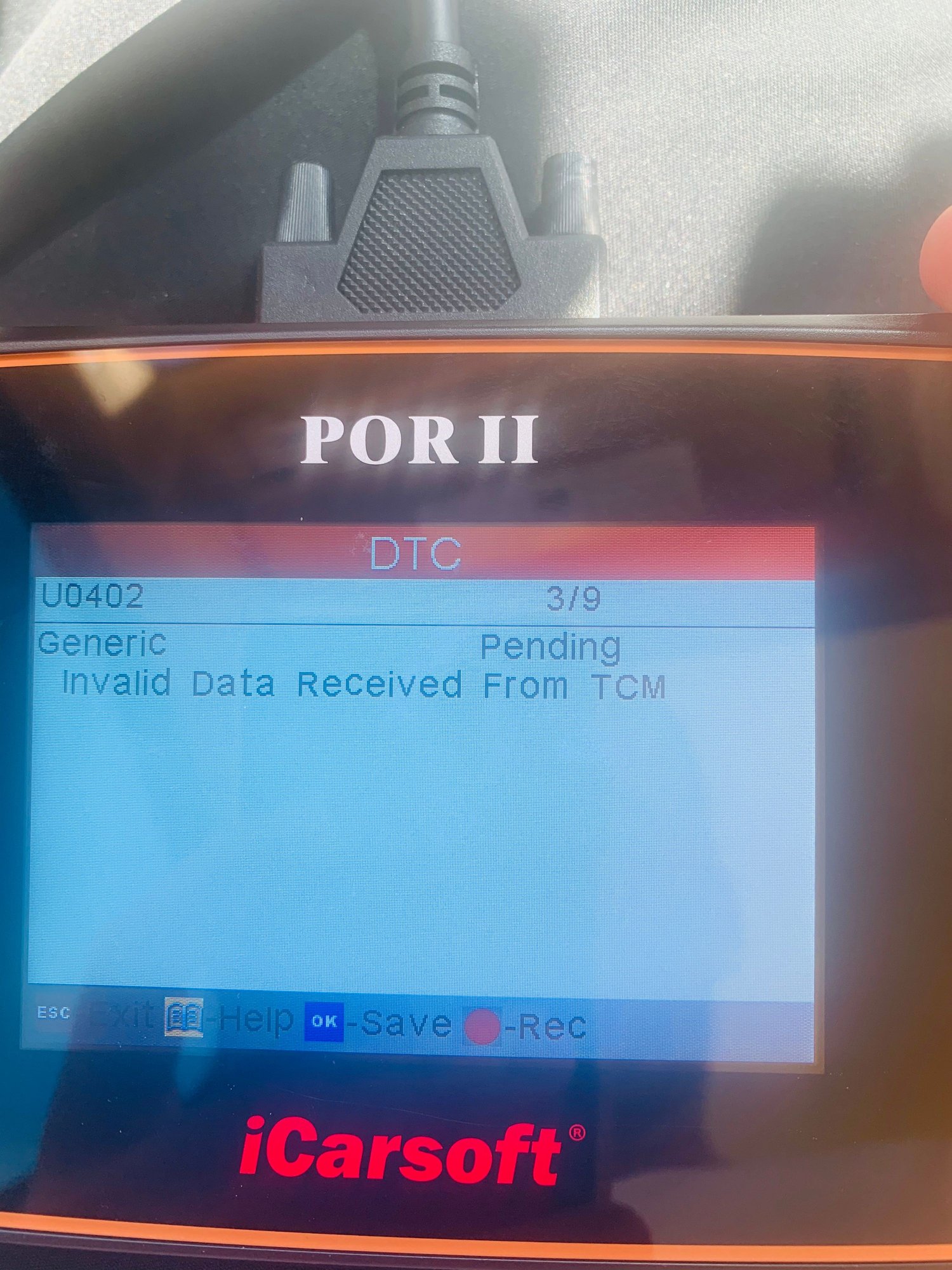

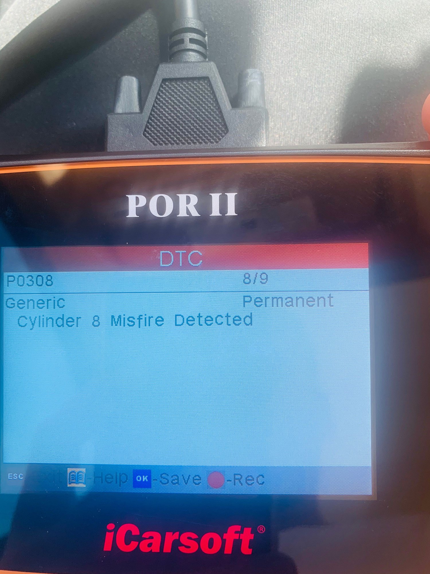

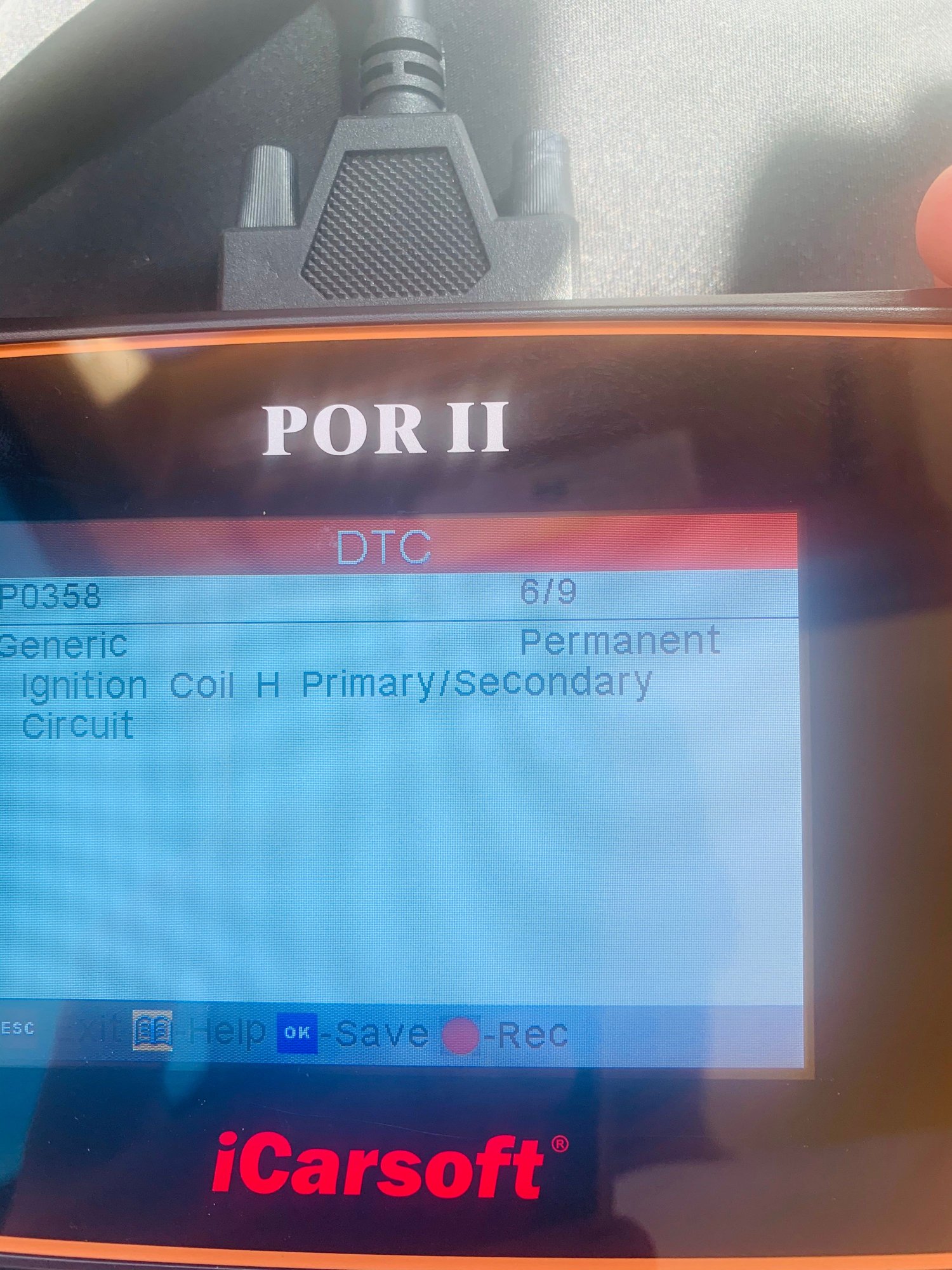

Symptoms are getting worse. Could the newly installed battery have anything to do with this or is is just a really bad coincidence that this happened the same week? Multiple misfires now each morning for the past 3 days and today was the worst day so far. Here are all the codes.
P2323 Ignition Coil H Secondary Circuit
P0358 Ignition Coil H Primary / Secondary Circuit
U0402 Invalid Data Received From TCM
P0301 Cylinder 1 Misfire Detected
P0308 Cylinder 8 Misfire Detected
P2323 (Repeated) *Pending
P0358 (Repeated) *Pending
U0402 (Repeated) *Pending
P0300 Random / Multiple Misfires Detected
P2323 3rd time
Thanks all for your help. I guess I have no choice now but to take it to Porsche.

Hi TJ. It guess it’s possibly battery related.
Do you have a battery charger? Try charging the battery and see if it gets any better.
your voltage looks normal based on your dash so I’m not sure - but it is strange it happened a week after you changed it.

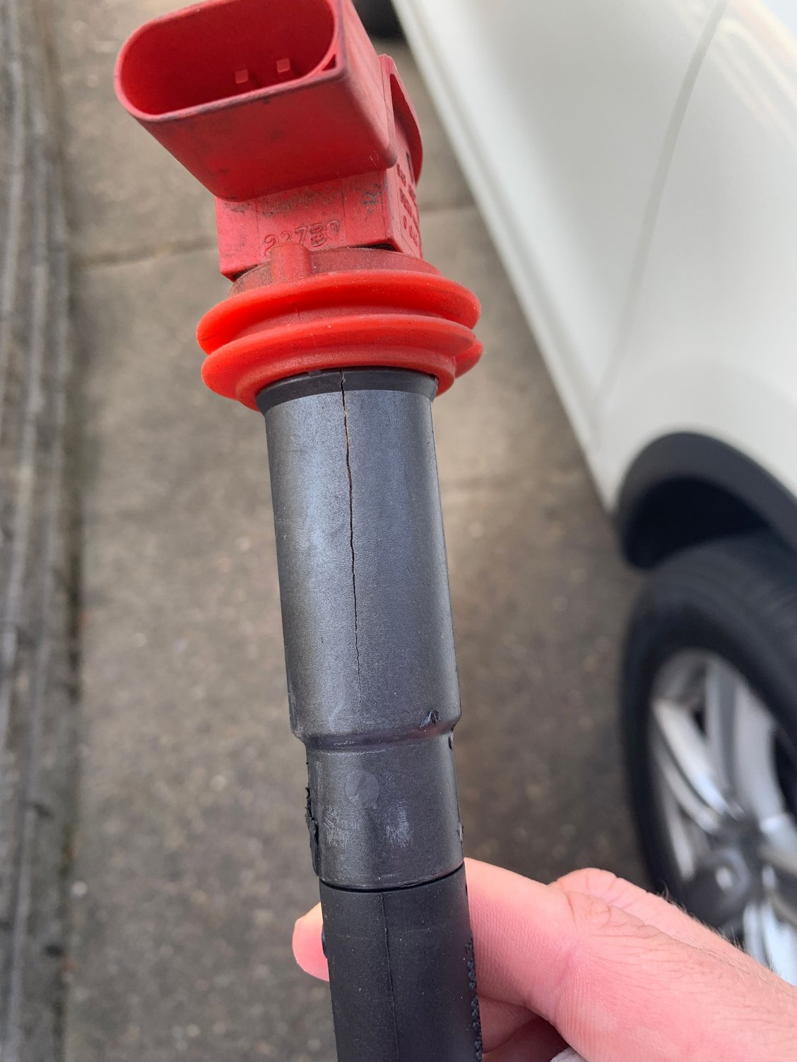

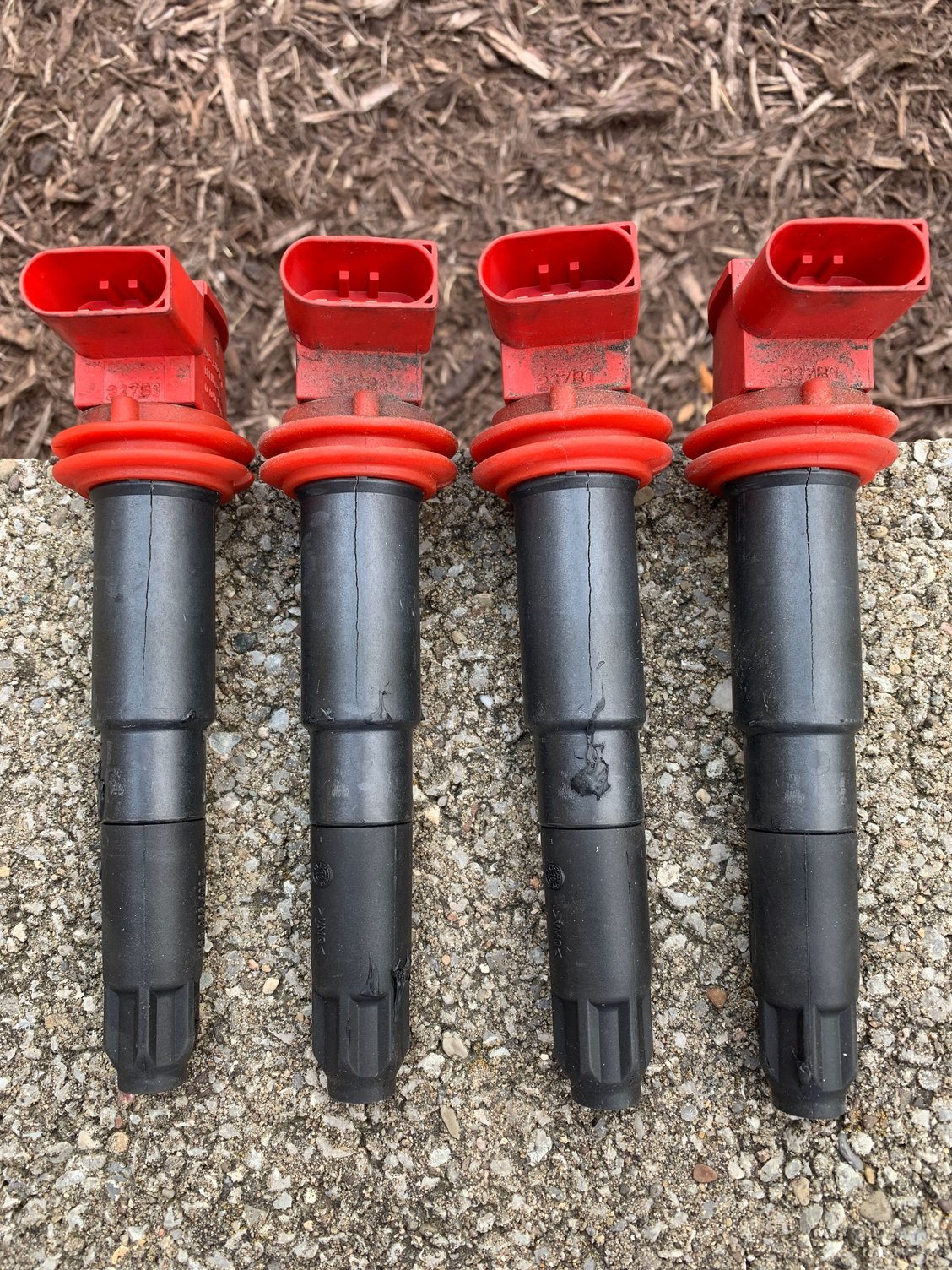

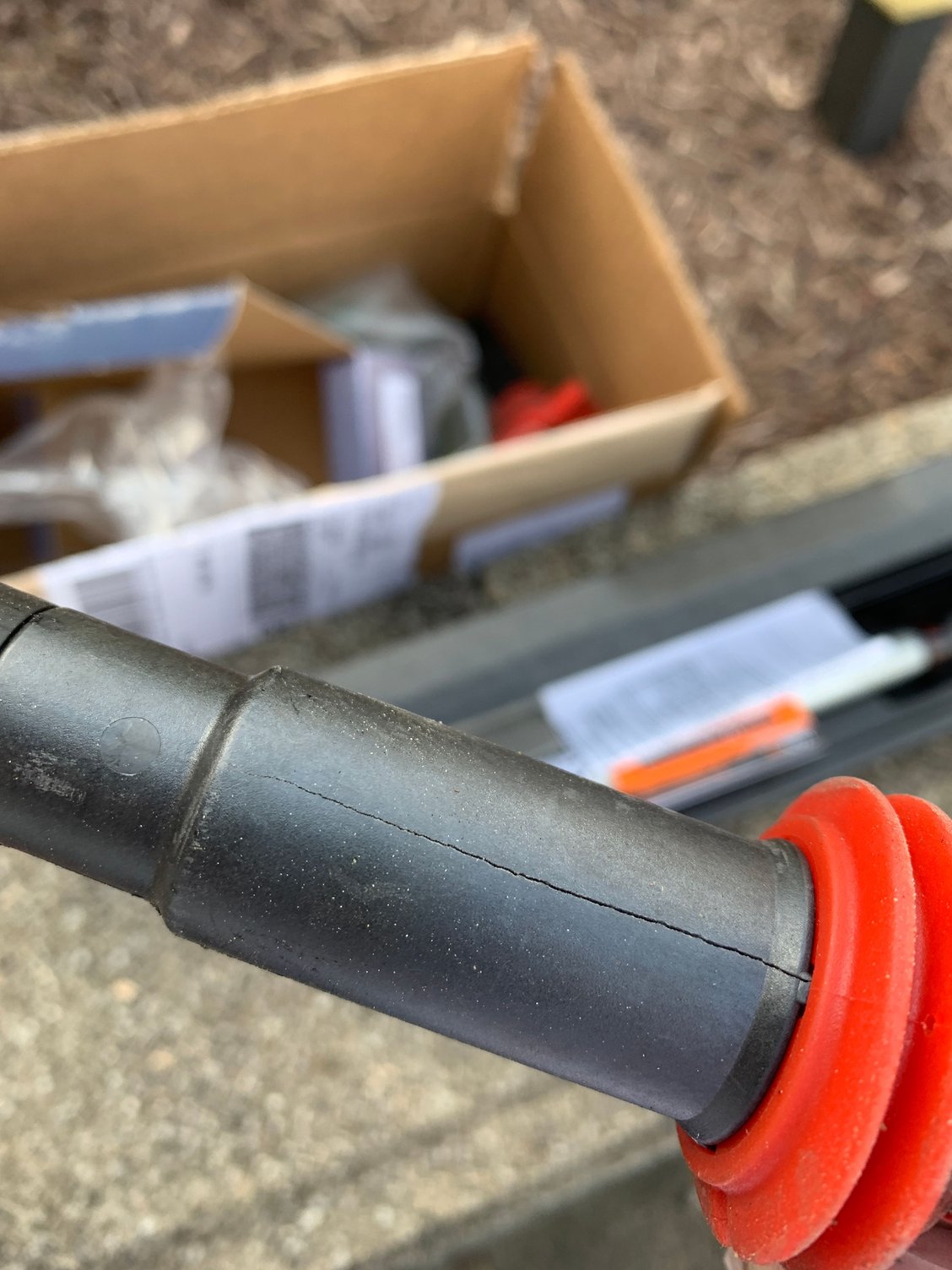

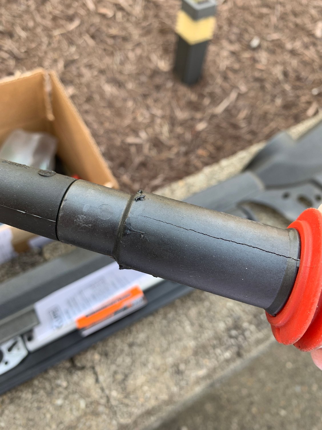

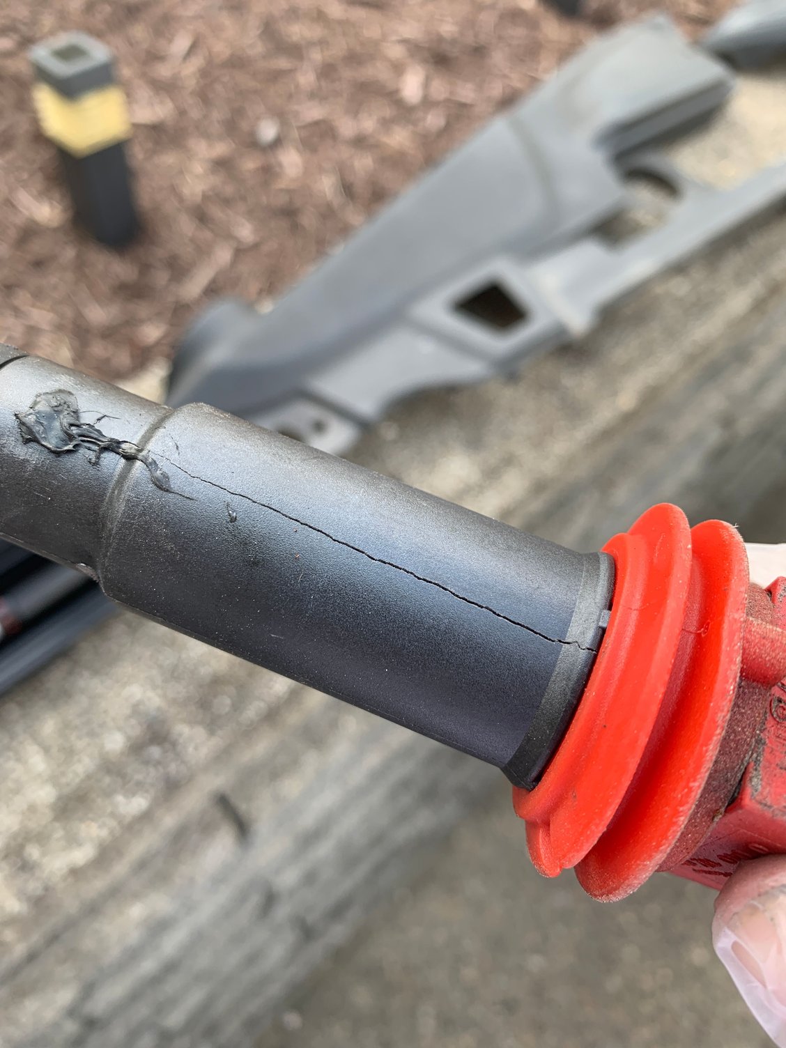

Coil swap
Doing this now. I started on the driver side at cylinder 8. Guess which coil from the photo came out of cylinder 8? Unreal. Issues gone. CEL off. Just test drove her and she’s purring away. Gotta do the passenger side now. Unreal this was the issues.
Hey TJ, I never cease learning from your adventures!
This confirms what they say about changing out all the coils if you have 1 or 2+ going bad. IIRC the Factory Service Manual &/or Owners Manual has a recco'd service life & change out for the coils, but if not in the OM, then you'll have to call the dealer & get them to look it up for you (60K sticks in my mind, but then I have Half-zymers ).
You can also save any old ones that look good as "test coils" later to swap in (if any are uncracked), if it ever comes up again with mystery codes &/or running issues.

So good to hear from you. I hope you are doing well and staying safe. Cylinders 1 through 3 had good coils on the passenger side and cylinder 4 was bad for a total of 5 bad coils out of the 8. Yesterday I replaced all the spark plugs, the ignition coils on the passenger side and 2 air filters since I was in there and she is running pretty good now. I am just waiting for my driving cyles to make those permanent code fall off my scanner. The engine torque mount was in great shape which leads me to believe it had already been replaced. I also believe that becuase a torx bolt was holding it in place and not the Porsche preferred type. Our Pirates are so awful and unwatchable, The Pens dissapointed us greatly and the Steelers hopes fall on the rebuilt arm of Big Ben. Here’s hoping 2020 gets better. Take care!
