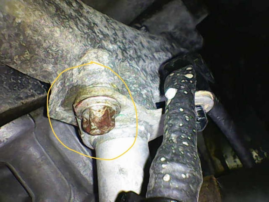

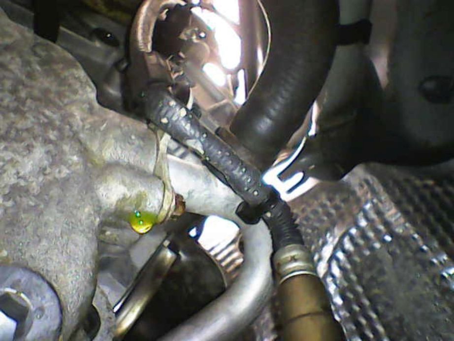

Good morning. I couldn't find a thread addressing this leak (2011-S). Not sure how to proceed to fix. This is on the right rear side of the engine, intermittent leak usually noticed with a small puddle after shutdown for a while. Pics taken with a cheap phone endoscope and noted the leak along with a picture of what looks like the pipe from an ebay item. Looks like the pipe goes from the coolant bridge to the alternator. It would seem that I only need the O-ring, but with only the engine trim panels off I can't see or get my hand in to feel it. Didn't look accessible from the underside with the two covers removed. From the right wheel well the heat shield obstructs access to the area with the liner removed. Anybody tackle this repair or thoughts on what I need to remove to get to it ?? Any replies much appreciated!
