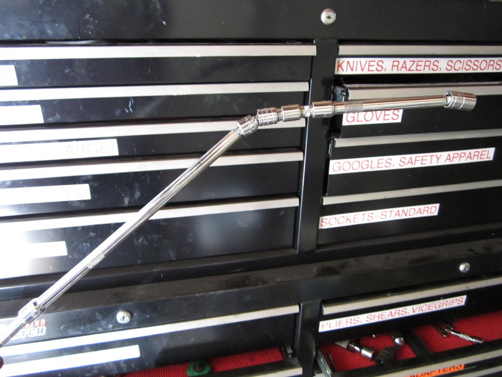

With 100K on the odometer and fresh plugs newly installed, it only seemed appropriate to reward the beast for her faithful service with a fresh set of upstream and downstream O2 sensors, perfectly torqued into a new set of high-flow primary catalysts. She'll definitely breathe better during the next 100K. Here's a shot prior to the install:
Will report more later.

Let us know how it goes. The driver's side should be a snap. The passenger side on the other hand...

These Porsche flanges.... I think you'll be alright!

I have an exhaust thread out there that shows what kinds of tools I used to remove my original cats.
