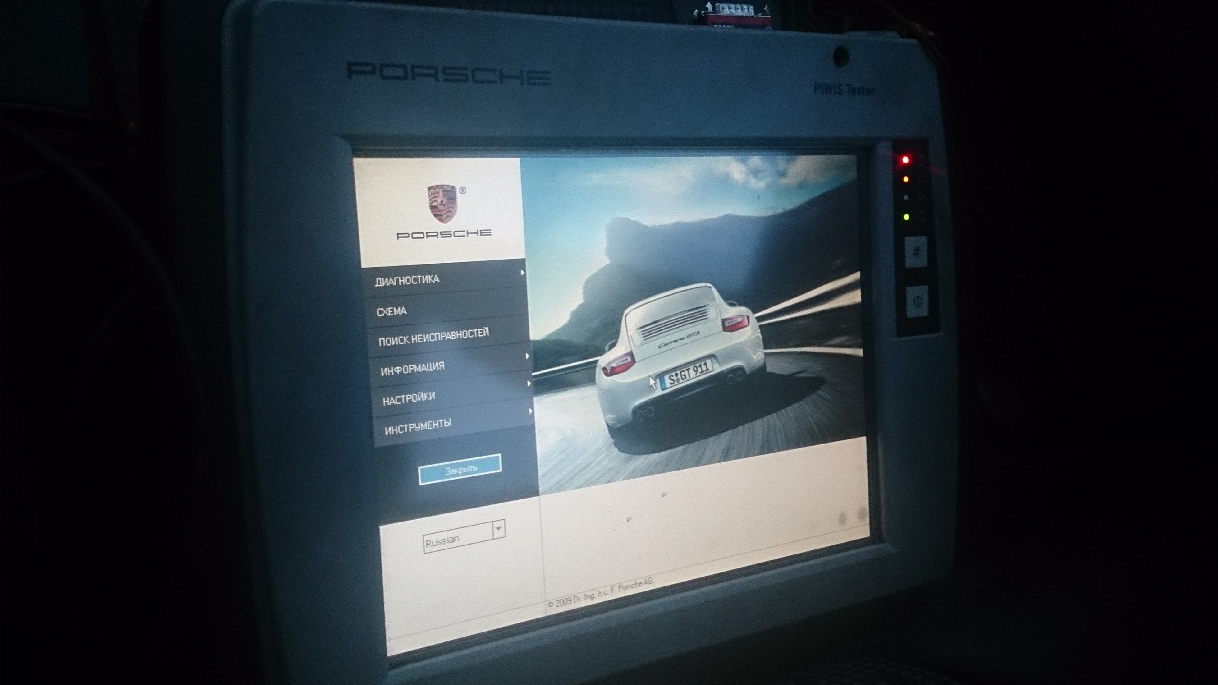

Originally Posted by Tuscani66
My question is, found this eBay PIWIS kit
hi
remember, on my photo - PIWIS (first series, one and only), that you find is chinese crap, in not costs ANY money at all
