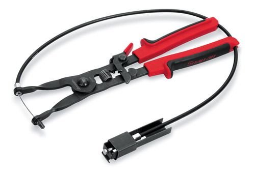

How worried are you about it failing? I replaced mine around 120K miles only because I had everything apart to replace the plastic coolant pipes. There was nothing wrong with the 'T' fitting when I pulled it out.
Now, removing the 'T' fitting SUCKED! There isn't a lot of room to get your arm in there to remove the fitting. Make sure you get one of these:

Wow was this job is a major pain in the ***!! All back together but I will never do that one again.
That bottom clamp is nearly impossible to reach even with the cable pliers. I already had a pair but they actually started breaking you have to pull so hard to get the clamp spread far enough apart to get over the nipples. I ended up having to run to Sears to get a new pair. Worked much better.
