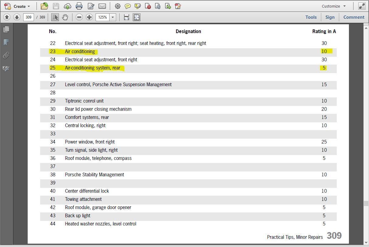

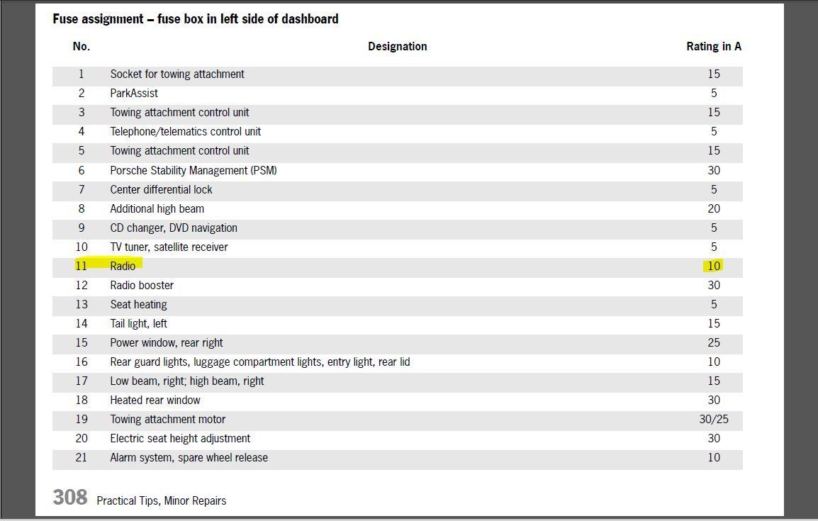

I agree. I took a look at a MY05 Cayenne Turbo owners manual and highlighted all fuses that look like they may be related. Please check these (below) and let me know what you find.
