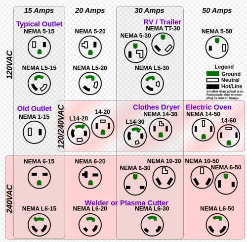

actually doesn't the R just mean "receptacle" vs P for Plug. I think it's the same

strange. Are you sure they are both 14-50s? Maybe pin is not aligned or bent. Can you take pics?

If you are thinking of swapping out the receptacle all together - you don't technically need an electrician. If it was a 14-50 or even a nema 6-50, all you need to do is pick up the appropriate receptacle from Home Depot or Lowes , turn off the breaker, swap the receptacles and you are done.
I had an issue where my wire was a hardwire adapter that came with the vehicle and I already had a Nema 6-50 installed in my garage - Porsche's answer was a $475 new Nema 6-50 adapter to plug into the charger - my solution was a $18 Leviton 6-50 male plug end that I attached to the hardwire pigtails and plugged in. Works like a champ.

This is the 14-50R receptacle.
The 14-50 plug is the standard one from Porsche
Name:	NEMA Outlet.JPG

This is the 14-50R receptacle. The 14-50 plug is the standard one from Porsche
is it this part that doesn't fit? SKUHYBNEMA1450 because it should.

Yes- that is it. I will try again tonight but it appears that the 2 prongs that are parallel to one another are spaced differently on the 14-50 vs the 14-50R
