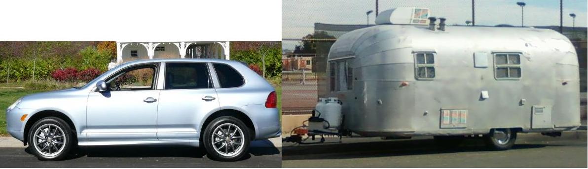

FYI for what we're planning on towing with a CS - the 2nd attached pic is what we believe may be our Avion T20 trailer as used in the 1960 sales brochure (based on how it vs. ours was originally equipped, colors, etc. & that ours is the #2 S/N for their T20); ....
.... While the 1st pic is a cut-n-paste I did to show my wife what an `06 955 CS Titanium Ed. in the Iceland Silver (silvery light blue paint) color which we really like would look like hitched to "her cute trailer," but we moved on from it after Porsche's settlement was set-up to exclude subsequent owners after the Dec. 2014 closure of the program - yet another great customer dis-service move PCNA/PAG!!
Thanx again for any help on this 957 vs 958 Pros & Cons!
PS - for some reason the uploader reversed the order of my pix below, but you get the idea.
PSS - The wet & loaded weight of our Avion T20 is only about 3000 lbs. & is about 22'-6" with the Hensley Cub hitch & 542 lbs with the Cub+Tekonsha Prodigy RF Brake Controller & 2x 30 lb LP tanks on the A-frame - so well within the Cayenne's 7716 lb GTW & 770 lb HW (WD). We'd actually towed it with a rented 2013 Nissan Pathfinder 4.0L V6 with the Hensley Cub, & it's super stable, so should be even better behind a CS!
Tom

DESPITE the flaws - having owned an '06 CS-**** (Titanium edition) that looks exactly like the one in your pasteup - right down to the two tone rims (which I really loved the look of) - I much prefer the 958.
