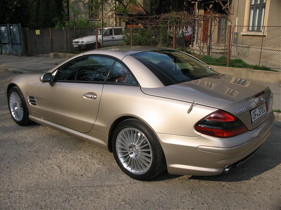

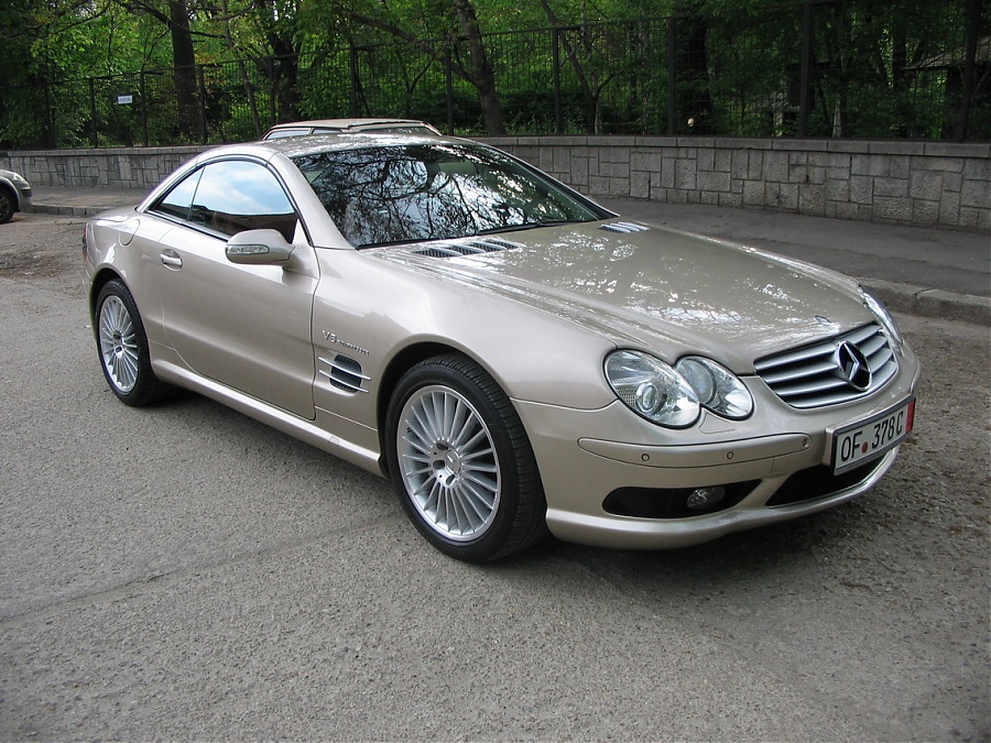

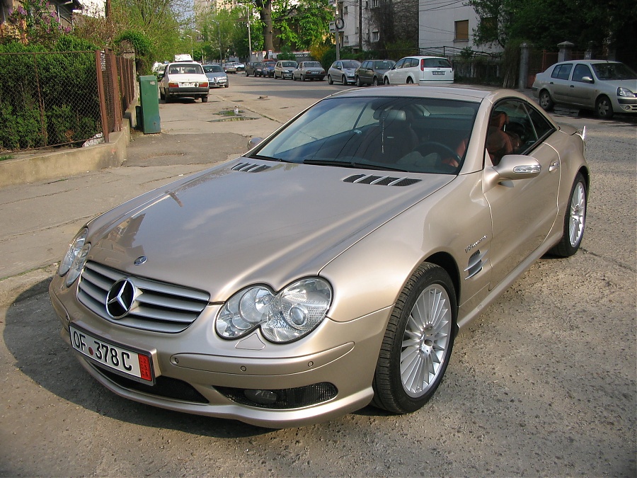

The car has no deep scratches, only light swirls. I always detailed my interior but the exterior has been under alot of chemicals : No touch washing But not anymore ! With your help and years of experience and my will to learn and start taking care of it "The proper way !"
Here are some more pictures with the sun hiting the paint. I have no ideea what the paint is called. In my registration it was marked as Yellow but it's more like a goldish, champagne when the sun hits it.
