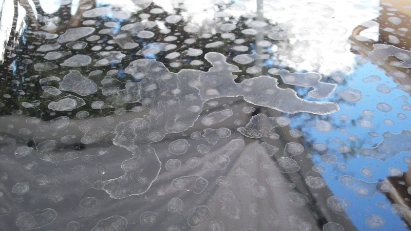

Old Apr 20, 2009 | 07:55 PM
Tito's Avatar
Joined: Jun 2004
Posts: 576
Rep Power: 59
Tito has much to be proud ofTito has much to be proud ofTito has much to be proud ofTito has much to be proud ofTito has much to be proud ofTito has much to be proud ofTito has much to be proud ofTito has much to be proud ofTito has much to be proud ofTito has much to be proud of
I have provided a photo, do they look similar to this ?
