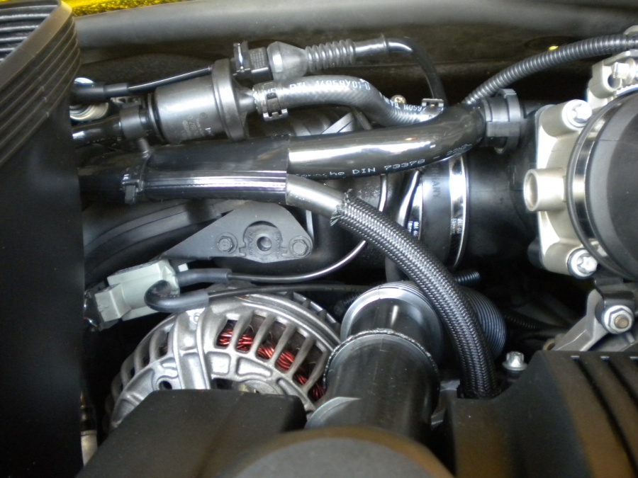

But aren't the alternator and electrical plugs still dirty?
I detailed my much, much smaller 997 engine compartment last weekend. I didn't cover anything and applied my cleaner to the dry engine compartment. To rinse I also used a very low stream of water (since it wasn't that dirty to start with) and avoided spraying into the air intake. I then hand dried everything before applying the dressing. So, in other words, I only sprayed the engine compartment once and lightly at that.
I had no problems with any of the electrical items afterwards. I would think that covering the alternator and electrical plugs is a more important step if you're going to use a blow drier in order to avoid forcing water into areas where it probably wouldn't normally be able to reach.

As requested. I think the engine compartment looks like new even though the the car is 7 years old car and has 37,000 miles. Since I've only driven it for about 5,000 of those miles, I have to give a lot of credit to the two previous owners. I wonder if the engine being in the rear helps keep it cleaner than a front engine car.
Also, I've admired the ability of the professional detailers on this forum, like yourself, to accurately portray the condition of a car in photographs, so I tried to follow your lead and show the cleanliness of some of the nooks and crannies.
