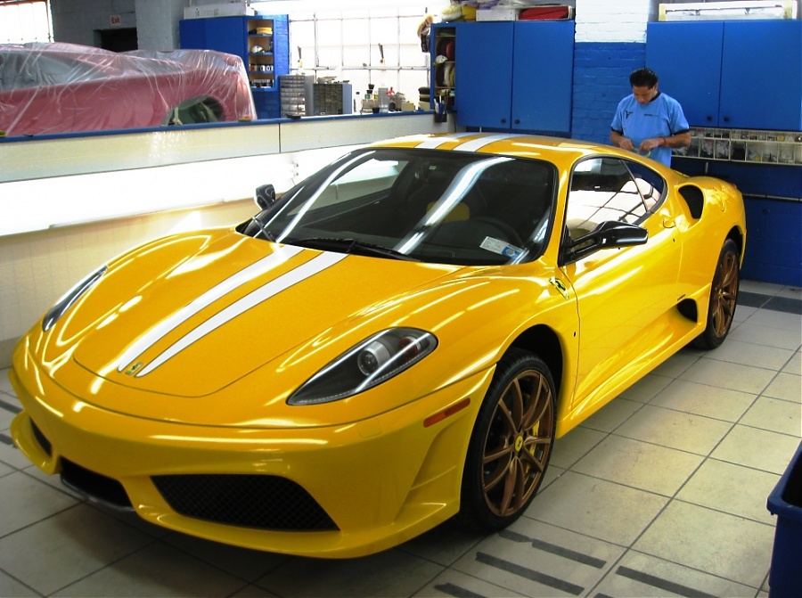

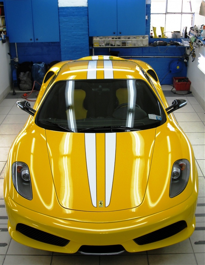

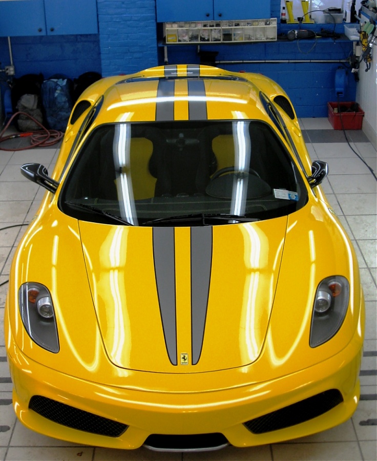

The client wanted to have the factory gold/white stripes removed and replaced with grey/black ones. Also, gray wheels are on their way as well as 50% carbon tint. Let me tell you, it is a MAJOR PIA to remove the original stripes. Enjoy guys.

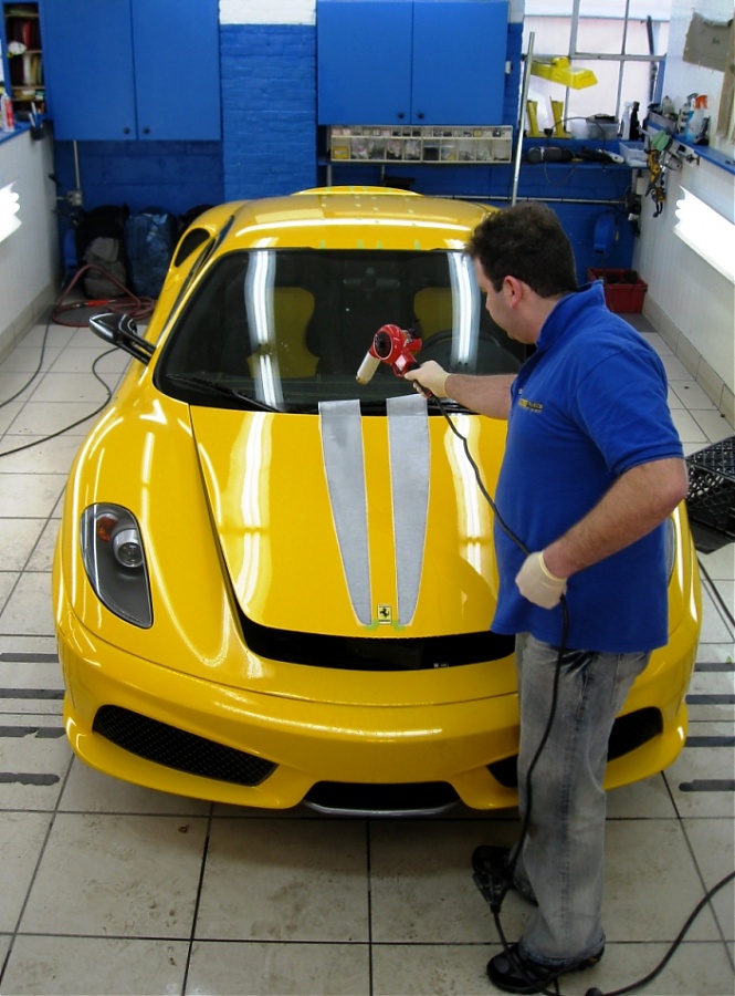

So you just heated them up and peeled? What the hard part, getting the glue residue off? That's a big stripe so there was probably a lot of residue.

The challenge was that the glue was stronger than the actual material. We tried warming it up gently with a heat gun as well as an infrared lamp. In some places the film came off easily, in some places not.

Yes, the is the 2nd owner. We use SunTek carbon tint. The glue residue was temoved with 3M's Adhesive Remover.
