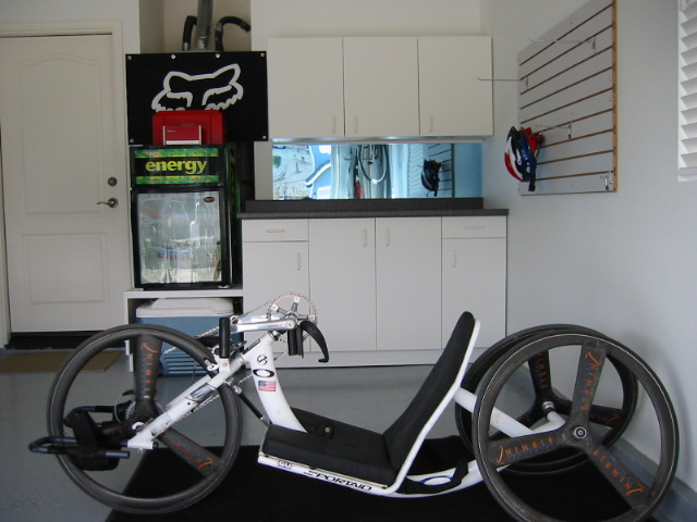

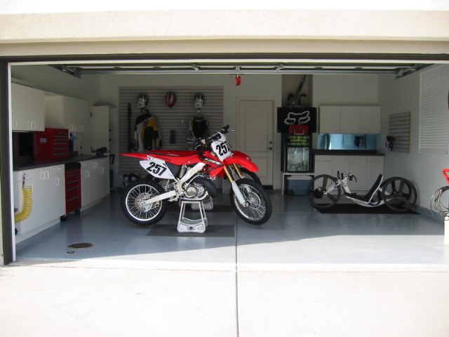

I flew out to California to build out my friend's garage. All I had was my tool belt and a borrowed circular saw and cordless drill. I am a finish carpenter by trade, but had to leave all the good tools at home.
First is before pic. My friend is in a wheelchair, otherwise he would have done it himself.
About $1400 for materials; and maybe 3 days of work. A big improvement anyways.

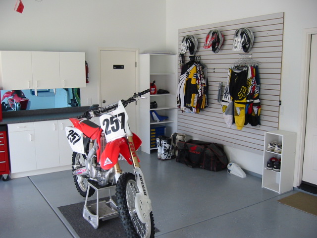

The cabinets were from Lowes, and came in a flat box...assembly required but cheap. The base cabinets were a unit 72" long and the wall cabinets were a 54" unit (all for laundry room use).
The counter top can be bought up to 12' long, but we added a layer of plywood beneath to give it more strength. The slat wall is a specialty item and a little harder to locate. The mirrored back splash is lexan, I don't think real glass mirror would last long in the garage.
The total materials cost was really cheap compared to metal cabinets, and each has merit due to budget and intended use. Some kind of stainless counter top would last forever, but then the formica is replaceable for cheap money if needed some day.

It's always great when you can help a friend, isn't it? Looks like you did a fantastic job! That trike in the last pic is awesome!
