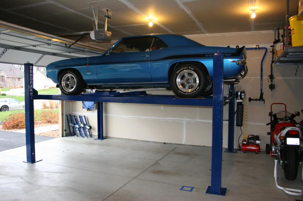

I've had a Bend Pak scissor lift for a couple of years and have been very pleased with its versatility.

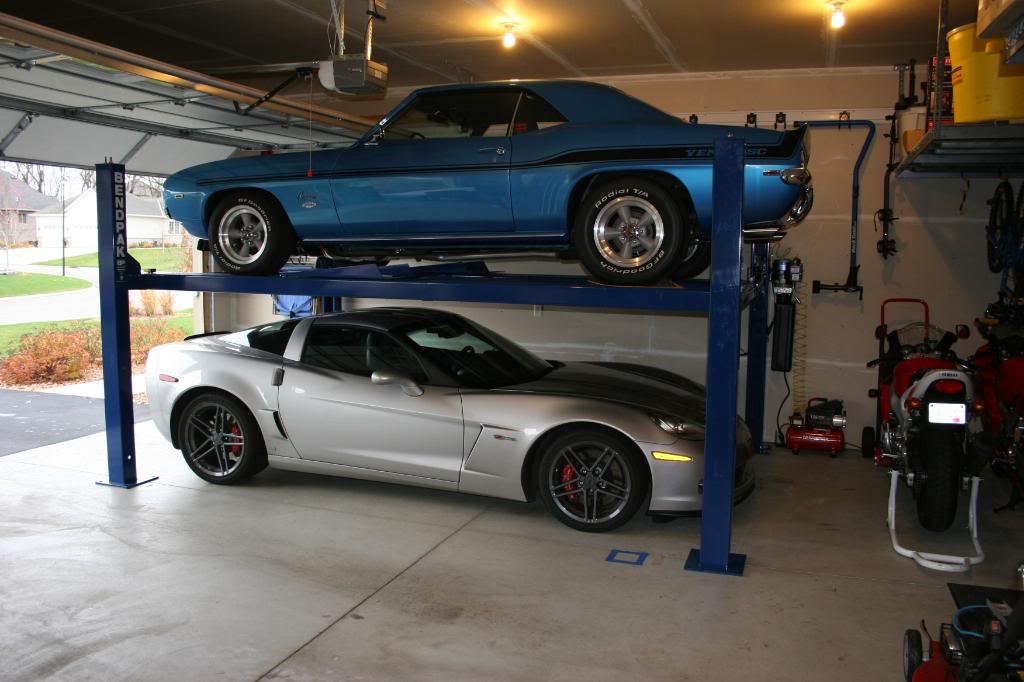

Since winter is coming, and my garage is filling up with snowmobiles, I thought it would be a perfect time to 'justify' buying a 4 post lift to stack my Z06 and my Camaro for the off-season.
The lift is a Bend Pak HD-9 (the wider of their current options).
Rough dimensions are 121" wide (outside to outside) and about 174" long (excluding the ramps). I contemplated buying their 'ST' version that is about 103" wide, but that version wasn't wide enough between the crossbeam supports to fit the 76" (tire) width of my Z06. Close, but no cigar.
I bought a 110v for versatility - I'm planning to have a winter layout and a summer layout for the garage. FWIW, a 220v is also available and is supposed to raise the car faster. IMO, the 110v is plenty fast, raising my Z to the top safety lock in about 55 seconds.
Max lift height is 70" which gives you about 78" to the bottom of the car (5" for the ramp height and 3" or so of normal ground clearance).
My ceiling height is 121". The pic below shows the Camaro and the Corvette on the 2nd to the highest safety stop - it could go up another 5" or so, but the hood of the Camaro would hit the garage door.

Here are some pics of the Z/Camaro on/under:

All in all, I'm very happy with it so far.. I should have bought this 5 years ago.

Looks good, I'm glad to see the X5 fits on it, but it appears as though nothing would fit under it with the x5 on it.
You are correct - nothing (I own) would fit.
When we built our house, I should have had the sense to have 12' min ceiling height.. oh well.
The good news is that the X is my daily and would never be 'on top' of anything else. I also don't have to do any maintenance on it, so it won't likely be on the lift very often.

Nice! Looks like a cozy fit! Is it a pain to get in and out of the Vette with the car parked above? Hit your head yet? My garage ceiling is pretty low too and I'm still on the fence about putting in a lift.
Actually, I hit my head pretty good yesterday grabbing something out of the passenger side of the Vette.. It's something that one has to get used to.
Re getting in/out, it's not too bad. I have enough spaces in the garage that I won't be parking underneath the lift with the Z in the summer, but even if I had to, it would be fine.
Re the width, they do make a less wide version (-ST) that would work for most cars. My Z has too wide of a footprint in the back to clear, but most other (Pcars for example) cars would fit easily (like my Camaro - tons of room).
10' is plenty high for most cars that you'd want to work on - X5 types notwithstanding.
If you're going after a service-type lift, a scissor might be a better 'fit'. I love mine.

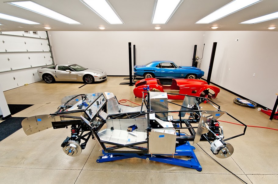

I bought another BP 4 post for the shop.. this is the taller/longer HD-9XW.
The MD-6XP scissor is now serving as jackstands for my Factory Five project.

Well done! Love that shop picture best of all!
