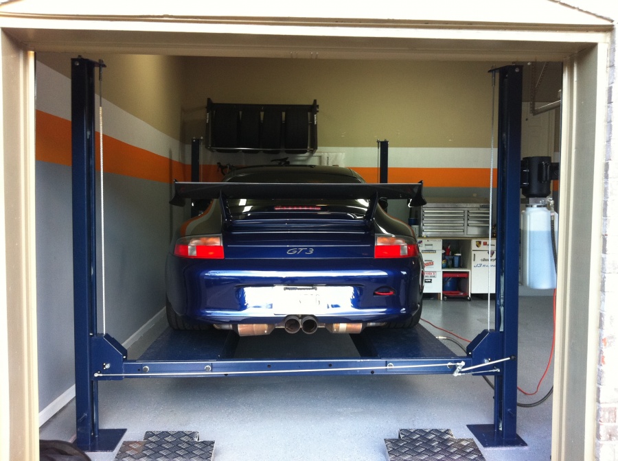

I went with Epoxy recently. It was clean and easy, just let it dry for 5 days...
Recognize my Garage??
