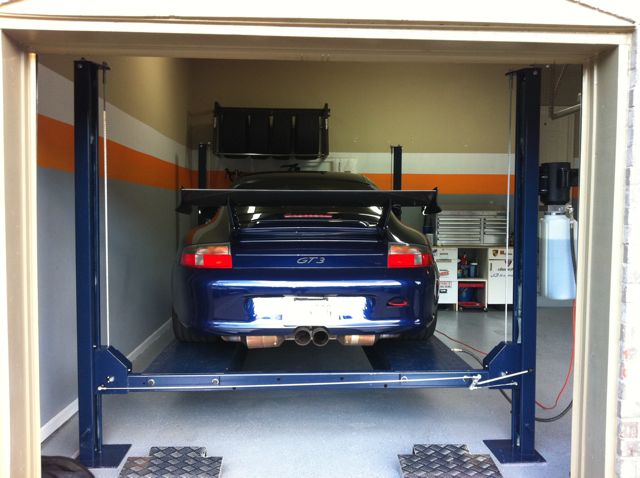

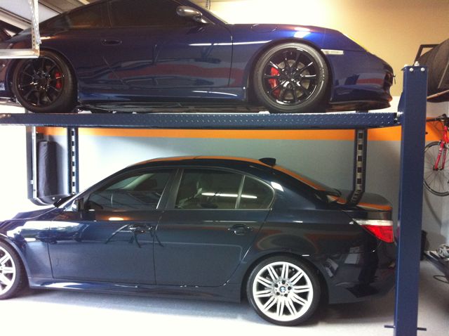

I recently did a lot of research on this subject. I needed the room to stack cars and also liked the idea of getting the P-car up to a better working height for brakes, suspension adjustments, etc. Lastly I had only 3.5" of concrete so I couldn't bolt it to the floor.
I choose an Eagle lift 8000 model.
- Very simple safe design and well manufactured
- Easy to use for storing
- Strong enough to hold heavier cars
- came w/ Jack plates (use bottle jack or Air Jacks to lift the car off of the lift (servicing wheels sus, etc.)
- Came w/ casters in case I need to move it (trick set-up)
- Aluminum Ramps
- W/ shipping less than $2K

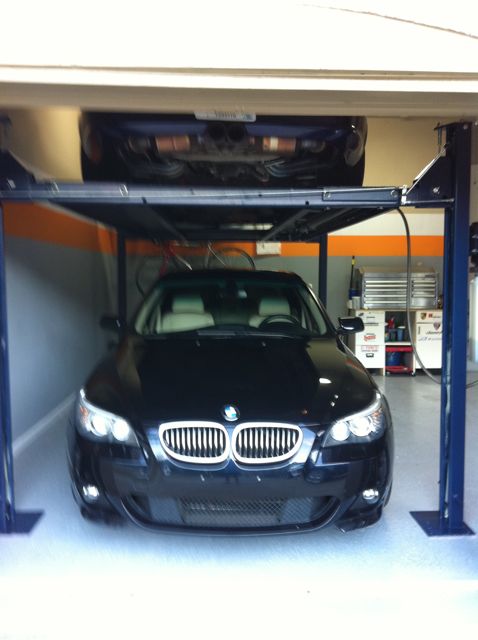

Originally Posted by Rascus
How high is your ceiling? And it looks like you had to remove the mechanism to raise and lower your garage?
Ceiling is 12' and the garage door was rerouted to go higher. In this case to just over 10.5'. Whenever you do that you need to use a shaft driven opener. Mine is made by LiftMaster 3800.. They are slick as ****. All my future garages will have them. Side mount and silent. It also bolts the door shut automatically.
You can see it in the upper right hand corner of the 1st picture. 2nd Picture shows the garage door raised.
From a cost stand point. Getting Garage door rerouted, new springs, etc. $450. LiftMaster 3800 $500.. It has a ton of cool features too.
