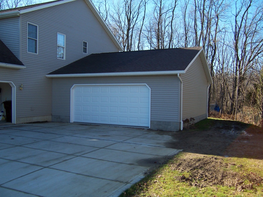

I had a new house built in 2003 and it came with a 390 sq ft garage which i knew was always going to be too small. So I decided to build a bigger attached garage for all of my restoration projects, etc. Township zoning would only let me build up to half the square footage of the house in attached garage so to make a long story short I ended up with a 26x28 new garage. This build takes place over the past 4 years or so and ends up with where I am at the present. Due to my budget, I have completed all of the work myself with the exception of the concrete floor. I hope you enjoy my build thread. Thanks, Greg

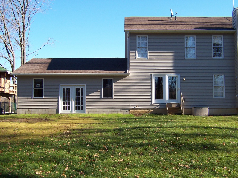

first picture shows the house just after being completed in 2003, with a puny 19x20 or so garage.

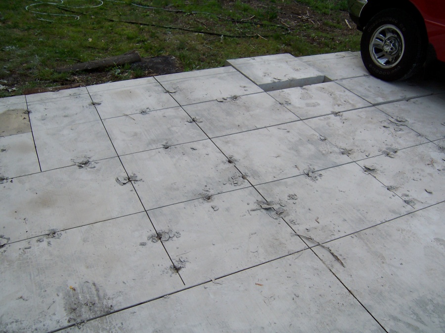

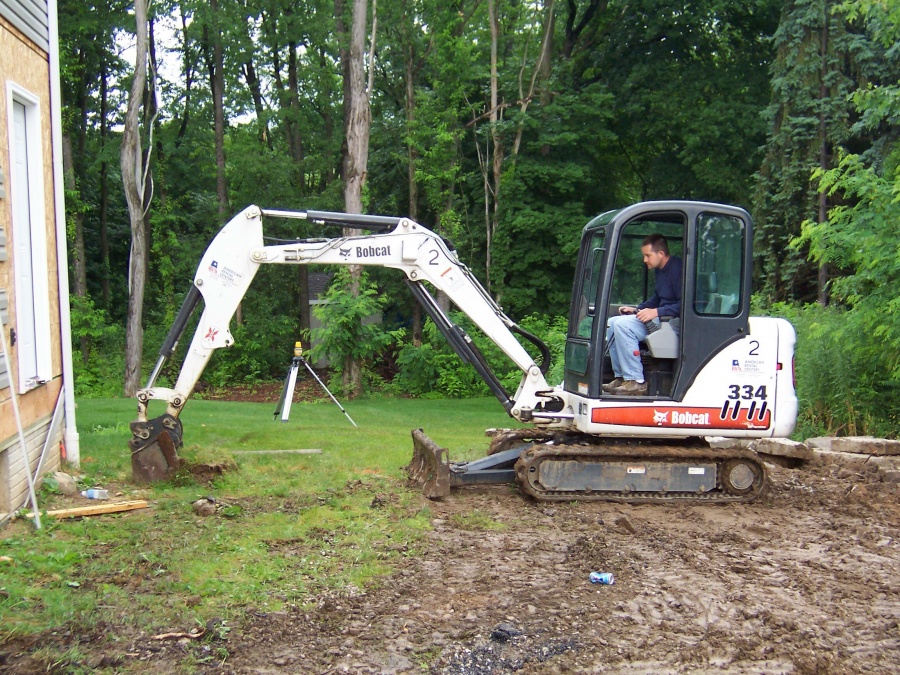

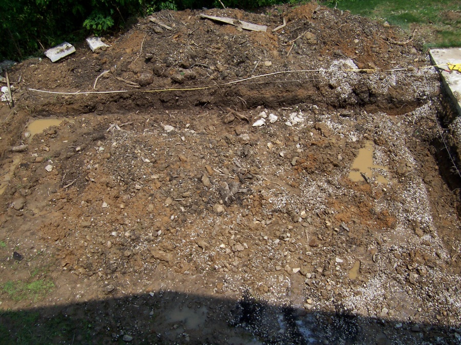

I needed to saw up and remove about 18 x 30 feet of concrete which I did with a rented concrete saw and a small excavator. The concrete slabs were stacked and used as fill behind the new garage. I also used the same rented excavator to dig the footings for the foundation. The day after I dug the footings, we had about 4" of rain. So I had to dig them a little deeper to get all of the mud out for a sturdy pour and let everything dry out a bit.

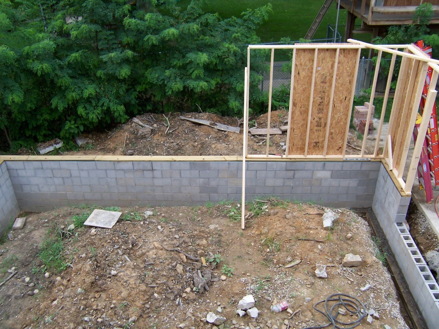

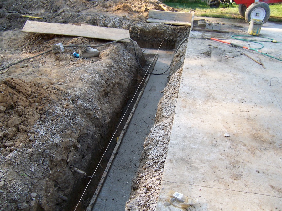

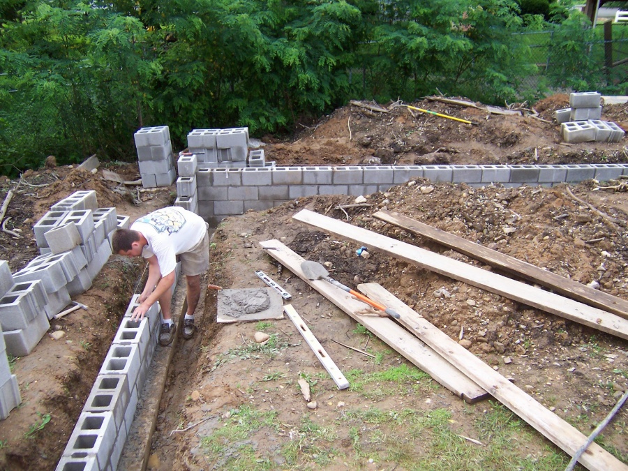

Pouring the footings myself was a liitle more work than i thought due to the fact that i used bags of concrete and a portable mixer because i didnt want a cement truck to crack up my new driveway. the guys that poured my floor used motorized concrete buggies. I took a week off of work to lay the block. first time i ever laid block but im happy with the way it turnrd out and the price was right.

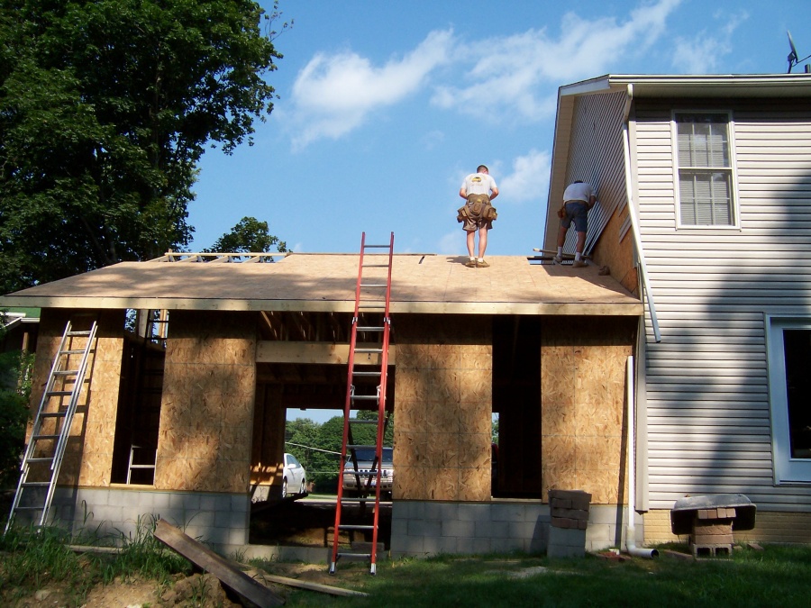

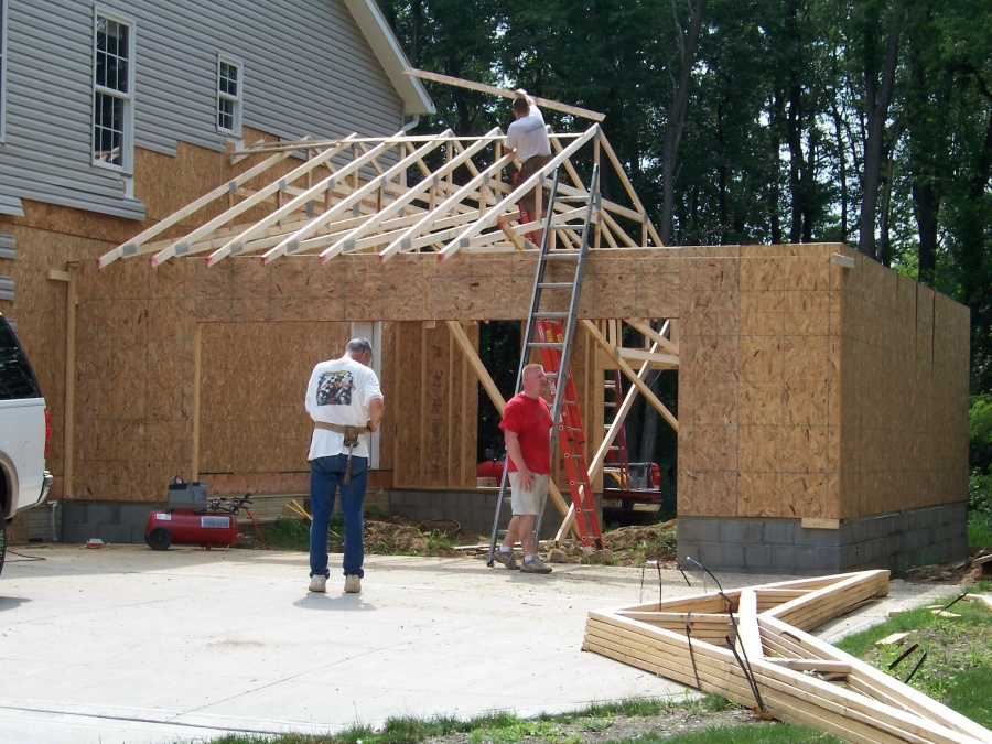

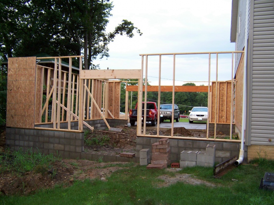

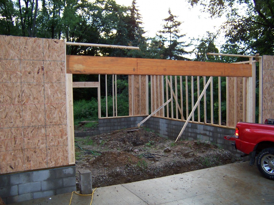

The framing of the garage went faster than expected, since I only had three walls to do. I also did have some help from my dad and a friend setting the 28' scissor trusses for a cathedral ceiling. I wanted nearly 13 foot ceilings for a future lift.

I also shingled the garage in one day, but I did splurge on the rooftop delivery for $50 bucks. Ive carried shingles before and its just not worth the pain to save a small amount of money.

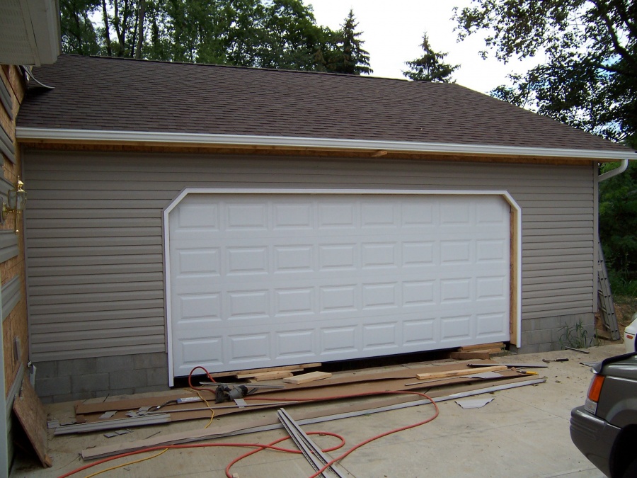

siding, doors, and windows were all that was left to finish it up before winter. Having the garage door with no windows was a mistake. I plan to replace the garage doors on both of my attached garages to ones that have a row of windows at the top. That's pretty much it for the outside. Now to the inside. will post pics later today.
