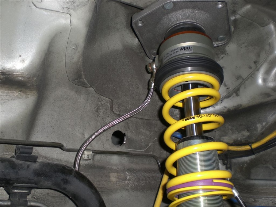

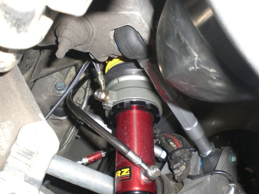

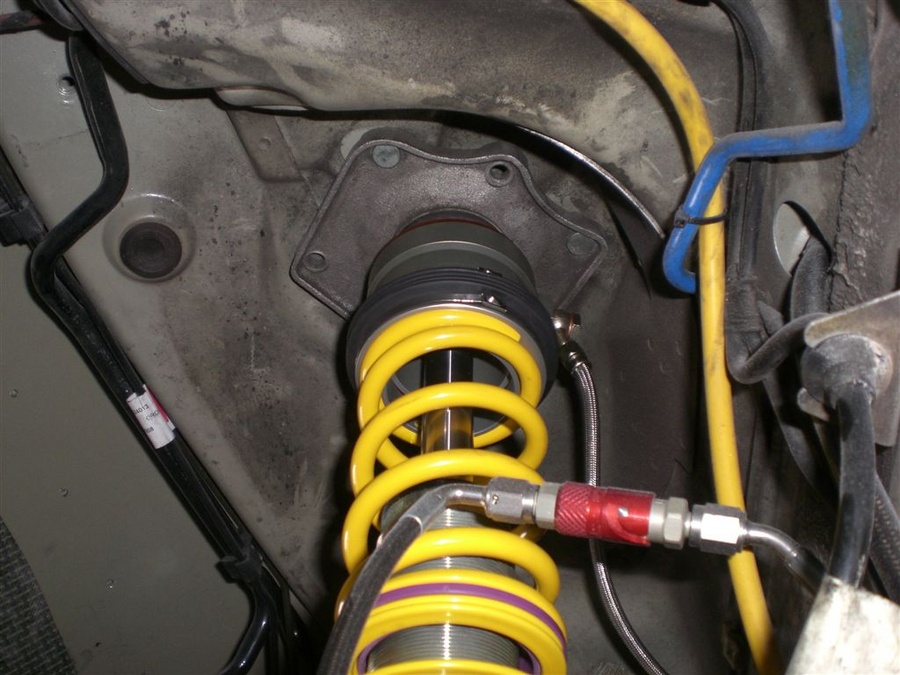

If you are interested in pics of the sytem installed on a 996 GT2 with JRZs, go to the thread "A Very Custom GT2 RSR". However, because of my set-up using 11 x 18 BBS RSR monoblocks in front and 295/30-18s, we had to fabricate a custom hat and install the hydraulic unit on the top of the coilover due to wheel clearance issues. Still a very cool kit.

We have installed the system on my car and it works fine, however, when raised it would immediately lower itself. Found out that the control unit has wires that connect to the CAN signal in a 997 that control the auto lowering at a certain speed on the 997. 996 is different and required different control connections. Sam at Auto Talent was very helpful in connecting us with Klaus, the owner of KW, and they immediately created a resolution and have sent a new control box. At this point, I think the system will work fine from a controls aspect. If so, they now have a proven approach to those of you with 996 turbos. It is a VERY high quality system for those of you who are interested. PM me if you have specific questions, or call Sam at Auto Talent in LA.
Please note that we had to install the front unit on the top of the coilover versus the bottom as designed. This is only specific to me because we are running the RSR monoblocks and a brake cooling system, both of which create serious clearance issues. If you are running the stock clearances, even with custom wheels, then you should be fine with the installation at the bottom of the coilover.
