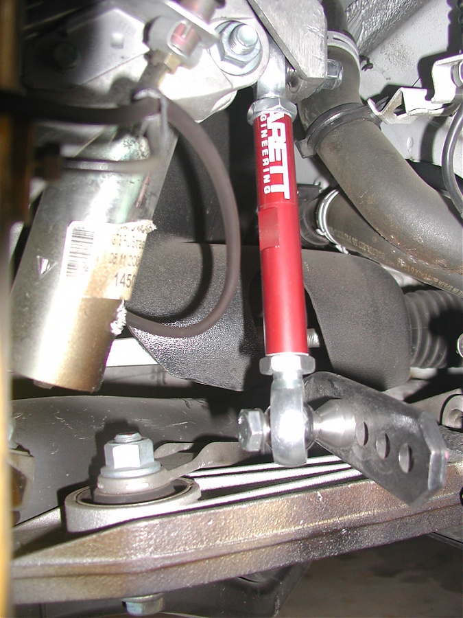

all four of my droplinks were loose from the factory and the stealer...easy to check for yourself...for the fronts just turn the front of the wheel in toward the center of the car and reach in behind the wheel to check droplink...here is how the link attaches to the sway bar, although my links are aftermarket...for the rear look in from behind the wheel and you will see the sway bar...Name:  links.jpg

great...glad they took care of you...you will find the handling improved (less body roll) now that the links are firmly attached to the swaybars
Are you running the front one up from full soft??
