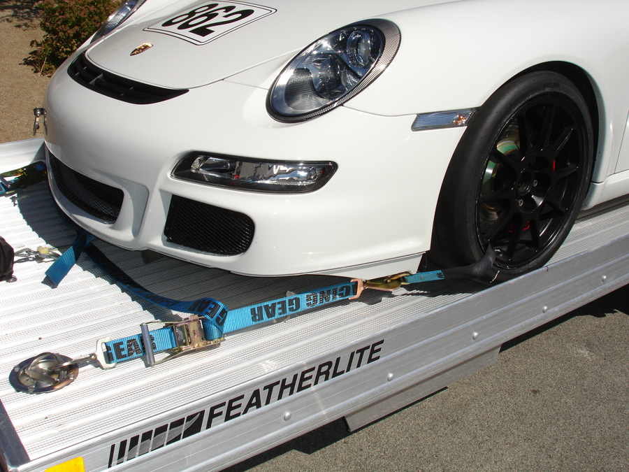

You didn't say if you are going to use an open trailer or a closed trailer. For an open trailer, you would use the Rennline hooks in the photo below, but bend them slightly down, about 30 - 45 degrees, so that your strap hooks will clear the sway bar. Be sure and cross your tie downs in the back so the car will not shift on the trailer.
For the front, the easy (and secure) way to do it is to use through the wheel straps. The ones made by G-Force are padded, so you have no possible damage to your wheels. See the attached photo below.
I have used this setup for two seasons now - no problems whatsoever.

I used the Rennline 45 degree hooks in the rear I installed them where you have depicted next to the sway bar. I then bent the hooks slightly to increase ground clearance. I use 4 straps in the rear one set one set forward and back the other set crossed. No hook option for the front, I use through the wheel straps with padding works fine. You can also put a strap on your tow hook in the front for comfort.

Here is my setup for the RS
