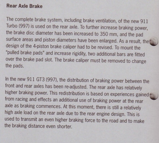

I am looking for pictures of 997 GT3 Rear Brake Calipers, particularly the back where the pads are removed. I have tried the search but couldn't find anything.

Calipers must be removed to replace pads

Thanks for the picture.
So what do people do, leave the track pads in all the time? or do they pull them off, replace the bolts?
Why would they be different then the system on the C2S or even the Front Calipers?
Are the PCCB's like this as well?

PCCB Calipers are the same.
Bolts are "stretch" bolts and should be replaced each time.
More info attached

Seems like a PIA, do you leave the OEM pads in, or do you switch them for the track?

I leave them in, but there are those that switch
More info attached
Ah. I've always wondered why Porsche switched to the "closed" caliper design. Now I know. Thanks.
