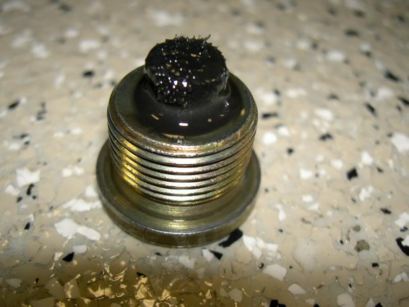

Quick update. It's not a bad idea to change tranny oil after using the new LSD for couple months. This is what my drain plug look like after about 12 + track events with rebuild LSD. Still work perfectly

I've seen worse. It really doesn't look all that bad for a year's worth of track days. However, if you are really getting 12 days a year I would increase your service interval. For a track toy I suggest changing the gear oil every 5-6 events.

There's some good discussion on oils earlier in this thread. My bottom line comment on the subject is service interval, service interval, service interval.
