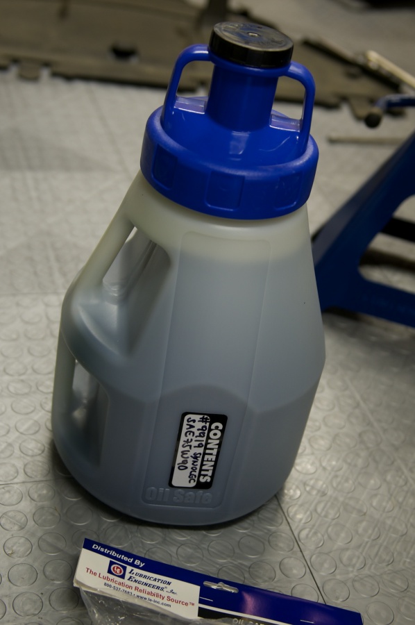

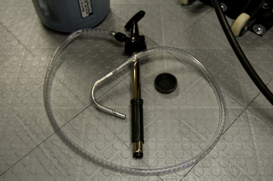

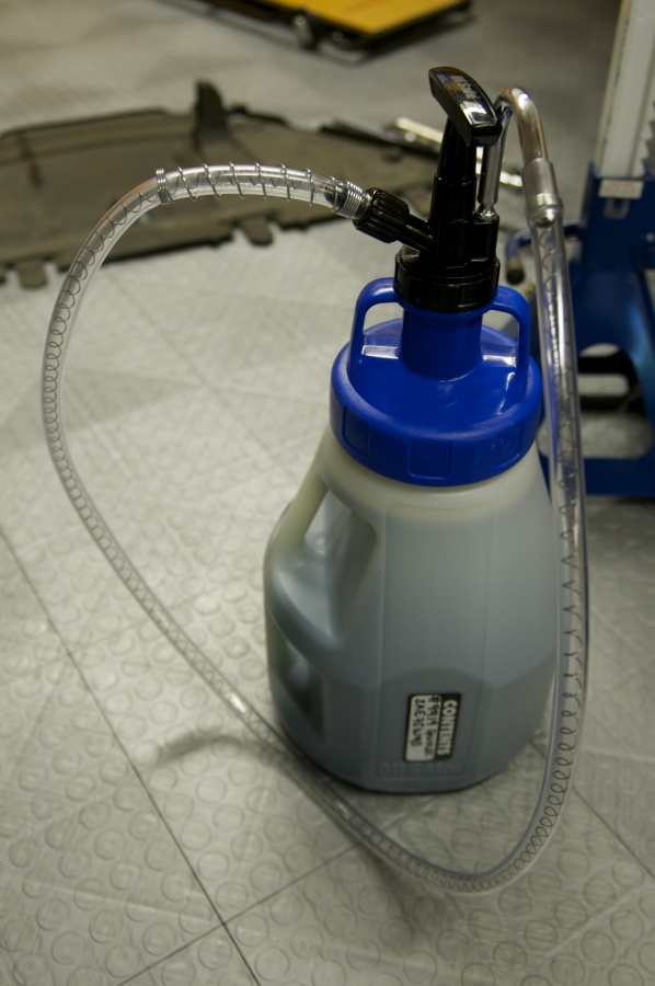

I had talked with Matt because my LSD felt like an off switch, he recommended to change gear oil once a year (I only street drive the car for now) so I went ahead and changed oil. Sure enough the oil was very dirty and with the new oil, the LSD was transformed again - smooth transitions from lock to unlock to lock.
I attached some photos of the oil container and oil pump I purchased, works like a dream!
very nice looking tool... where do you buy that? can you provide a link? thanks!

I bought the oil and containers from: Lubrication Engineering, talk to Charles Massey 817-834-6321. He and his oil was highly recommended from the previous owners of Guard, they have been in business for 56 years.
I love their oil, the shifting is super smooth and keeps the transmission oil temperature lower supposedly.
I bought:
75-90 weight oil, part #9919 5 Gallon container.
75-140 weight oil for my race car part #9920 5 Gallon container.
2 Oil save drums 10 Liters each for the different oil grades, 2 utility covers one in red and one in blue plus one pump.
