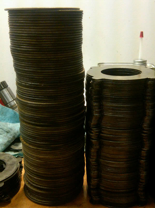

Hello 6speeders,
I was just doing some year end cleaning and organizing and came across these:
It made me want to just stop for a minute and thank everyone how has sent us their LSDs for service, and especially Mike for starting this thread, which is both a great service to the Porsche community, and as you can see has been good for my business. This is only about 6 months worth since I did a clean up over the Summer. But it gives you an idea of how many people have upgraded their LSD, largely as a result of this thread.
So, thank you to all of you and have a safe and happy New Year. Enjoy these cars, and remember to keep it on the track.
