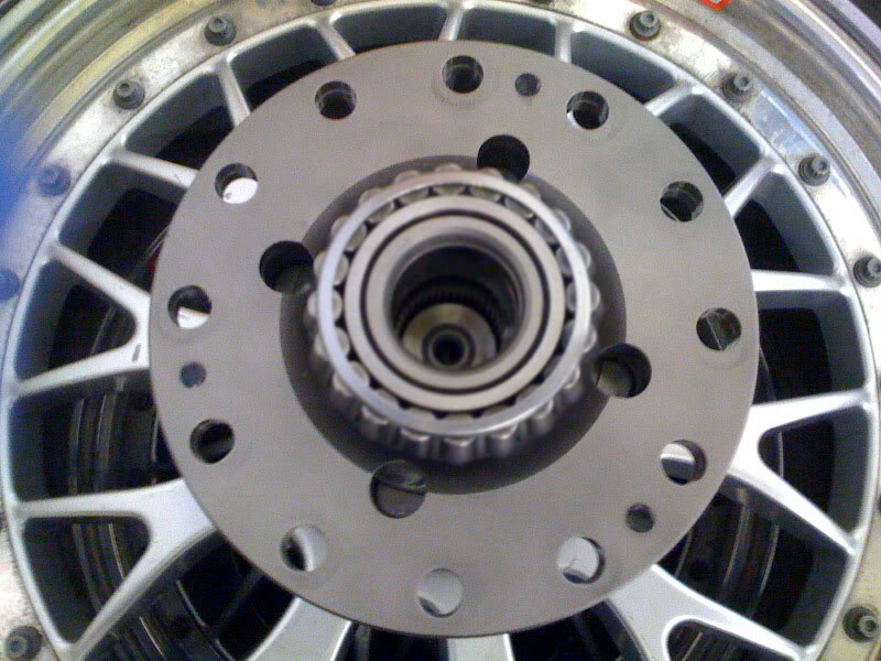

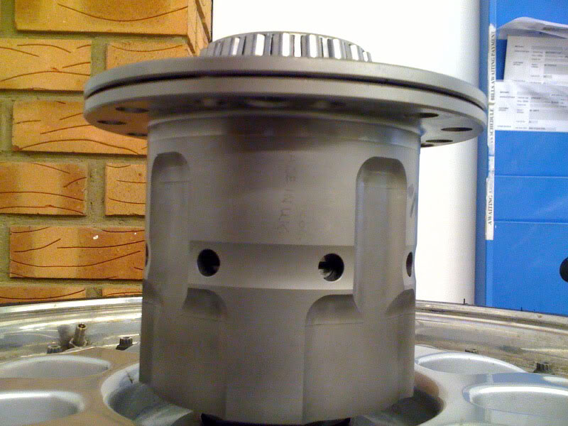

Matt got your email... will get back to you soon... inspecting 2nd gear anyway.

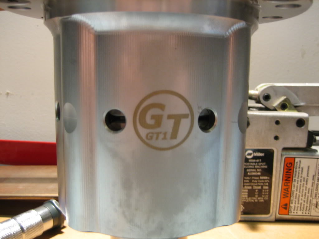

Well, since we're showing off...

both look a stunning bit of kit

LOL on showing off but your GT1 LSD looks mighty nice. Thanks for taking the time dissecting the question on preload and indication for LSD wear. It was easy to follow your explanation. I just wish I can get back on the track soon. I can only drive around the block so many times pretending I am on the track before I get bore out of my mind lol. Next event at Laguna is not till 2/1

I am really impressed with the new billet cup car LSD bodies. They really are gorgeous.
I know you had this apart. Any chance it's still open and you can snap a shot of the ramps? I would also be interested in the number that's stamped into the edge of one of the four "clover" fingers on the ramps. I'm curious if they changed the ramp angles again on the newest ones.
