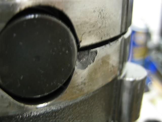

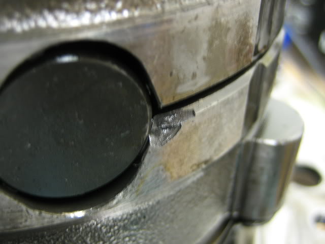

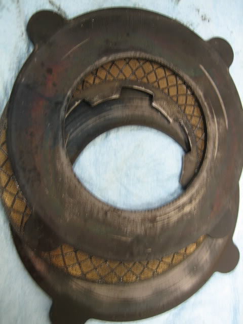

More update from Matt on the 2010 GT3's LSD rebuild as follow
So here's a few photos for your review:
See the chip? See the hairline crack on the upper side that suggests that one is about to break off as well? At first I thought it was some weird fluke. But it's on 3 of the 4 posts!!!

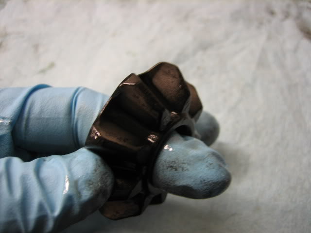

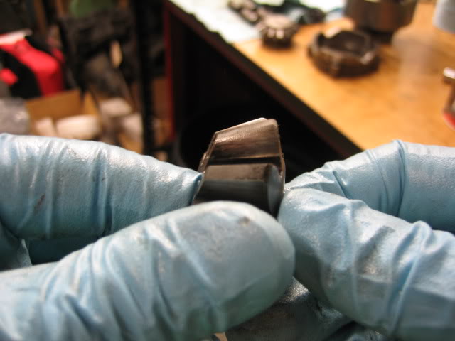

Also, here's what the gears look like. See the pitting? The crazy thing is that I have brand few OEM LSDs showing the same inconsistencies in the gears. The spider gears are going to be the next thing to go on these LSDs. And this is one thing that's no different on a motorsports LSD. The same gears are used.

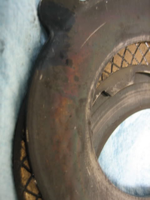

Lastly, I want to show you what happens when these get driven hard and are really done. While the mileage on this car is very low, this owner pretty much tracks the car and not a lot else. For reference, Mikymu's LSD had an internal gap of less than 1.6mm. That's pretty typical. I see them from a low of 1.3 or 1.4mm when brand new to around 2.0mm when worn out. This particular LSD had a 2.8mm gap!!!
And this is what happens with that gap. It gets hot. It gets really hot because the plates are just spinning in there and not biting on each other. This is what happens if you keep driving on it once it's worn out.

what da.... did somebody dropped that thing on the floor!?

If they did, it happened in the factory the LSD was manufactured in. There were no tool marks on neither the ring gear bolts nor the LSD cap screws that would suggest that the differential had ever been apart since the day it was first assembled.
LOL
They sure are awful looking for a crucial moving part in a track oriented Porsche

I had a 996 GT3 LSD through the shop yesterday and figured I would use that to show you the differences I am talking about with respect to the inner gears that are going in these LSDs. There's already posted a 997 GT3 spider gear above. Below is the 996 gear. You can see that they used to be billet and properly ground, like a gear should be.

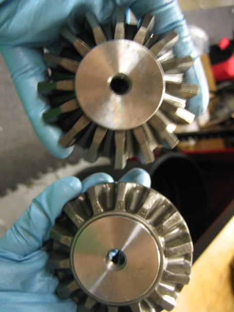

And here's the side gears, side by side. One is a used 996 gear and the other is a brand new 997 Cup side gear. In case it's not obvious, the lower gear is the 997.
The old style gears are definitely wearing better than the new cast gears they are using. I just put it out there because it's something you should consider for the future that you are going to need to service on these differentials. And it's not something that is resolved by upgrading to a Cup Car LSD. I've been getting asked a lot why someone should buy our $2700 LSD when they can get an 8 plate Cup Car LSD from Porsche for the same price. Well, this is the answer in pictures.
