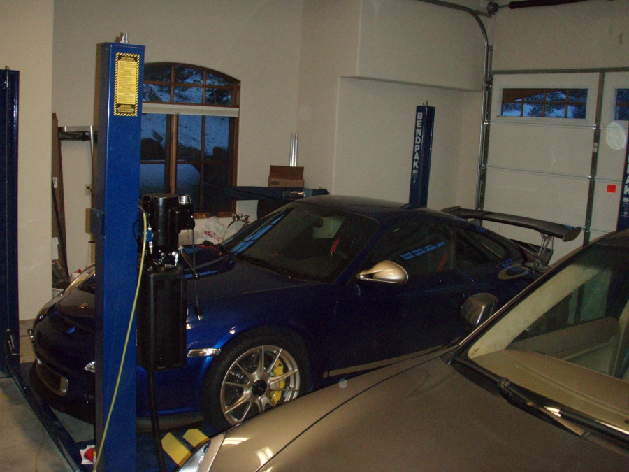

The Backyard Buddy is made here in Ohio, USA. IMO it is the best 4-post lift available.
For my application I use a 120VAC 2-post asymmetric lift. I am doing more "wheels off" stuff and even though that can be accommodated with a 4 post configuration it requires a bit more effort to achieve.
If you go 2-post (asymmetric or symmetric) I will share with you a few issues to consider so you can avoid the consequences of ignoring them.
First make certain the area you install the lift in has a floor that is level. This may seem obvious but not for the reason you may think. The levelness of the floor will not prevent you from installing a 2-post lift (just use shims unless the floor is grotesquely out of level). The problem is if the floor falls away to the entrance of the garage (as most do) the arms that lift the rear of the car will be higher than those in the front. If the grade is too steep from back to front you will probably need to drive the front wheels up on ramps so the rear arms can clear the bottom of the car (particularly if it is lowered like most track cars are). Avoid the need for ramps if at all possible because it makes it more complicated to position the car properly each time you lift it.
Second, make certain you know the minimum height of the lift's arms. Not all lifts have low profile arms. Go to your local P-car dealer and see what they use. My dealer uses BendPak lifts because their low profile arms are sufficiently low to lift sports cars.
Third, make certain you know the quality of the concrete of your garage floor. Most reputable lift manufacturers will spec the concrete required to safely support their lifts (not only the concrete mix but also the thickness). Don't assume that your residential garage floor will necessarily be able to meet the correct concrete spec and safely support the lift.
My garage was custom built to accommodate a 2-post lift. I wanted the floor to have a grade ample enough to drain liquid to the floor troughs built into the floor. Unfortunately the grade created the problem I described above that requires me to drive up onto ramps prior to lifting the car. We did properly spec the concrete and after nearly 4 years and hundreds of lift operations (we have 7 vehicles that I service routinely) we have had no degradation of the concrete to which the lift is mounted.
Good luck with your search. I have benefited from many of your posts and I know you will enjoy the utility that a good lift will bring to your workshop.

I just went down this road. Dave Shedlock, Workshop Depot, 1-877-533-7524 (Workshopdepot.com) was great to work with.
2 post requires bolt in and must have *at least* 4" thick concrete to anchor to.
4 post doesn't have to be anchored, but believe me you *WILL* want to anchor it.
4 post for storage and work. 2 post for work.
Use a professional installer who will also handle delivery. Don't even think about trying to receive the shipment unless you also have a forklift in your garage.
Install is a 2-3 man job.
110v/120v is available for custom spec (I did it). The drawback vs 220v is lift is slower to raise due to less motor rpm's. I am fine with my speed.
Some lifts need a compressed gas source to activate the safety catch releases. I use a quick disconnect fitting and my nitrogen bottle.
PS- I bought a WalMart scissor jack for $29. Can use jack stands either on the ramps themselves of if you buy the sliding jack tray option.
