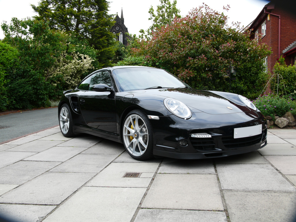

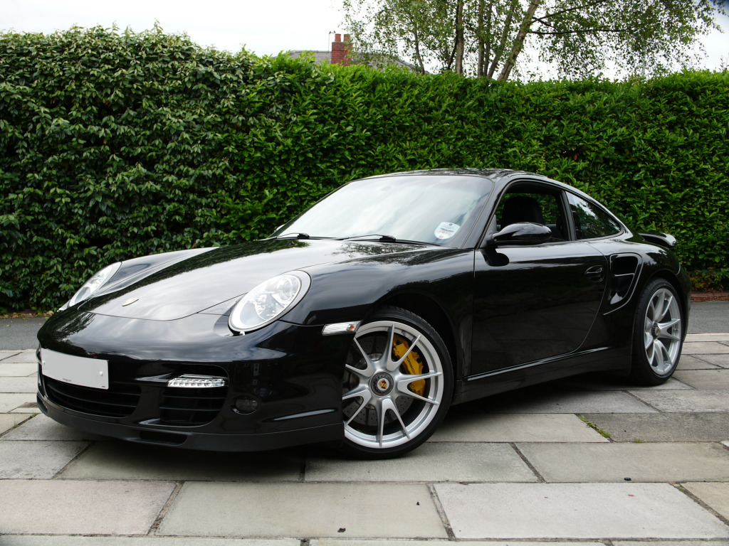

Thanks. Front wheels fit no problem. I had the conversion done at My local Porsche dealership and they never even commented that the wheels my be too wide. They do stick out a little, but only by about a quarter of an inch. You can't notice unless you stand at the front of the car and look right down at them with the steering dead centre. I have the standard tyres for the turbo on the wheels also (235s), not the wider RS fitment (245s)

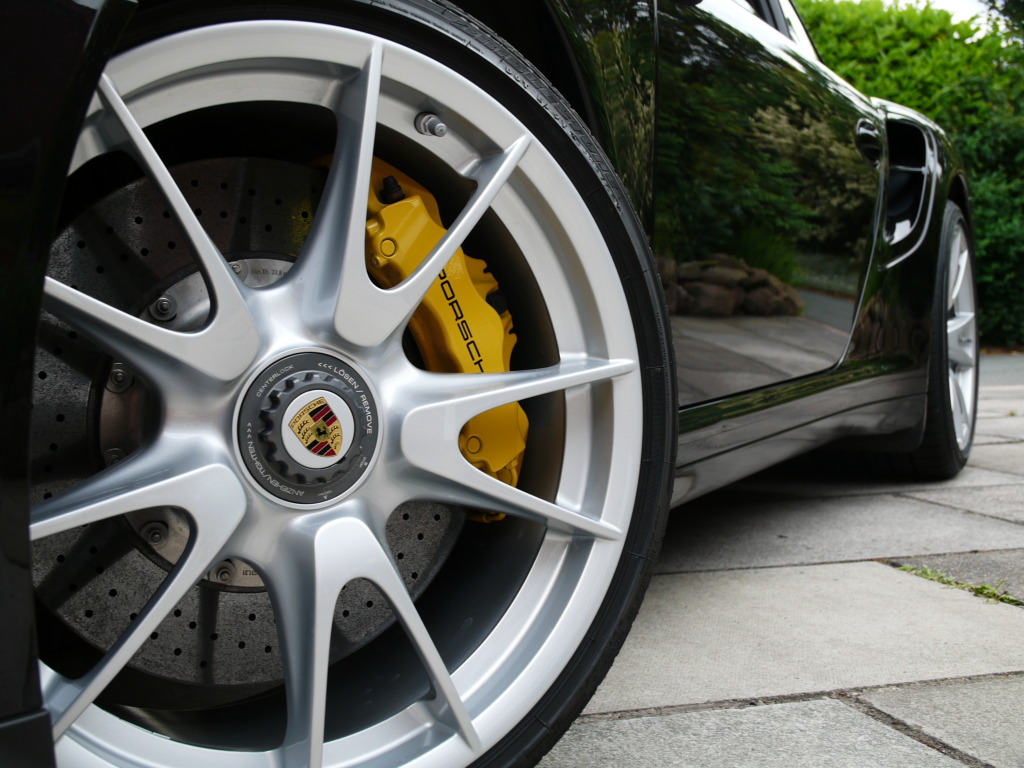

I fell in love with the wheels from the GT2RS. I tried to find a copy that used the five lug but I couldn't find one after months of searching. As far as I know one doesn't exist. And the more I looked at those wheels the more I wanted them. And then I read you could have this conversion. I researched it for months, and I know all about the issues that people have had, and the people who have converted their wheels back to five lug.
I did it purely to have those wheels, so it was just for looks. I have no desire nor need to change the wheel as I don't use the car in the winter. I do not track my car ever, so I didn't feel it was a problem for me as the affected cars have only been the ones that are used on track.
I know I'll get some abuse form people saying it was a bad idea but there have only been a handful of incidents with damage to cars from loose wheels and they have all been GT3RS cars on the track. And with the new equipment on the car and the bolts tightened to the proper torque and with proper maintenance, I should have no issues in the future. I also had an official Porsche dealership carry out the work so they can't say it was an improper job should any issues occur.

isysman - Your car looks amazing That last picture is stunning!

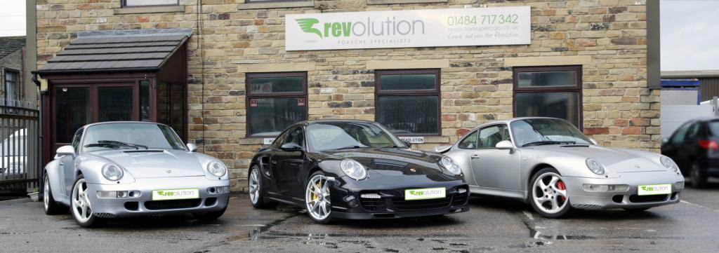

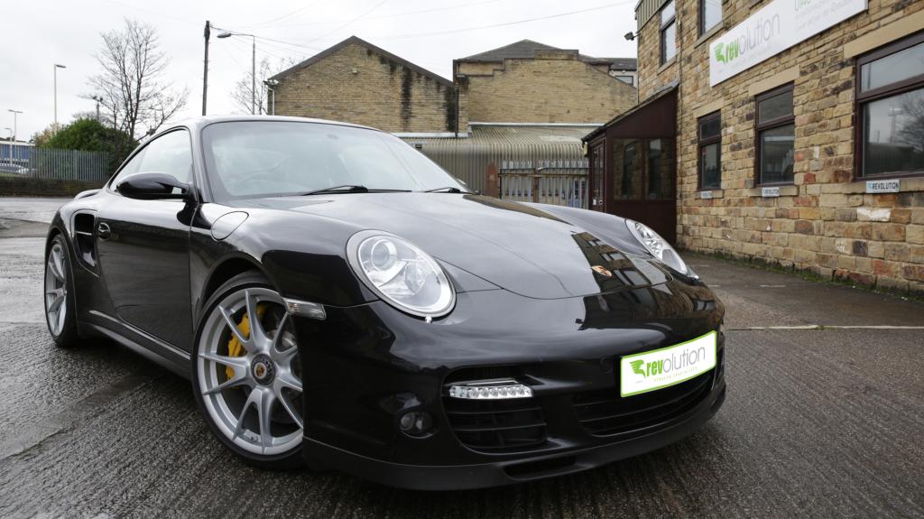

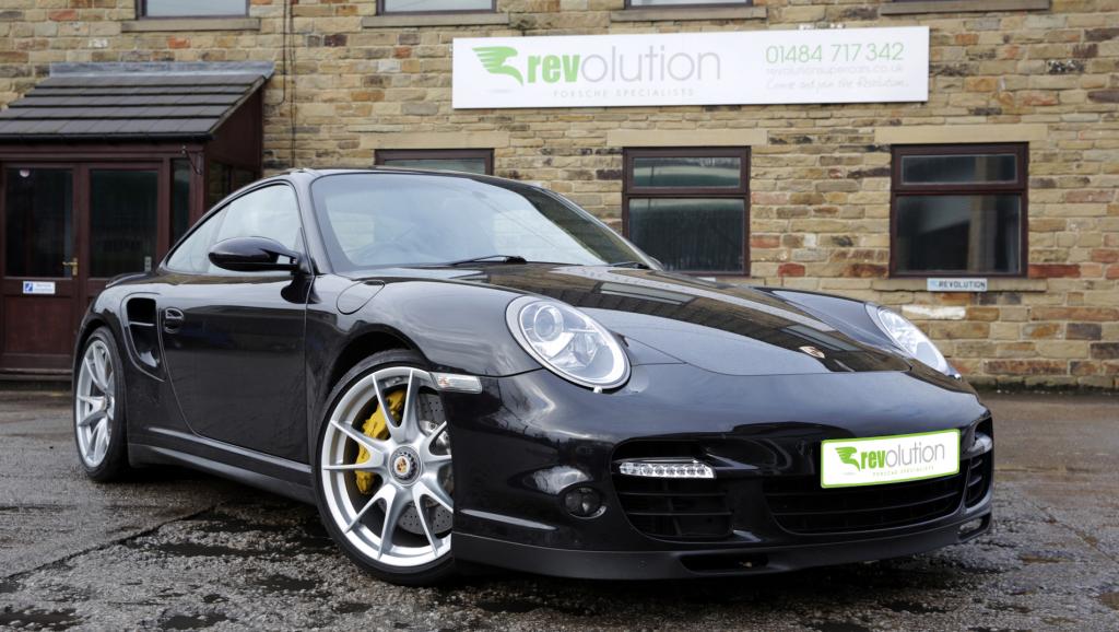

Just wanted to update this thread as I've just had my car lowered to complete the look at least as far as the wheels go. It is my intention to do a full GT2RS replica over the next year or two. It is a massive undertaking as everything is so expensive, but it's turning out to be a very rewarding experience. I'm also writing about my adventures in the Porsche Club Great Britain club magazine (the official Porsche club in the UK).
Anyway, I used the TechArt Lowering kit which consists of four springs only (no shocks) and they work with your original PASM dampers. The ride after the fitting is slightly more firm but not too much that the car has become uncomfortable. However it now handles much better in the corners and reminds me a little of the Carrera GT I drive on occasion.
The car sits approximately 15mm lower than stock. The kit says it will lower your car 20mm (0.7 inch) but if you have PASM fitted then it will be 15mm.

You definitely cannot argue with the finished look. That looks terrific!
