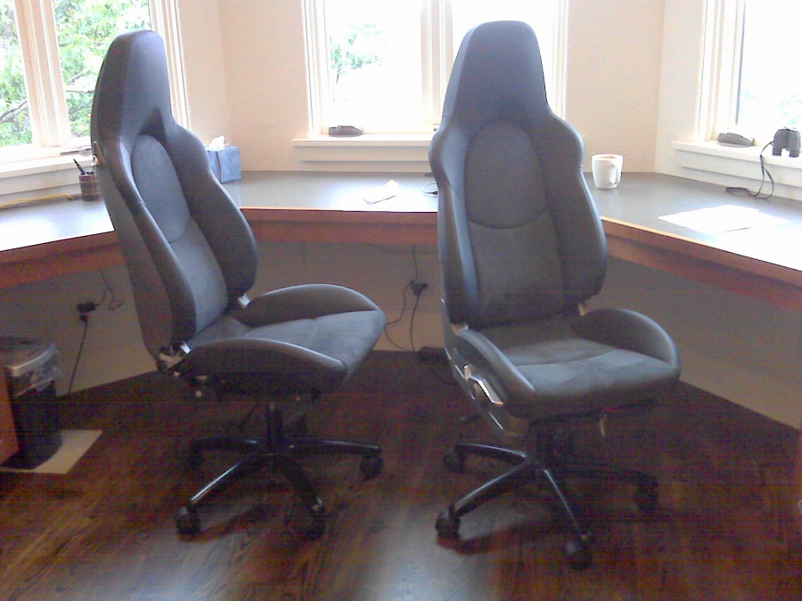

The seats are worth a little less than $2k and you can sell them on the forums. They go pretty fast. I would hang on to them in case you want to put the car back to stock when you sell. You may find they are impossible to find when you need them. Mine are doubling as office chairs at the moment. Mounting board and base and you are set. Brings a little of the garage into the house.

Originally Posted by Trollinger
...Mine are doubling as office chairs at the moment. Mounting board and base and you are set. Brings a little of the garage into the house.
Post up some pics of your custom office chairs Trollinger...

I knew the post was useless with out pics. I looked before posting, but I do not have any photos with me. I will post over the weekend. I can share where to get the base. http://www.swivel-chair-parts.com/kitsAll.html

Not the best picture, but you get the idea. I think they turned out really well, add to the room, and are very comfy. You can sit in them all day and not get tired. With a 12v battery (or charger) the seatbacks recline as well.
