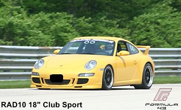

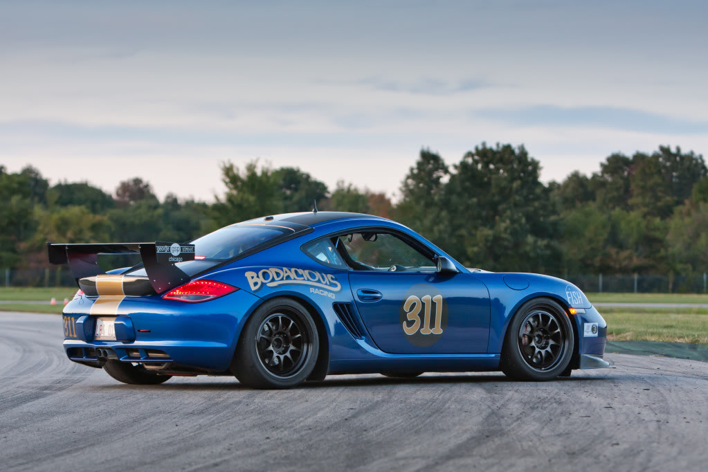

Formula 43 offers a couple of different fitment options for the 996 GT3:
Front: 8.5X18 or 9.0X18
Rear: 11.0X18 or 12.0X18
Our RAD10 Club Sport Wheels are a great choice for track use.
-Radial 10 spoke design features a rotary forged center section and our exclusive German "Spin-Form" AL6061-T6 rim halves. This combination gives you excellent stiffness both in the center section and rims for increase steering response, light weight and quicker moment of inertia.
We can build either fitment option with black or clear anodized centers and also can build a black anodized whole wheel if you prefer.
