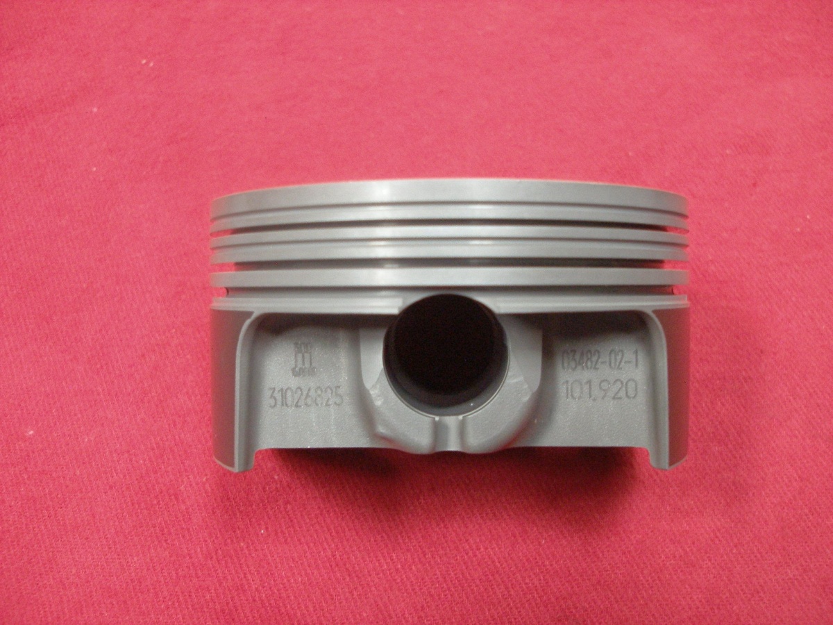

What ring package do those pistons have greekm3?
Thickness of:
1st ring ?
2nd ring ?
3rd ring ?
What is the stroke on your crank now and what is the rod length?
Thickness of:
1st ring ?
2nd ring ?
3rd ring ?
Hi,
crank is: Kurbelwelle 76,4 mm GT3 RS with part no 997 102 021 8 B MD 76,4
rods lenght is 130mm
I dont know the thickness of the rings
Do you know from where can i buy pankl rods?
