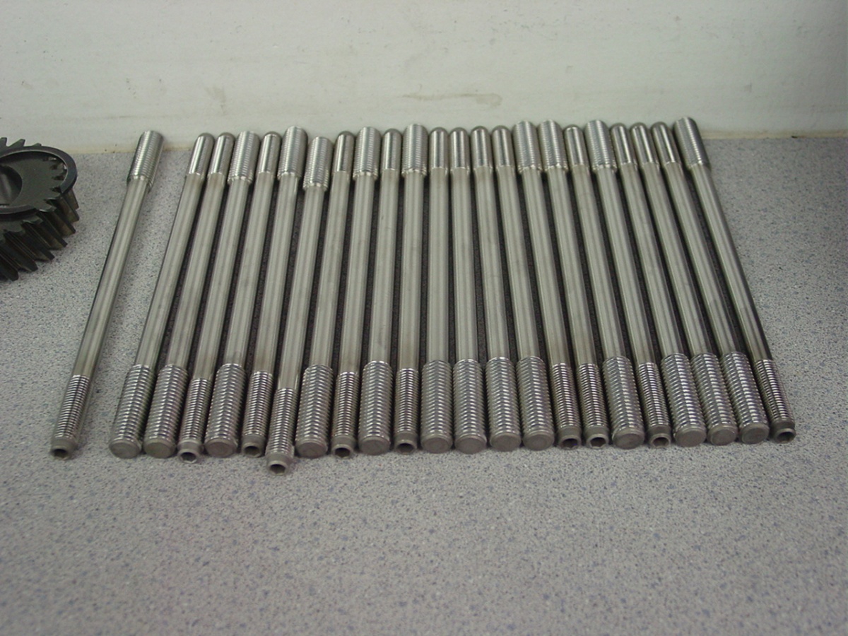

I note in the Champion 4.2L project 40mm studs were used instead of the stock length 25mm
I assume that this involved deeper tapping of the blocks to accomodate
What length studs are being proposed here?

Originally Posted by modoz
Hi Adamson
Once again thanks to you for the great footwork in putting this together
It looks like we are really getting down to the business end of this project
regards
Mike
Mike to your question about the studs here's a pic.
The OEM stud is 10 mm thick in the body and on the threaded ends are 8 mm thick. They are threaded in 25 mm.
The above studs utilized are 10 mm thick in the body and on the threaded ends are 12 mm thick. They thread in 40 mm deep.
Just a small component of this bulletproof build.
