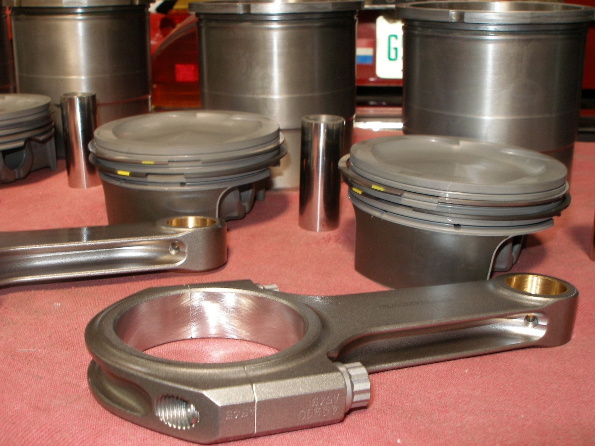

102mm pistons?

Originally Posted by ADAMNSONS
102mm pistons?
that is pistons before install..
