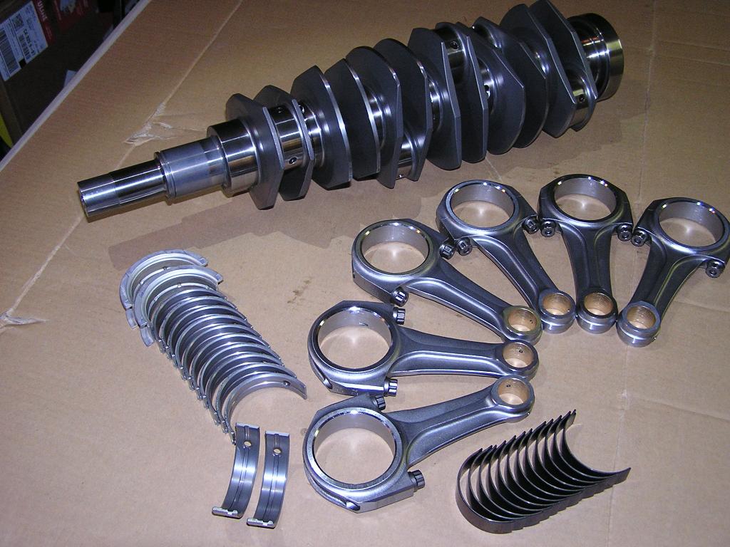

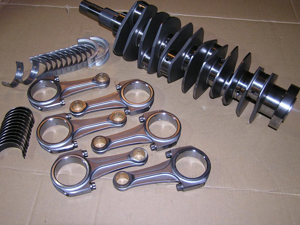

Here are some pics of the Crank and Rods together. Pistons will be JE FSRs. Different compression ratios will be available; you pick what you want. Thinking 9.4-9.5 will be ideal for the turbos, unless you plan on running a crazy amount of boost. Keeping the compression will help with off boost power and spool up!
NA, GT2 applications will vary from 11.5 to 12.5 to 1. If you decide you want more, you will have more. I won't have photos for the pistons because they will be different depending on Turbo vs NA and different for different compression ratios. I will have some more info on the pistons shortly.
I also got metal head gaskets that will be made custom to the bore size, and thickness you will choose. Trying to get the pistons figured out in a way that you can pick up some compression for those of you with GT3s by using different head gasket thicknesses. There will be a limit of course because you don't want to run too thick of a gasket and mess up things like quench area, etc. I don't know too much about that but I know it can hurt the combustion by running too thick of a head gasket. I will try and find the technical info on that. I think it will be great to give you the opportunity to adjust your compression up or down 1/2 a point by using different thicknesses.
The Rod and Main bearings will be included. They will be modified bearings to work with the specific, Crank, Rod combination; things like enlarged oiling holes. They can be coated as well for an additional $225. Clevite Rod bearings, and Porsche main bearings, as seen in the photos.
Whose rods are those?

Quote:
Brian makes some awesome rods
Also available in Titanium but at an additional 5K
Nice Originally Posted by ADAMNSONS
PAUTER MACHINEBrian makes some awesome rods
Don't think I could justify the extra 5k to go titanium though. They should be more than enough as are if made by Pauter.
