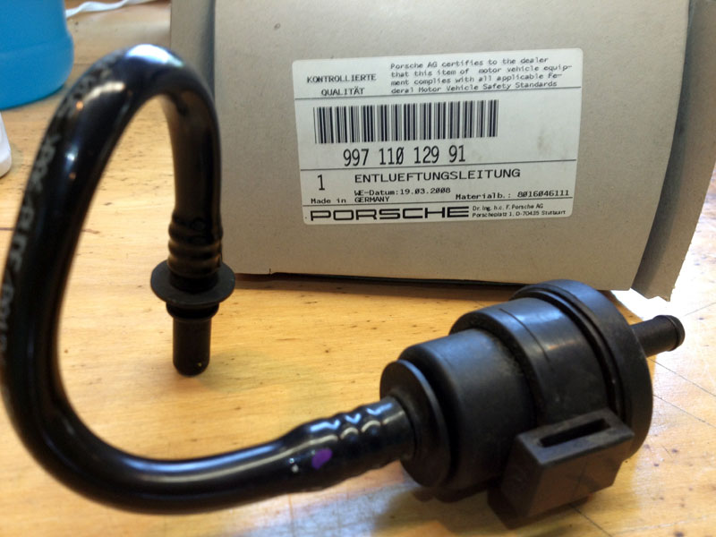

Since I bought the car a couple of codes have popped up intermittently triggering a CEL.
P0455 Tank system - major leak
P0461 Fuel level sensor
I originally replaced the gas cap as was the common "fix" for this CEL to no avail.
Symptoms are:
  1. When refueling, gas will pour out of the port when full, not shutting off the gas pump.
  2. CEL will trigger when fuel level gets < = 1/4 tank
  3. Clear the CEL with durametric and refuel; repeat #2
I finally brought the car to the dealer to diagnose and for $150 they told me it was a $400 EVAP part that was $300 to install. I paid for the diagnosis and the part and installed it myself in 10 minutes.

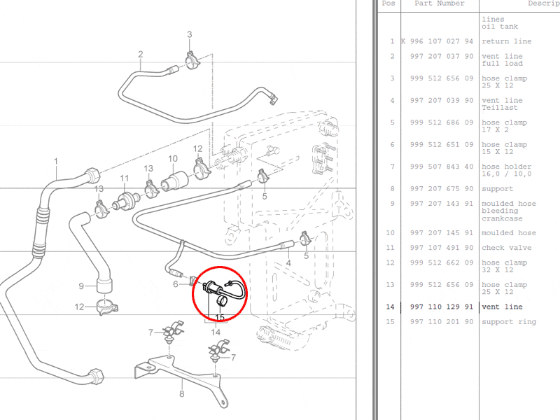

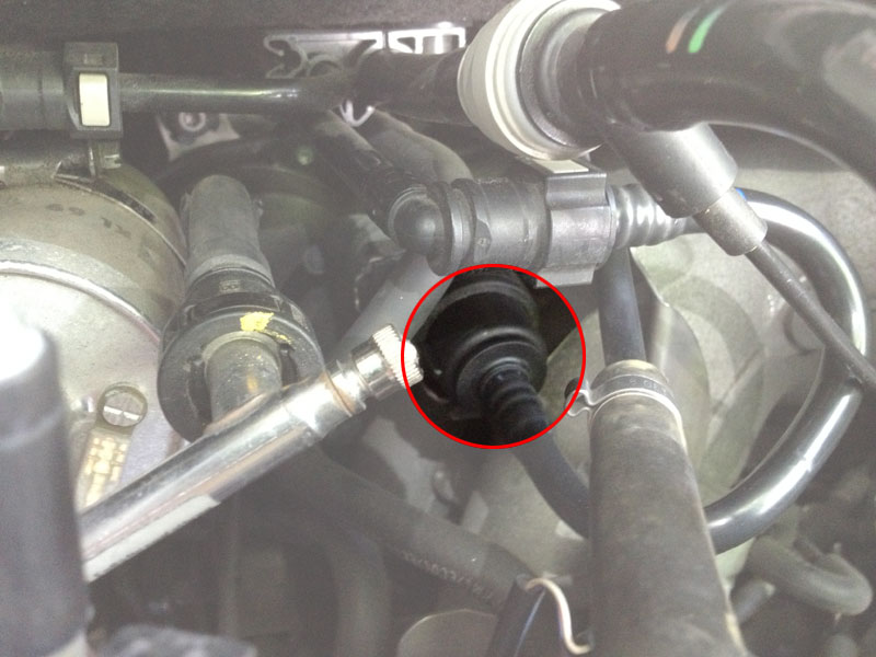

Location is on the drivers side of the engine compartment. Follow the lines coming off of the oil tank:
Part number 997 110 129 91:
Location was not fun, but not $300 painful either.
Hopefully this fixed it. I'm a bit bent out of shape about the labor estimate - two hours is way overboard. Can anyone recommend a good p-car shop in the metro west, MA area?
