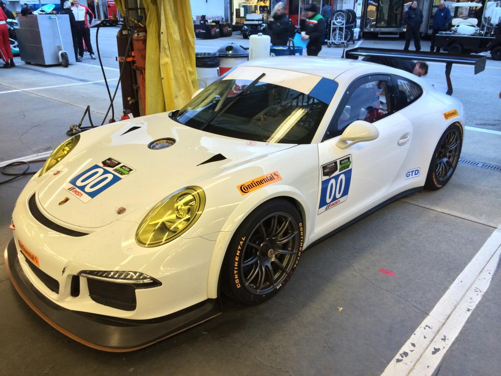

Just to clarify, the wheels RedRSA priced are not our standard wheel, they have the Ultralight and Ultralight-Pro options (approx 8.5 hrs of additional machining per wheel). Without these options we are at $3640/set.
Wheels with the Ultralight and Ultralight-Pro options:

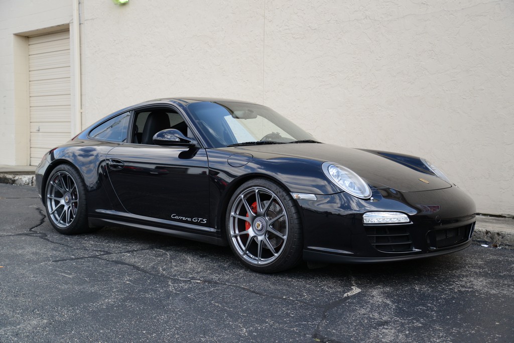

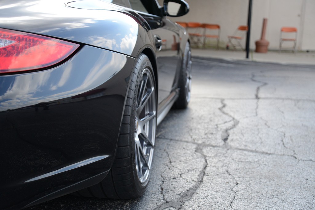

I have bee using ForgeLine wheels for years with multiple sets. I currently have the GA1R on my 2011 GTS. The fit is perfect and they are not hard to clean. I just purchased a 2010 GT3 and will order a set of GA1Rs for it as well.
