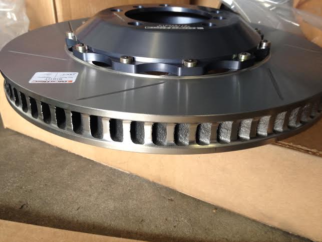

Girodisc floating 2 piece 380mm 72 vane fronts and 350mm 48 vane rears. Fronts weight 23.8lbs and rears 16.5lbs. Great set up when used with PFC 08s. The complete set of front/rear 380/350 Giros will run you under $2800. I have a brand new set if you need one..
Stick with the OEM Brembo calipers. You won't find anything better in the aftermarket. PFCs are fantastic track pads that work reasonably well on the street also.
