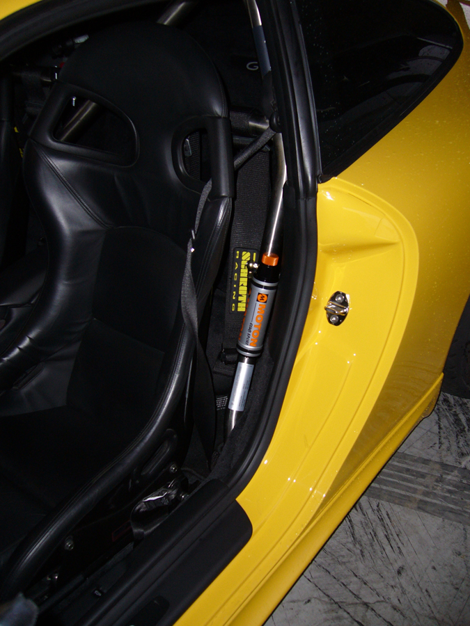

What a change know I have to re learn the car again. Un real. After some runs the car was very twichy but some changes on the Mototns and BAM!!! the car is on rails. Know I need to get use to the ability going faster on the TURNS

Congrads on your Motons. I too just installed a set last week, it is like night and day. Since I have not had the chance to dial-in care to share what settings you did to put on "rails"?
What main spring rates did you decide on for front and rear? I drive mostly on street and plan on tracking some. The ride is stiff but very compliant.

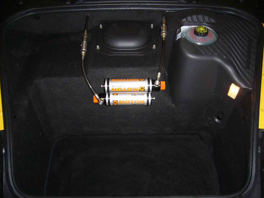

500 lb front 700 lb springs back as and 150lb on the small spirngs
as for clicks on canesters 4 ( going from - to + ) 3 on rebound front and 3 and 2 on the rear. I also change the Sway bars to full soft rear and one up from full soft on front

Nice set up on the external cans. Thanks for sharing your setting info. Your ride quality still must be nice and only slightly stiffer than stock.

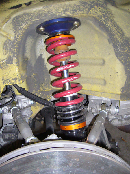

Up date I just drove the car today out side the track and man what a diference. I was riding on full monoballs and the car car was very stiff and you could feel every bump. Know you can feel every thing but at the same time is Rough but diferent hard to explain. love it . Before I would take the car out to goof arround town but will think about the pain in my back after driving arround, know it just feels right Here are some more pics. Also I notice that the fron Spring is not a 500LB but a 600lb soup date data
600lb and 150 comression spring front
700 LB and 150 copmression spring rear
